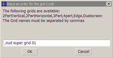

i don't seem to be able to do anything that stops the right mouse click messing things up.
i browse to the .grid file i've made - which is in the 'gridmove' folder i'm running 'gridmove' from.
and then i have this in the grid cycle config box...
everything works okay until i accidently right click whilst in the grid view mode - then i have to reload the .grid file back in because nothing works at all.
it doesn't seem to make any difference whether there is anything in the grid cycle config box.
any ideas?
Re: IDEA: drag window to edge automatically resizes it
« Reply #167 on: July 28, 2006, 09:45 AM »
There might be a bug there, i need to look into it.
Nevertheless, if you write:
nud super grid 01.grid,
It works (notice the comma at the end and not in the beggining. that's where the bug is).

« Reply #169 on: July 28, 2006, 08:17 PM »
hehe, thanks. it does indeed work. time to make another .grid file...
