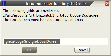

1) I am having trouble with template cycling.  I created two templates, and placed them in the cycle order, but when I right click to cycle to the next one nothing happens.  The grid goes away, and it seems like gridmove deactivates.  If I then go into the template list, nothing is checked (which explains why nothing happens).
I assumed this feature would cycle between all listed templates with each right click (and roll around). Note that both templates work if checked individually.
2) The help for that dialog (template cycling) refers to a specific list of templates that are available.  Does this mean only these can be cycled?
3) Why do the items in the list have a comma before and after the list?
The thing is: there are 2 representations of grids: the initial (which sucks, and is hardcoded in the code and i still wasn't able to remove), and the ones in .grid files. On that dialog's default configuration, there's no example of how to include the former.
You have to do like i have in the folowing screenshot:
This means: place your custom grid on the Grids folder and then refer to it on that dialog as:
Grids/NAMEOFGRID.grid
Well... That's sort of a workaround to get the thing to work. You don't have to worry about them, though. The first comma and the last don't need to be there. They'll reappear when you get back to that dialog, though. Just don't worry about them, it's an explicit example of how i suck at coding :P
