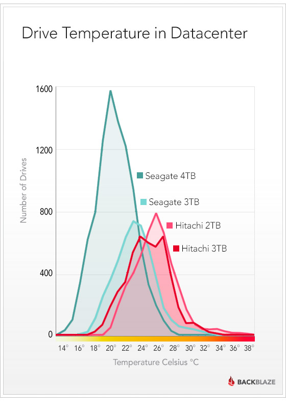

Backblaze has a new report that shows absolutely no correlation between drive temperature and failure, based on  data they collected from 34,000 hard drives.
In other words, keeping drives cool does nothing to keep them running longer.

No correlation with heat? Now that is really interesting...
I wonder, however, if there's a missing factor at work since Backblaze is operating in a climate-controlled data center environment with what I'd suspect is cleaner and better regulated power.
Are the ambient heat levels or fluctuations similar to those experienced in a less controlled environment? I'm wondering if they've engineered an environment such that heat doesn't factor significantly in drive failure - which might suggest it's not just heat, but heat plus an additional factor  - or factors.
Yup. This is getting real interesting.
Re: How long do hard drives actually live for?
« Reply #54 on: May 21, 2014, 01:08 AM »
ding ding ding! i think we have a winner.
look at the chart on that page:
and we have this comment: " And almost all of the drives are in the nice comfortable range from 15˚ to 30˚."
SO.. it looks like the lesson is, IF YOUR DRIVES ARE ALWAYS RUNNING RELATIVELY COOL, trying to run them cooler won't improve reliability.
But this doesn't at all address the danger of running drives at warm temperature ranges like above 36 degrees or so.
So... Since my drives are running currently at 36,37,32 with no load and in mild weather, and i used to regularly see drive temps of 45 or more, it seems my paranoia of watching my drive temperatures are still warranted.

I'm no expert here but unless it's extreme I suspect temperature isn't necessarily a good measure.
obviously it needs to be monitored but I was always of the understanding that it was the hot/cold cycle that does the damage, so using a data centre where everything runs at a pretty steady rate 24/7 isn't going to give you a good comparison (unless perhaps you're looking to build a data centre ;D)
And while there are going to be natural variations between components (see the graph in the previous post) I would assume a higher but steady temp in a stable system was 'acceptable' unless it was extreme.  Sudden spikes or significant increases over time would be cause for concern, otherwise...
Nice obvservation!  So there's a data point that in favor of keeping drive temperatures between 14 and 38 C -- so if it's too hot for us, perhaps it's too hot for them?
