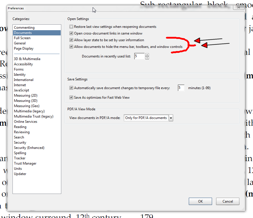

I mainly work with PDF's from one or two sources so dont have to deal with this problem much.
Have you tried these two options in preferences? this from "X" (version 10.1.5)

Thank you very much, Tomos.
In fact, my 4 above settings are as yours, so these don't have any effect on the problem. I should add two things:
hi evamaria, I wasnt very clear there :)
I wasnt actually recommending my settings, I was wondering if unticking those settings, in particular [Allow documents etc etc] would help any.

Thank you very much again, Tomos, that was dumb of me! (I just checked that they were yours, without taking any further interest in them, or really read them to begin with!)
In fact, deselecting the two settings solves my problems partly, I now have the menus displayed in every case (I hope, and except when the pdfs are displayed directly in my browser, I fear, meaning before downloading them in order to just be able to read them properly!!!), and it's always in maximized window, so that's a real step forward, thank you very much again!
