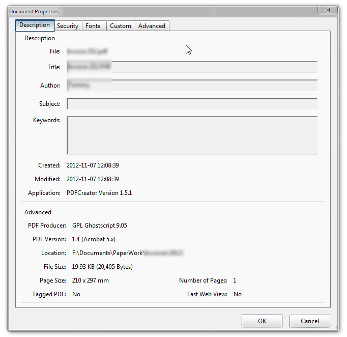

IIUC the next step in the script is to copy the file path from properties -
this seems to be not possible with adobe -
see the file properties dialogue:
the tab 'Description' has focus - but I dont see anyway of copying the file path cause it isn't shown in one string anywhere in the properties...
Re: [DONE] lightweight pdf viewer and editor
« Reply #10 on: November 07, 2012, 03:41 PM »
Location:  F:\Documents\Paperwork\unreadable-name.pdf perhaps?  :tellme:

Try this tomos (I have tested it in Acrobat but not Acrobat Reader)
Code
#IfWinActive, ahk_class AcrobatSDIWindow
F12::
send ^d  ;open file properties
winwaitactive, Document Properties
ControlGetText, xname, Static2, Document Properties
ControlGetText, xpath, Static18, Document Properties
send {esc}
ifexist %xpath%%xname%
 run [full path to pdf-xchange here] "%xpath%%xname%"
return
#IfWinActive
If it doesn't work, open Document Properties in Acrobat Reader and also open AU3_Spy that comes with Autohotkey. Hold the mouse over the filename in the properties window and check the ClassNN value in AU3_Spy. Replace Static2 above with that value. Repeat for the file path part of the properties window.
« Reply #13 on: November 07, 2012, 10:17 PM »
Works out of the box :-*
many thanks Nod5 :Thmbsup:
