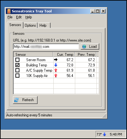

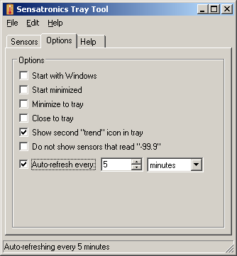

Many thanks to LEDAdd1ct for working closely with me on this.  There are still a few bits and bobs to add but I think it's ready for a public release.  Granted, the audience for this will be limited to folks with Sensatronics sensor units and, after checking prices on their website, they are not cheap.  I think the app turned out well.  Here are some screenshots:
Website | Download

The build turned out very, very nicely:
-it's tiny
-it uses barely any memory
-it fits neatly in the system tray
-it offers an optional trend indicator
-it changes color at the upper and lower extremes
-it doesn't write to the registry (completely portable)

Hi,
Found this whilst looking for setup info on a sensatronics E4 I've acquired... Now that I've managed to get the probe working, this app seems perfect for keeping an eye on things.
I've set the web page to show temps in Celsius, however the app seems to only show Fahrenheit - I'd like to change the reported temperatures to Celsius if possible rather than Fahrenheit, I couldn't see a way of doing so in the app.
Is this possible? Is the source code available for me to have a go at modifying it myself?

Hi, schiznik, and welcome to DonationCoder.    :)
Almost three years to the day from the last release.   :D
Website | Download
v1.0.4 - 2015-01-22
    + Added option to use Celsius.  (Thanks, schiznik)

wow that was quick!
Seems to be working almost perfectly - the temp initially loads as Fahrenheit but the changes to Celsius after pressing refresh.
    • Superboy Coder
Re: IDEA: Simple Sensatronics Tray Tool...
« Reply #22 on: January 23, 2015, 01:06 PM »
Please verify the bus is fixed in this version:
Website | Download
v1.0.5 - 2015-01-23
    ! Celsius temps didn't display properly until the first refresh.
      (Thanks, schiznik)
