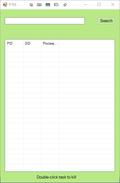

Ha!  Spent 90 mins trying to get the output from Get-WmiObject into a ListView ... and gave up :-[
I was going for something using a GUI, still haven't quite worked out getting arrays into a ListView yet.

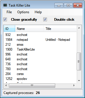

Here's a standard GUI program based on this idea (using the same exclusion list):
For single-program termination: fire it up, kill a program, done :)
(Can also refresh list via File/New)
DCmembers download: https://www.dcmembers.com/publicdomainvic/download/task-killer-lite-v0-1-0/
GitHub sources: https://github.com/publicdomain/task-killer-lite
Task Killer Lite thread: https://www.donationcoder.com/forum/index.php?topic=51088.0
Cheers!
