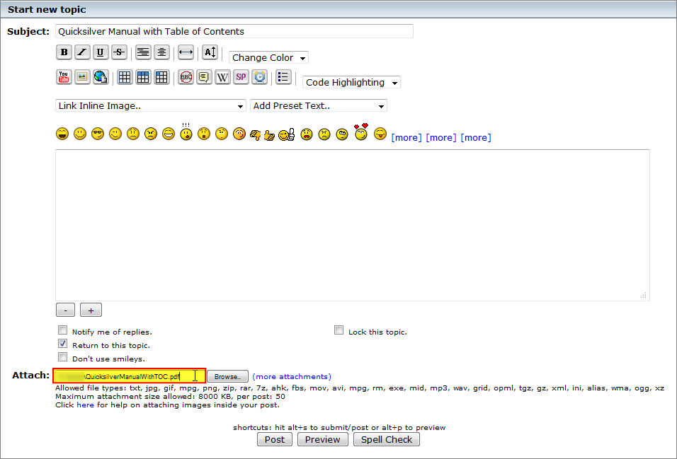

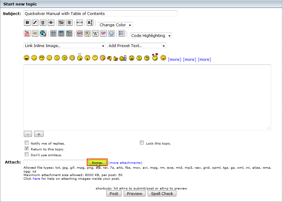

Not sure how to upload an attachment to donationcode.
May be this will help:
1. Press the Browse button
2. Locate an appropriate file via the resulting dialog
3. Verify the path to the file
Note there are restrictions via file extensions and file size but I usually don't find this to be a problem -- these are listed in text below the Browse button.
For other attachment capabilities, may be the following will help:
