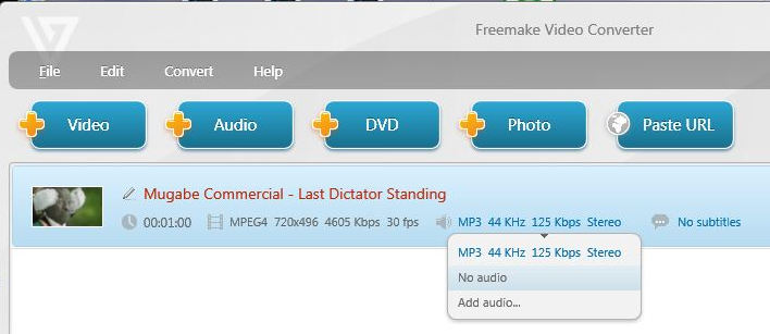

So I now have something starting to be usable.  I need to kill the sound, though.  This is going to be embedded on a Web page, so it needs to autostart, autoloop, and be quiet.  The autostart and autoloop will, presumably, be handled by the player, but I don't know about the sound.  So I prolly need to strip that before loading on the page, right?
As time allows, I'll check that plethora of links and suggestions, see if one (1) of them will strip the sound.  The video is about four (4) seconds of a boat under sail, and the wind noise is atrocious.  There are two (2) short video segments that will be shown, one a view forward along the port side that shows swells, pitch, and bow wake.  The other is a shot inside the cabin which shows water running from a faucet at about a twenty degree angle - the captain used that to estimate boat heel.  The full video will be offered as a link, but the short segments will be, hopefully, looping on each side of the page in 160x120 pixel windows.  Looks, though, that I'll need to re-sync the audio on the linked video - it seems just a hair off, a quarter of a second or so  :huh:.
In Freemake, click the audio info for the file and choose 'No Audio' - oddly enough, the output will have no audio :)

« Reply #16 on: December 28, 2011, 03:47 AM »
Good to know, thanks.  I'm still exploring Freemake, but I've got a bunch of stuff going - you might say my attention is somewhat diluted at the moment  :o :( :P.
