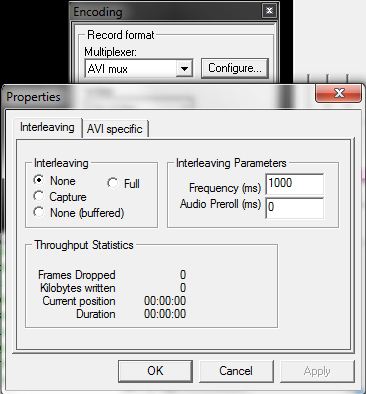

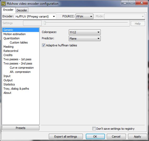

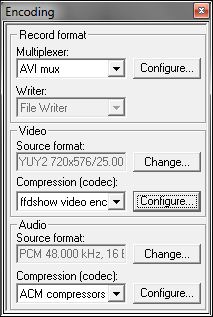

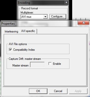

I'm not saying it'll work for you but since I tried capturing analogue video the same way using each different program, (eg. close extraneous programs, turn off W7 Aero when using Win7, don't play games - really hard not to do when the machine is sitting there 'idle' :) , turn off screensaver, etc), it was the only program that just happily recorded everything without me having to fool around in Vegas re-syncing the audio/video.  Most recordings I did were under XP it should be noted but the same applies.
Default sync settings as follows:
Normally capture to HuffyYUV encoding, (ffdshow), and 48kHz PCM stereo - CPU has minimal work to do.
About the only trouble I have is making sure I have the correct audio input selected and I was actually plugged into the input I thought I was.
iuVCS can also get a little cranky if you try to start a second recording after finishing the first, not a problem for me - I just restart the program.  iuVCS is still technically beta software, I have to say that while it's layout is fine, finding the right area which contains the setting I want can be a little confusing at times.
While I understand why I could get sync problems using the setup I do, (separate capture card and audio input, ergo different signal paths), I have wondered why the USB devices can suffer from sync problems since both signals are digitised in the same blackbox and sent over the USB cable to be encoded.  Unless there is some inherent delay in the hardware they use or the drivers - why is it so?
