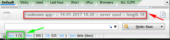

I've noticed something. Please refer to the attached screenshot. Whenever I copy a selection, the Red part would flash but the clip does not appear in the list. However, the New count in the Green part would increase as well. It's just that the clip does not show up in the list at all.

Ok. Finally got it to work. The problem seems to be the Ditto database I imported into Echo. With the imported database in use, any new clips I capture in say, Firefox, DOES NOT show up in 'Default' or 'ALL CLIPS' tab but only in 'Browsers' tab. However, if I start off with a fresh Echo installation without importing any Ditto database, then any clip I capture in Firefox will show up in all three tabs, ie., 'Default', 'Browsers' and 'ALL CLIPS'.
Perhaps Merak would be able to resolve this bug(?) when he gets around to it.
