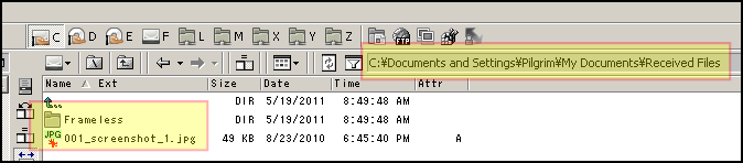

I have spent an hour trying a variety of settings with the following results:
Actual batch file in use:
C:\Documents and Settings\Pilgrim\My Documents\Received Files\Frameless\Frameless.exe
"C:\Documents and Settings\Pilgrim\My Documents\Received Files\001_screenshot_1.jpg" 100 100
This will open the image in whatever viewer is set as the default (tried several), it also opens the image in the default position of whatever viewer it opens, i.e. First Impression opens in the centre of the screen regardless of the coordinates in the file.
If I set Frameless as the default viewer the image always opens top left.
When I tested this yesterday I left out the position settings as I was short of time so it defaulted to that position anyway but I have since tried adding them and no matter what they are it makes no difference to the image.

The way it is shown in my previous post there is just a single space after the first line as it would be if it was all on one line.
When I opened Notepad full screen it put 'Files\001_screenshot_1.jpg" 100 100' on the second line.
If I open Notepad to the size I normally use it at I finish up with this:
"C:\Documents and
Settings\Pilgrim\My
Documents\Received
Files\Frameless\Frameless.exe"
"C:\Documents and
Settings\Pilgrim\My
Documents\Received
100
If I save the file using either of these options it will not run at all.
I even copied and pasted the command from your last post and that would not run.
I have experienced this with other batch files I have created and the only way out that I have found if they do not run is to check the spaces at the end of each line.
Forgive my lack of knowledge but I have a question:
If I double click on Frameless.exe it opens an information window.
If I remove the second part of the command from the batch file should that not do the same?
Because if I run the batch file without the image path the command window flashes on and off and nothing else happens.
I have just tried this with two other image viewers and they both opened the program window?

« Reply #17 on: May 19, 2011, 02:42 PM »
Problem Solved!
After reading your last post I went right back to the beginning and started again.
I moved the program file and the image to a different folder and put them together.
I deleted the batch file and it's shortcut, rewrote the first and recreated the second.
Everything works!
I have no idea which part of that changed things and I can only apologise for what must have been my mistake although I am not aware of having done anything different from the first time.
Frameless does exactly what I wanted in a simple straightforward manner, thank you.

    • Superboy Coder
Re: DONE: Open images without program window showing.
« Reply #18 on: May 19, 2011, 06:20 PM »
Frameless[/b] does exactly what I wanted in a simple straightforward manner, thank you.
This is the second time you have helped me and it is much appreciated.
No need to apologise and you're very welcome.  I'm happy to be able to help out.  I've decided to pretty this up a bit and release it on my main site.  Bear in mind that I did change up the commandline syntax a little bit so I hope you haven't gotten too far into your batch files.  I also made the taskbar button an option as well.  Please check the readme.txt for details.
Website | Download
v1.0.1 - 2011-05-19
   + Website release.
   * Changed the parameter syntax.
v1.0.0 - 2011-05-18
   + Initial forum builds.
« Last Edit: May 19, 2011, 06:22 PM by skwire »
