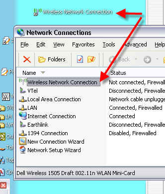

Drag the connection to the desktop
AndyM
  • Posts: 616
from the Network Connections Folder
I don't have WiFi on my desktop... but ncpa.cpl opens the network connections folder. It's possible if you do a search of the Windows folder for *.cpl you might get closer (find a better match) to your target.

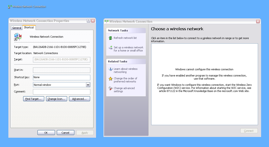

Andy, Carol...your suggestion only opens up the Connection Status window.  From there, you still have to press the 'View Wireless Networks" button.  It's better, but not really what I was asking for.
Stoic, your suggestion doesn't really work either, nor does anything on that link.  but I think you're right, there must be some cpl file that does this.  Seriously, what is the command that opens up that window?  It's there somewhere, I know it is...

What you posted:
RunDll32.exe shell32.dll,Control_RunDLL NetSetup.cpl,@0,WNSW
gets me the same dialog as the "Wireless Network Connection" icon in the Network Connections folder. (Edit:  No it doesn't, my mistake). So you could use the RunDll line and then have the script select the "View Wireless Connections" button.
If you find the right parameter then you'll be able to get there right from a plain vanilla shortcut.
But the Wireless Network Connection shortcut does get me to here in one click (XP SP3) :
