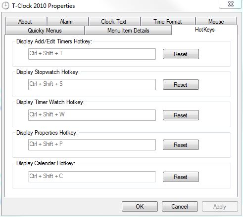

Overlapping Schools of thought - error message wise (guess I'll have to pick one... :)).
I got one other (bugg i created...) issue I've gota get nailed down before the next update - But it will look like:

Nice-looking dialog :)
BTW, I have not succeeded in getting a hotkey with the windows key to work.  Should it?
A specific example is for the combination:
  Left Windows + A
While configuring the hotkey combination, after I pressed the Apply button, I saw "None" as a field value (no error).
Trying the hotkey combination out after configuration didn't seem to have any effect.
A short while later, I noticed that when I was typing a letter "A", the hotkey seemed to come into play (a dialog popped up).
Upon checking the hotkey configuration dialog, I noticed that the field value now had the value "Left Windows + A" in it.  However, invoking the hotkey combination didn't work, though a single letter "A" seemed to.
I hope the description made sense.
Are you able to reproduce on your end?
That is/was one of those I was on-the-fence issues I'd planned to get back to later. The Windows keys do not work reliably because they're a reserved System Key. While I'd toyed with trying to make it work (to see if I could), I suspect it would be a very bad coding practice to foist on the users. The standard Windows Shortcut options block them from being used ...(for a reason)... So, I will also in the next build.
Thank you, for your continued efforts at poking holes in my code :)

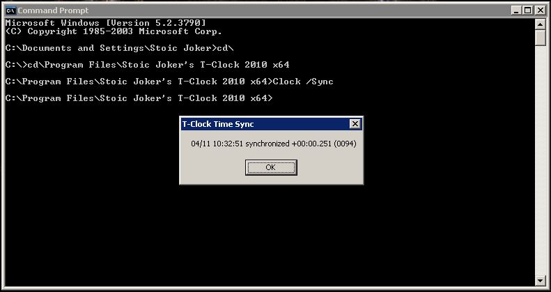

Okay, Time Synchronization: (mouser...) Being that it was stated that a manual sync would be acceptable...It gave me a bit of (~Artistic~License~) Latitude. I did not want to have TC2010 triggering any manner of Administrative Rights/UAC Issues/Prompts. So, The best (Have-Your-Cake-and-Eat-it-Too) solution I could concoct was to (give TC2010 a split personality) run the Time Sync from a 2nd session via the command line.
Hence the TC2010 still does not require Administrative Rights - But the Time Sync (which it now has) does. Navigate to the TC2010 with an Administrative Command Prompt and run Clock /Sync This will partially load a 2nd (hook-less) copy of TC2010 that will synchronize the time with the selected NTP Server and then exit.
Now As I mentioned this is a rough draft, so there is currently no interface to configure the time server with. The registry entry will (for the moment) need to be manually added to the registry here:

While I am releasing this (rough-hewn) feature a bit early, the object is to see how well this compromise is received - before I poured a ton of time into something that totally sucks... ;)
Feedback (desperately needed) Appreciated!

The sticking point is that setting the time in Windows (Vista/7/etc.) requires administrative rights and/or a UAC prompt acceptance (All roads lead to the SetSystemTime(&NewTime) function). So regardless of what I do with the code, I either have to require the program be run with administrative rights, or saddle the user with UAC prompts ... Which will result in the program being run with administrative rights. That, of course would violate one of the core design requirements that I set forth back in 06 (come to think of it, it was more like 03 when I started the project).
Fortunately, I like a challenge. :) So I cooked up this little scheme which allows the time to be quickly sync'ed from an administrative command prompt - which I'm guessing most of us tend to frequently run and/or keep handy. It's kind of a Power User Easter Egg if you will...
The primary question, at this point, is whether or not this scheme fits your definition of an acceptably convenient solution to (time Sync) problem X?? ...If it does, I'll continue flushing it out with a UI for server & logging configuration etc..

if you are saying the procedure is:
1. set reg key manually
2. Navigate to the TC2010 with an Administrative Command Prompt and run Clock /Sync This will partially load a 2nd (hook-less) copy of TC2010 that will synchronize the time with the selected NTP Server and then exit.
then i regret to say it but i'd much rather bring up the adjust date/time dialog in windows and navigate and click on the Update Time button.  it's hard for me to envision a scenario where i think it would make sense for you to write your own time sync code with your own configuration of time servers..  maybe i'm not the normal user for this, but if i'm running this once per week or month, i have no problem at all dealing with a UAC prompt for such a thing.. but more significantly, i just dont see why you should have to implement this yourself, it seems like a clear case to me where the cleanest solution is to just bring up the built-in windows time sync dialog and let MS handle the issues involved in configuring a time server, etc.

« Reply #99 on: May 14, 2010, 11:44 PM »
I have installed the beta 6, and have noticed the following.
The properties dialog doesn't appear on screen - but it is in the window list. It looks like it is appearing to the right of the taskbar - however as my taskbar is on the right of the screen this places it off screen.
Unfortunately I can't seem to duplicate this behavior. I moved my Taskbar to the right side of the screen, selected T-Clock properties and it popped up to the left of the Taskbar as expected. I tried this on both the left & right monitor of a dual monitor (Win7 x64) rig and on a WinXP single monitor rig. Do you perhaps have another desktop customizing app that in bay be confused by/conflicting with?
If I open the properties dialog and go to the alarm page and press OK, or Cancel, - then after about 7 secs. explorer stops working. If instead I go to the clock text, or time format pages it works correctly.
I can't duplicate this one either - But I haven't dug at it extensively yet. Any other details you can provide will be appreciated.
nm I think I found it - Simular to the (now fixed) Mouse Tab Crash - I'll try to get an updated build posted some time this weekend.
The initial colour of the clock text is black - however the background is also nearly black, so the text is hard to read. While different OSs and themes vary I think that very dark backgrounds are much more common that very light ones, and that white would thus be a better default colour.
Now that one has been bugging the crap outa me, and is now on the ToDo list (I had been waiting to revamp the defaults till later).
When creating an alarm it is difficult to enter the time by typing in the time. In the hour field the cursor is usually at the beginning (even after typing a digit) and thus any typed value is discarded. The minutes field is a little better - or I was just more experienced at the field's oddities.
Damn, that is annoying, I'll see about changing its behavior to be more like the Create Timers dialog.
Alarm sounds tend to be short - often so short as to be easily missed. It would be useful to specify the number of occurrences - so that the bell could ring say 6 times at 6 pm.
Ring 6 times at 6:00pm - You mean for the hourly chime? The plain alarms have the repeat option which will loop the sound file until dismissed. Also for alarms, you can throw any sound file at it .wav, .mdi, .mp3 ... The sounds that come with are just handy examples to play with (Okay, granted I love the ClockChimes.wav - But it isn't mandatory... ;) ).
Now the 6 rings @ 6 Hourly Chime thing I like, I'd actually been toying with trying that ... So it looks like I will be now.
