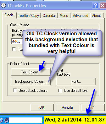

Re: T-Clock 2010 Missing background traybar color
« Reply #563 on: July 02, 2014, 10:08 AM »
@stanislay33:
not sure if I will ever add that... but you're right, T-Clock doesn't include such a feature...
I'm not totally against it... but do you really like/need it? Isn't the transition with the task-bar way better :P?
Regarding my original post with screenshots at:
http://www.donationcoder.com/forum/index.php?topic=21944.msg357498#msg357498
@WhiteTigX: Unfortunately some of us suffers of impairments with eyes about color detections; you may call is daltonism, i.e color blindness for general or specific combination of colors.
Black over Yellow is much easier to catch than Blue over Grey but for other people the choice could be different and subjective.
So I am simply here to kindle remember that restoring/implementing that T-Clock original selectable background color traybar feature would be greatly appreciated.
Thank you! --
