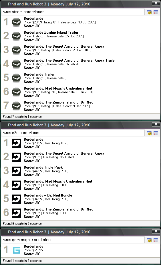

i made a .conf to search sites like Steam, D2D and Gamersgate. they are video games retailers who specialize in digital distribution. you may refer to the screenshot below to get an idea of how it works.
Usage info:
Spoiler (click to show/hide)
• Download and install the FarrWebMetaSearch plugin if you don't have it already. (link)
• Then unzip steam_dd.zip into the searches sub-folder within FarrWebMetaSearch folder (may look like this C:\Program Files\FindAndRunRobot\Plugins\FarrWebMetaSearch\searches\)
• Restart FARR.
To use it, type:
wms steam [search]
wms d2d [search]
wms gamersgate [search]
Hint: you can type the 1st word then press 'Tab' to complete.
btw, i'd like to thank [user]Perry Mowbray[/user] for his help in making these .conf and also to [user]phitsc[/user] for this awesome plugin..
edit: fixed the regex for games that are on sale.
