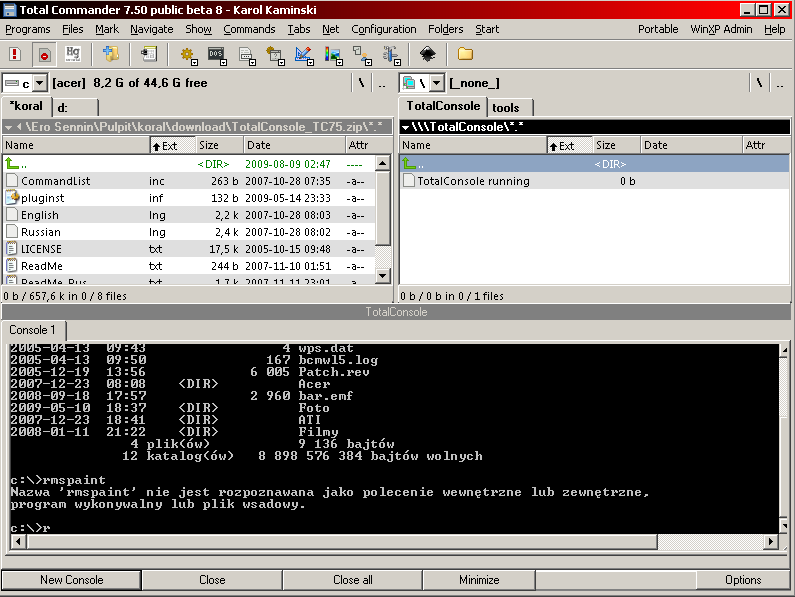

All I do is:
1. Configuration -> Operation -> Plugins -> Filesystem plugins
2. click on Configure and add downloaded (and unpacked) plugin,
3. go to Network Neighbourhood (using Alt+F2),
4. hit Enter on Total Console item
5. when new buttons bar is added at the bottom of TC click on "New console" button and have something like:
6. that's all.

thanks for the little tutorial, I got it working. Not bad!

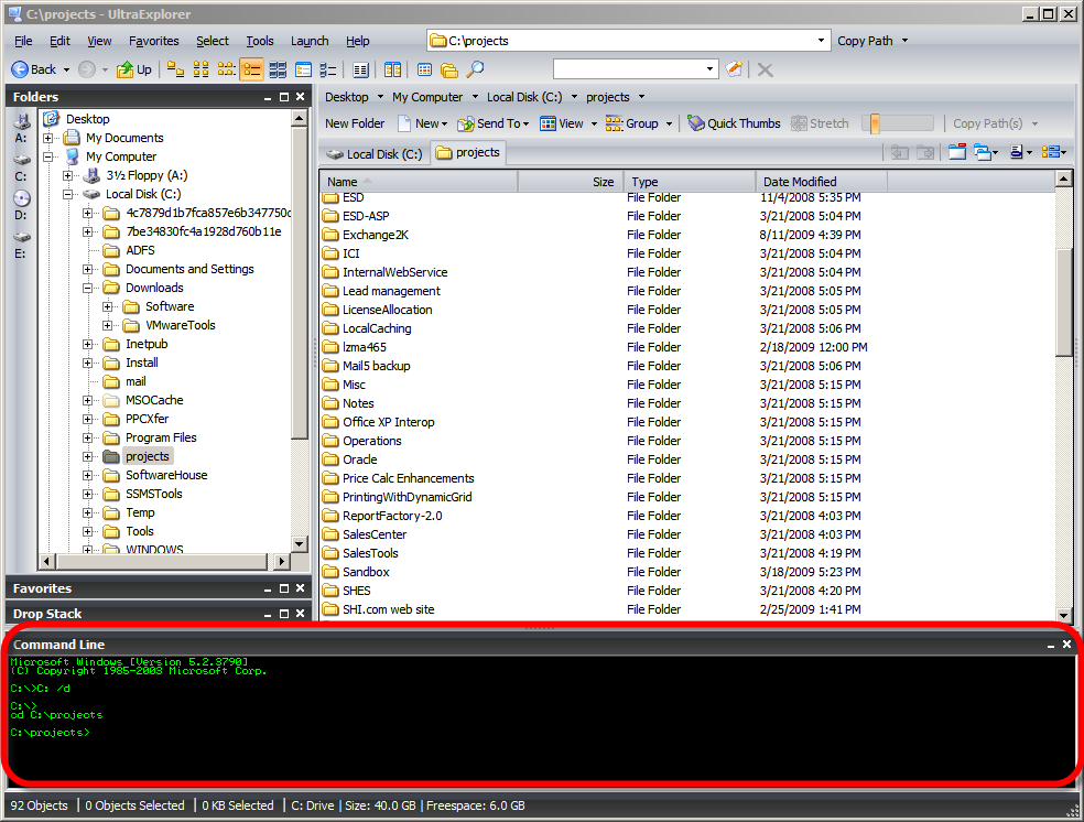

UltraExplorer has an embedded command prompt window. See red-circled area below:
This also has an option to auto sync the command line cd with the currently-selected folder in the listview. It does this just by pumping cd commands into the command prompt.
But there's no way to insert the shell of your choice (I don't think).
Freeware.
Product site here: http://www.mustangpeak.net/subdomains/ultraexplorer/index.html
Previous discussion here: http://www.donationcoder.com/forum/index.php?topic=8989.0

I already mentioned that in my first post:) The main problem with UE`s console is that it does not work that great. I think it is just redirecting a console output. It works ok for simple stuff.  For more complicated stuff it is no use, things like file-folder name completion, or ssh wont work due to the way it works.
"Pseudo-terminal will not be allocated because stdin is not a terminal."
