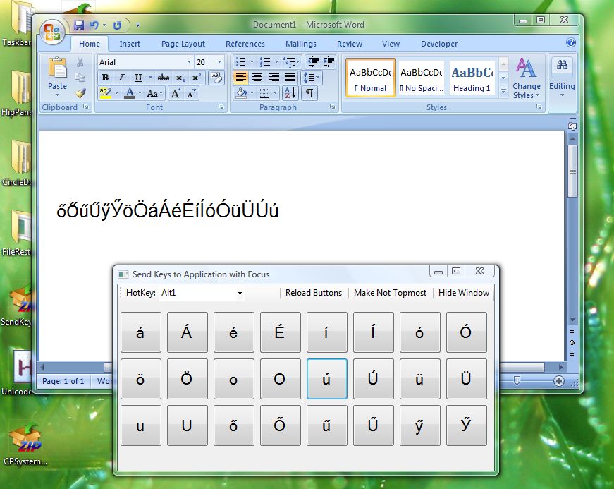

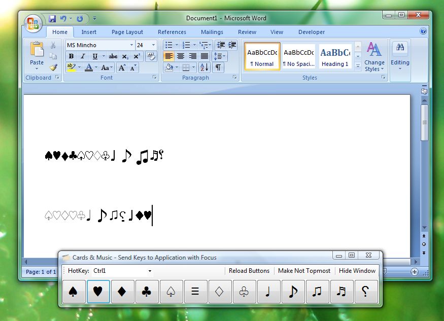

[attachthumb=#]1
Edit: Grab a newer version of Easy Unicode Paster in the messages below.
For what it's worth, here is a version of the easy unicode paster program you want in .Net since that is what I'm using primarily at the moment and I have the components to build it from other projects. I think the screenshots do good job of illustrating what it can do but I'll point out some of them to make it clear:
(1) You can paste either single unicode characters or a string of them at a time.
(2) You can change the number of buttons, the order of the buttons, the unicode characters pasted, the size of the buttons, and the default size of the window in the Config.ini file. The buttons are automatically layed out by the program.
(3) You can select a hotkey from the drop downlist (try the hotkeys out, some may not work on your system) that hides the program. Pressing the hotkey again shows the program.
(4) There is a tray icon (not shown) that makes the program visible.
(5) You can make the program topmost/not topmost.
(6) Click the "Reload Buttons" button to reload the settings from the Config.ini file.
(7) The source code is pretty simple and readable since all the hard things are done by the .Net Framework and a couple of dll files.
(8) The program does not take focus even when you click on it. It will send the unicode keys to which ever window has focus.
The executable and the source code are included (written in my favorite language, C#). I think that this program is pretty handy since I could use it for other things like pasting addresses in programs or registration forms.
You can get the latest version of .Net from http://www.microsoft.com/net/Download.aspx and it won't slow down your computer since it doesn't run when it's not used. I think the new version of the .Net Framework has a pretty small download size from what I've been hearing.

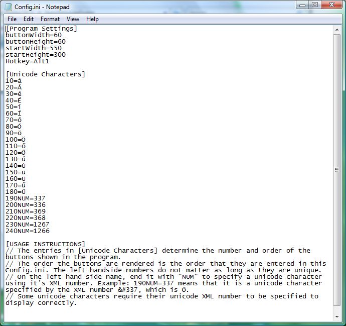

wow Eric, this is almost perfect. it looks great and does everything i wanted it to - except for the unicode part! i don't know if i did something wrong or what. here is a clip from the config file i set up that includes all of the special characters used in Hungarian:
Code
10=á
20=Á
30=é
40=É
50=í
60=Í
70=ó
80=Ó
90=ö
100=Ö
110=ő
120=Ő
130=ú
140=Ú
150=ü
160=Ü
170=ű
180=Ű

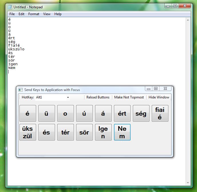

everything works but four - 110, 120, 170, and 180. these are the four unicode characters in Hungarian. they are the four that give me the most trouble. all the rest i can make in Word using the built-in hotkeys - but not these. Skrommel's Accents makes all the rest except for these. gosh, i hate those four vowels  :mad:
should i be using a different font? do i have something set wrong? i would love for this to work, the app you made is just ideal for my purposes!
by the way, did you look up some hungarian words for your screenshots? i see a few in there :)

......everything works but four - 110, 120, 170, and 180. these are the four unicode characters in Hungarian. they are the four that give me the most trouble. all the rest i can make in Word using the built-in hotkeys - but not these. Skrommel's Accents makes all the rest except for these. gosh, i hate those four vowels  :mad:

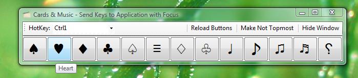

[attachthumb=#]1
[attachthumb=#]2
Looks like there is either a bug somewhere in one of the implementations of unicode in either Windows or some programming libraries. Either way, I've fixed the problem of those special unicode characters in EasyUnicodePaster V1.1. I've made it so that you can specify the unicode XML number of the character you want in the new Config.ini file as well as just pasting the plain characters when those work. The screenshots above should show you how it's working now. I just took the part of the Config.ini file you pasted and added the last 6 buttons in their with the double accent characters.
I've also changed the font of the buttons in the source code to be a regular typeface for easier reading of some of the more complex characters.
And yes, I looked up all those hungarian words and characters on Wikipedia just to see what I was dealing with. I think I'll do a bit more refinement on the interface of this program and how you change the settings and set up a Wikidot website for it since I think this is quite useful and easy to use. I think there are lots of people who would just like a simple program like this when they are working with weird unicode characters since it is much faster than going through lots of menus and the large buttons make it easy to use.
Executable and source code (C#) included in the zip file.

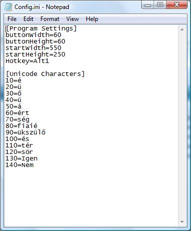

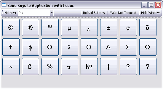

There was a little bug is version 1.1 of Easy Unicode Paster. There was a hidden panel in the program that was interfering with the flow layout of the buttons. I was wondering why the buttons moved around like they did.
This new version has a much more logical button flow layout. Please delete the old one and use this (version 1.2).

Can Easy Unicode Paster [EUP] be made support signs like  ♠ ♥ ♦ ♣ ♤ ♡ ♢ ♧ ♩ ♪ ♫ ♬ ؟  please? Diacrit includes these signs but will not tell their NCR/XML numbers, and BabelMap will tell all names but does not contain these, so I have not been able to make EUP show them.
" ؟ " is the Arabic Question Mark = 1567 ;  but EUP will not display it.
Your in luck, I've just been making improvements to Easy Unicode Paster and I want something to test it with. Changes I've made:
-Real time dragging and resizing with the mouse instead of having to unclick like in the previous versions.
-Remembers your last window size and location when exiting.
-Ability to change the font and size of the buttons.
I'll try and make a character set out of those you pasted. I'll be back in a few minutes.

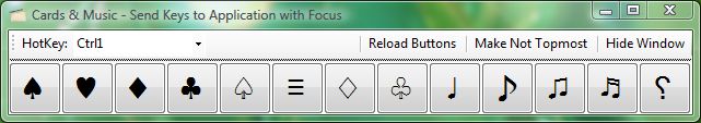

@Curt, I got your symbols working in the new version of Easy Unicode Paster (V1.3):
[attachthumb=#]1
[attachthumb=#]2
I have started a webpage for Easy Unicode Paster. The address is: http://easyunicodepaster.wikidot.com
You can download your Cards & Music version of EUP (1.3) off the website.
If anyone else has some character sets they want or they want to create some character sets for Easy Unicode Paster, just post here or PM me.

[attachimg=#]1
Oh yeah, I forgot to mention, there are tooltips for each of the unicode buttons in Easy Unicode Paster 1.3.

With Easy Unicode Paster Version 1.3, there is no longer a need to calculate the window size. The program will automatically save the last window size used and the last position the window was at upon exiting. It will load this again when the program restarts. This means that all you have to worry about is what is inside [Unicode Characters] in Config.ini.
The syntax for Config.ini is slightly different. You now use *NUM* at the end of the name for a unicode character to specifiy that you are giving the program it's unicode xml number. The text on the very left of each line, before the "=" sign is used as the unique name and tooltip text for the button. You can still paste what you have from version 1.2 into version 1.3 and the program will still display it. Give it a try and post your Config.ini file if you have trouble.
To modify the size and font of the buttons, right click on them when you have Easy Unicode Paster opened.
I'll do a section up on the website explaining how to modify Config.ini.
