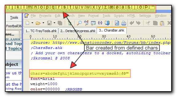

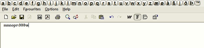

:) Try CharsBar!
Add your own characters to a docked, autohiding toolbar.
Change the settings in the top of the script.
Skrommel

;CharsBar.ahk
; Add your own characters to a docked, autohiding toolbar
;Skrommel @ 2008
chars=abcdefghijklmnopqrstuvwxyzæøåß|ðÞ™
font=Arial
weight=1000
color=000000  ;RRGGBB
size=12
buttonw=20
buttonh=20
xspace=0
yspace=0
dock=top      ; top left right bottom

Just go to Autohotkey.com, download and install autohotkey. Then, open notepad, copy-paste that code there and save it as "CharsBar.ahk".
Then just double-click charsbar.ahk :)

Curt, what was the error message you received?
anyway, after you mentioned this problem, i had tried the script and it displays the chars but doesn't inserts them when i click/double-click on it.

« Reply #12 on: August 30, 2008, 12:44 PM »
Odd... works fine on my machine.
Re: IDEA: toolbar with spec character links
« Reply #13 on: August 30, 2008, 05:14 PM »
I am very pleased to see that it is working for you, Phil, and to some degree also to you, lanux. On my setup there is no toolbar at all, so I never get to test the pasting in the first place.
