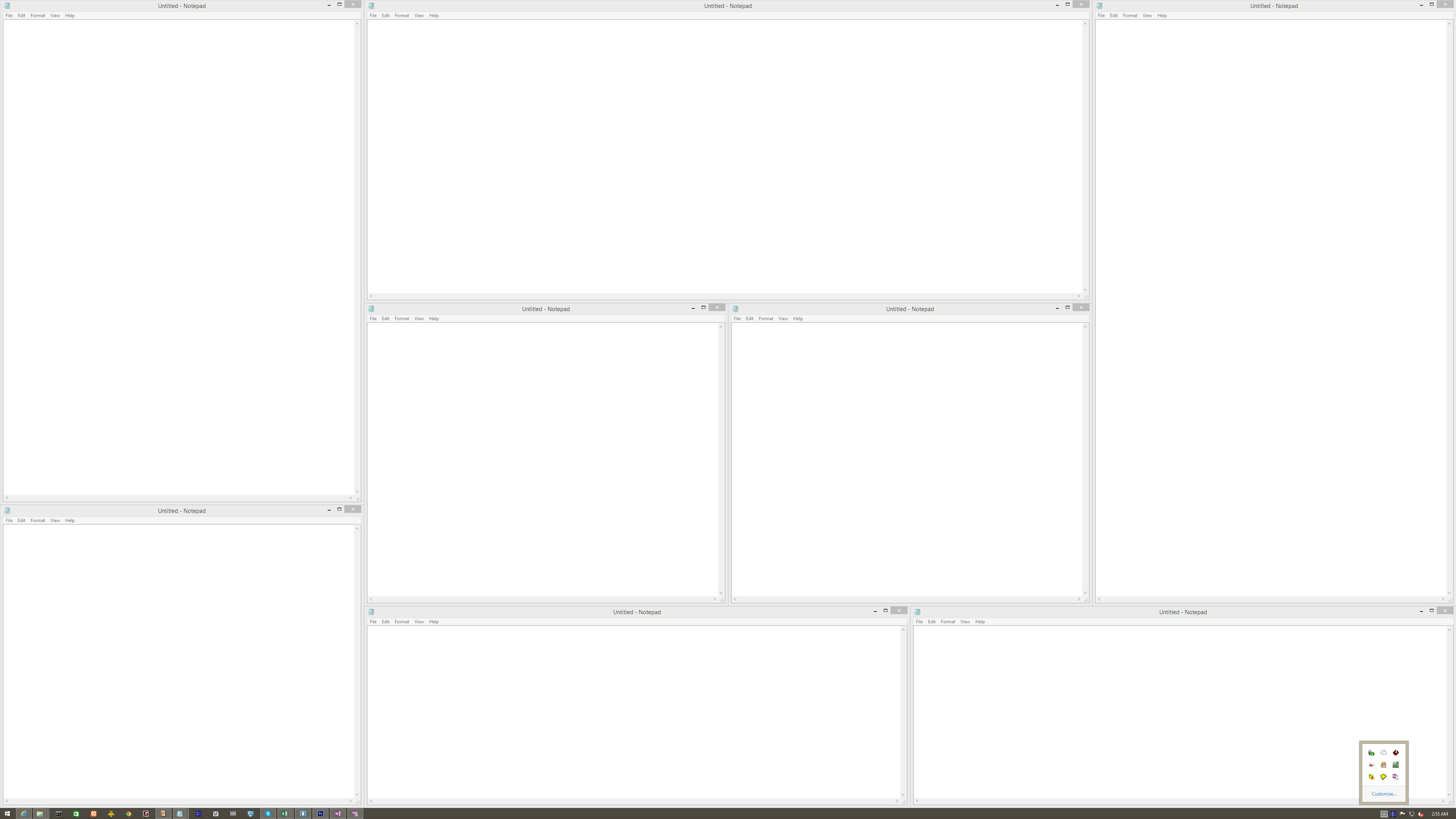

numlauf
  • Joined in 2015
Re: GridMove: Grids Here

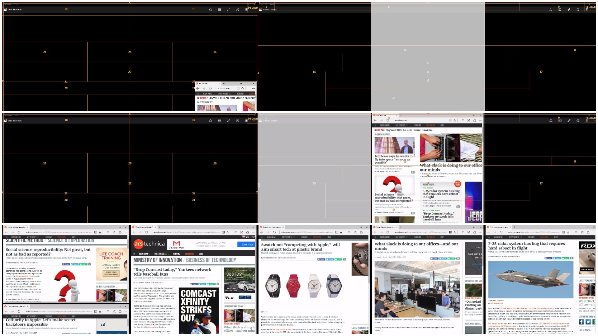

« Reply #102 on: May 16, 2015, 01:28 AM »

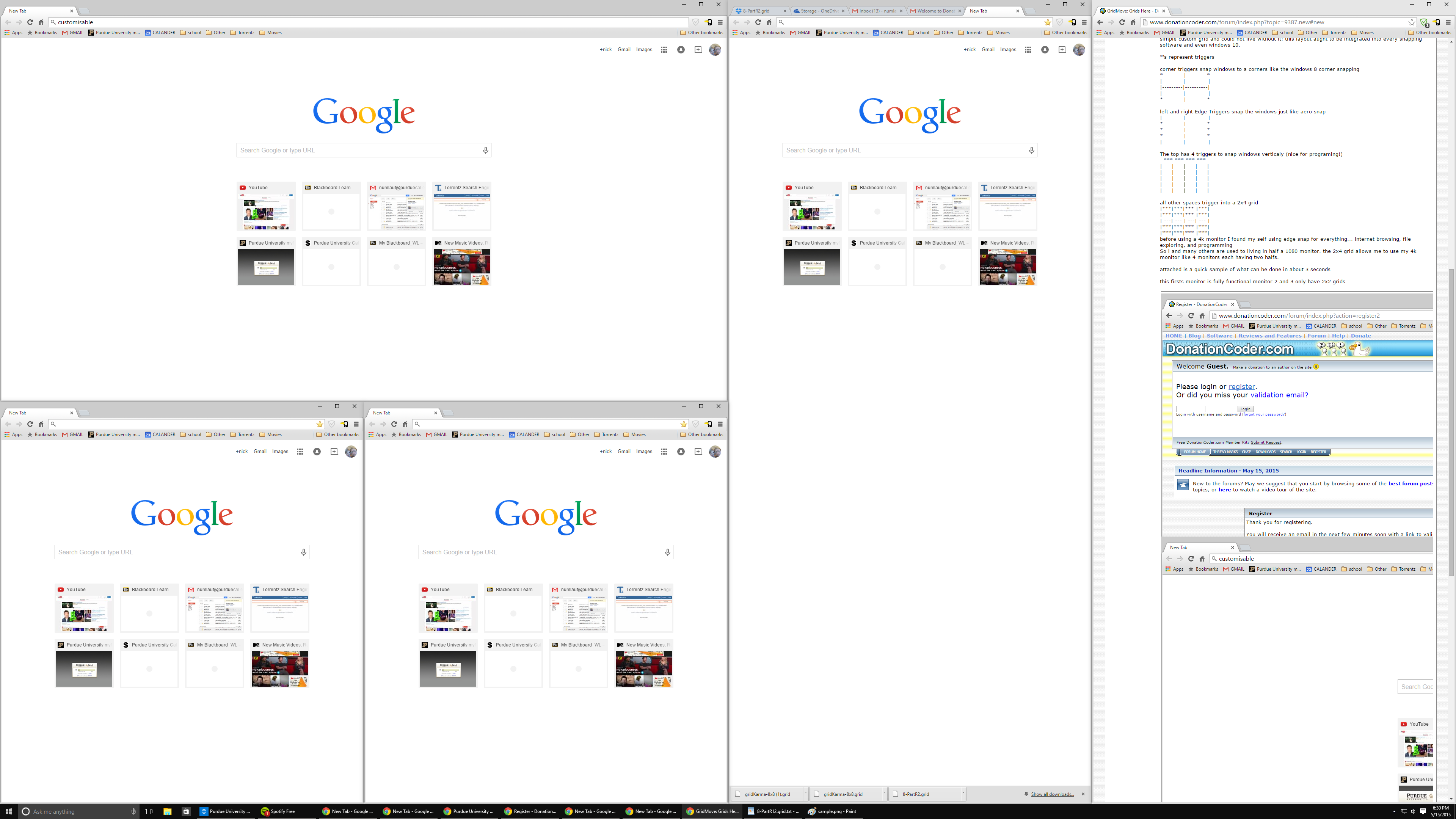

I cannot believe it is so hard to find a good window snap for a 4k monitor!
I tried a few different snapping software and found gridmove is the most simple and customisable solution.
Windows 10 beta offers a better window snapping than 7 & 8 but its still not perfect.
I use a 4k 50" monitor primarily for programming and defiantly need the real-estate so i made my own simple custom grid and could not live without it! this layout aught to be integrated into every snapping software and even windows 10.
*'s represent triggers
corner triggers snap windows to a corners like the windows 8 corner snapping
left and right Edge Triggers snap the windows just like aero snap
The top has 4 triggers to snap windows verticaly (nice for programing!)
all other spaces trigger into a 2x4 grid
before using a 4k monitor I found my self using edge snap for everything... internet browsing, file exploring, and programming
So i and many others are used to living in half a 1080 monitor. the 2x4 grid allows me to use my 4k monitor like 4 monitors each having two halfs.
attached is a quick sample of what can be done in about 3 seconds
this firsts monitor is fully functional monitor 2 and 3 only have 2x2 grids
« Last Edit: May 16, 2015, 06:26 AM by numlauf »

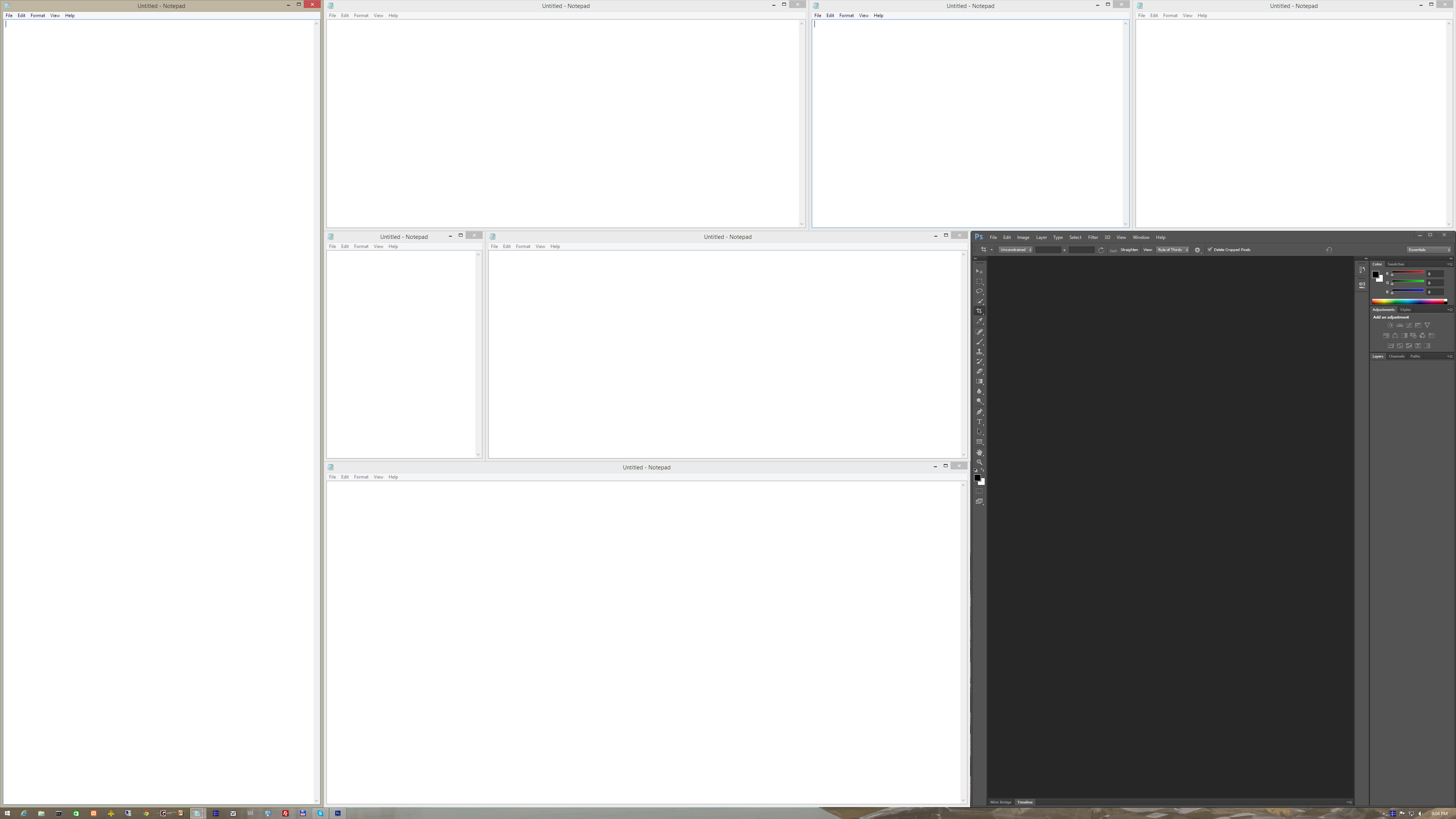

theloot123
  • Joined in 2015
  • Posts: 3

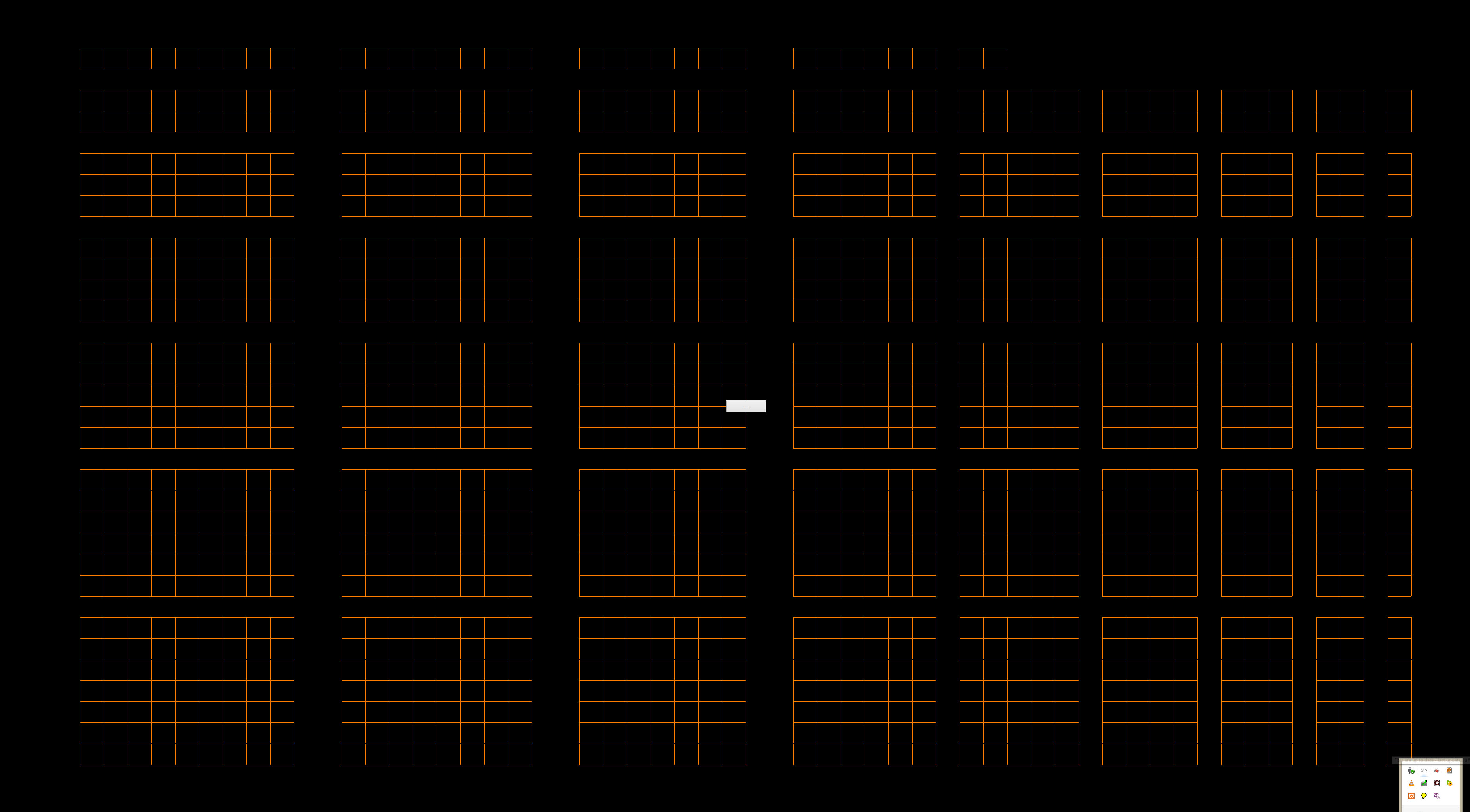

« Reply #103 on: May 17, 2015, 01:26 AM »

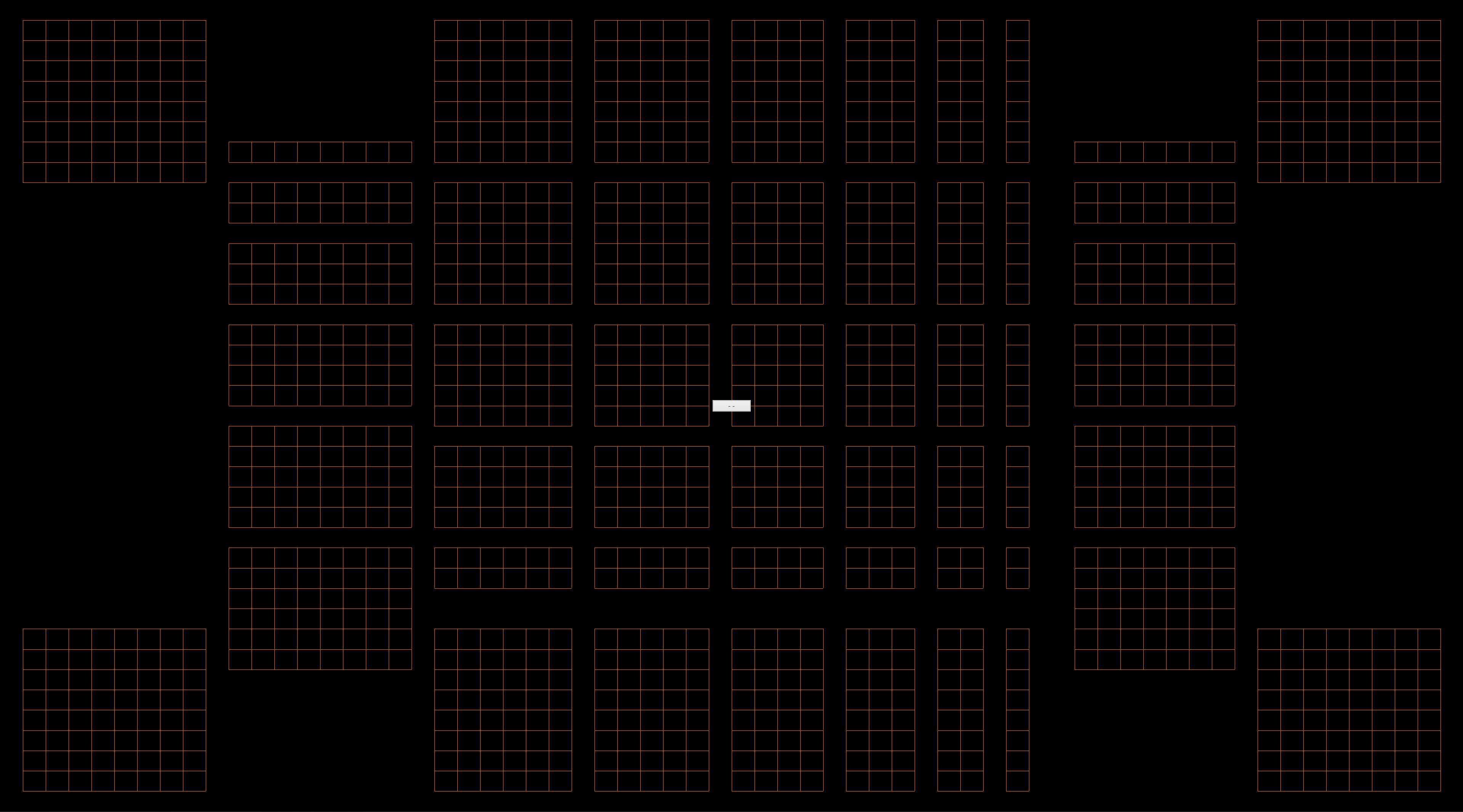

9x7 Mouse driven grid and all the combinations
this simplified trigger layout method is ironically the most effective at attaining all the possible positions/sizes with triggers. It's easy to put together any multi window layout in seconds like those in the attached pics.
The triggers stop rendering at 1249 but the "invisible" triggers still work.
First load takes ~12 seconds
Suitable for a UHD Monitor.
« Last Edit: May 17, 2015, 01:35 AM by theloot123 »

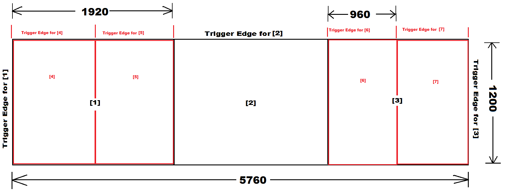

Here is a grid I wrote for my Eyefinity setup. It's a 3x1 setup with the resolution of 5760x1200, it should work with any 3x1 resolution setup.
Mind you that the monitors have to be the same resolution, also it accounts for the task bar being on the middle monitor.
It's split in to 3 even screens and then both side monitors can also be split into halves.

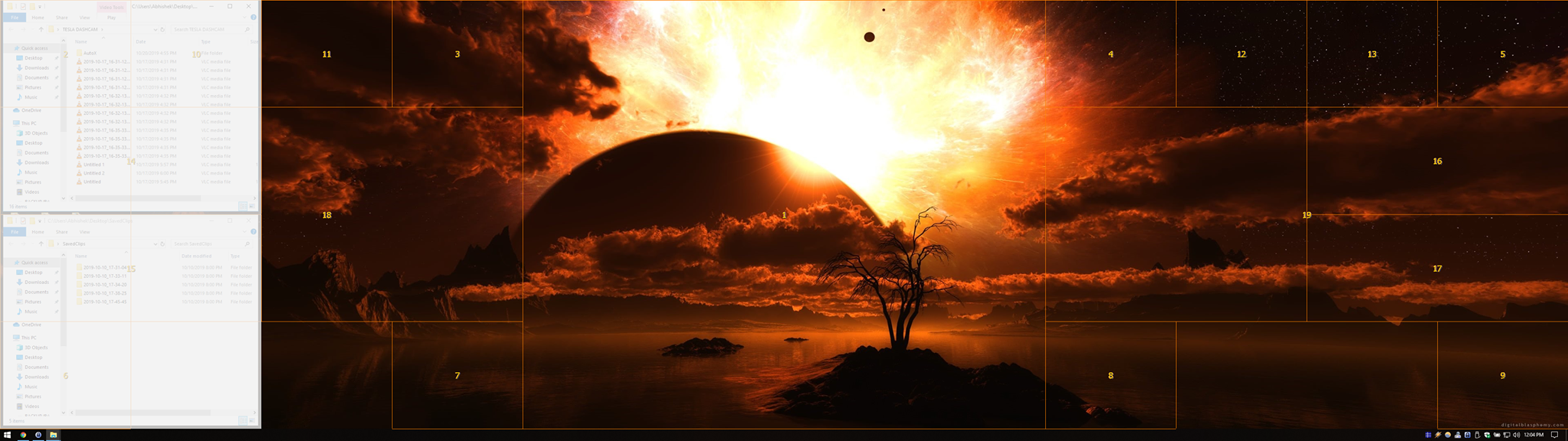

« Reply #106 on: March 05, 2016, 12:19 AM »
Ultrawide Simple v1
This template will work on regular monitors of course too, it was just designed with the idea in mind that the primary would be an ultrawide monitor and that the secondary monitor is a normal "box shaped monitor"
pink shows the zones
Ultrawide Simple v2 (i.e. not so simple...)
What I use now daily is this template, it is a great improvement over version 1 (for power users), so it is not quite as simple - but still quite logical
It really gives a lot of positioning power, I have no idea how I could draw a simple diagram like I did for v1... just best to download and experiment with using it
It is almost "finished", what I mean is - it works - and works well. However, every few days I tend to add something. There is not much room in the way of target zones left for adding zones without harming the "user-experience", so I might only add 1 or 2 more things - or maybe none at all. That's what I mean... it is perfectly usable in its current form.
It is still intended for the same use case (i.e 1 or 2 monitors, the primary being ultrawide - but it still is fine for non-ultrawide) .. basically if you are a power user, try v2.. if you don't really care too much about have "finer control" over the layout, use v1
v2 also has a youtube positioning zone on primary monitor very top left that on chrome (with the bookmarks bar off), will resize the window exactly the the size that will show a video only [if theatre mode in the youtube player is off] - at least on my browser... if it doesn't work exactly for you, you can always edit that particular entries height and width of the window.
example of grid (3 screenshots in the photo)
These are 2 monitors
the sticher I used cropped some of the bottoms off, so the actual grid is a bit taller than it looks, for example the bottom left browser window should be the same height as the one above it
« Last Edit: March 10, 2016, 05:11 PM by ycomp »

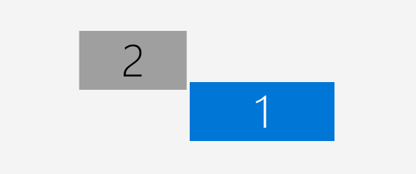

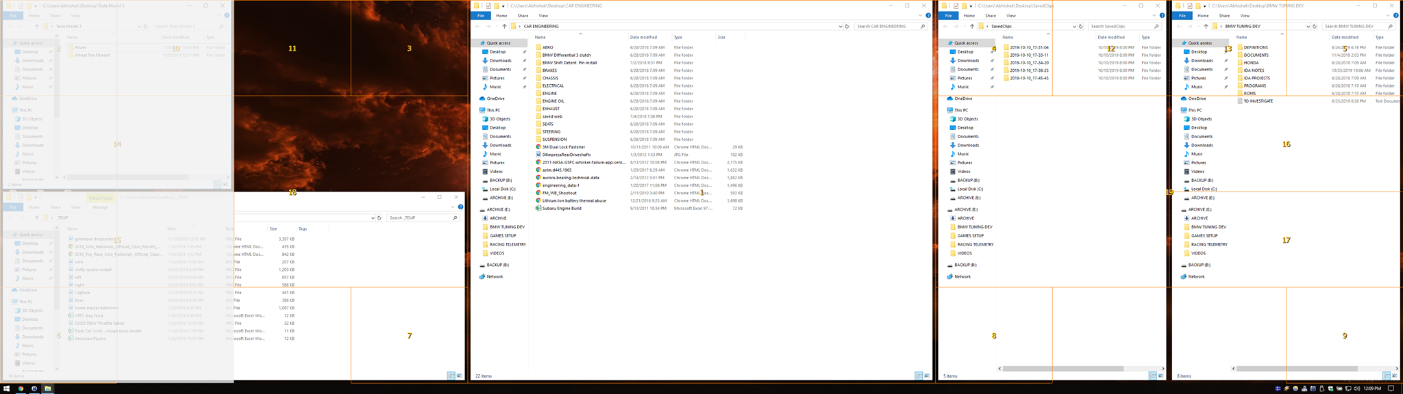

« Reply #108 on: May 25, 2016, 04:40 AM »

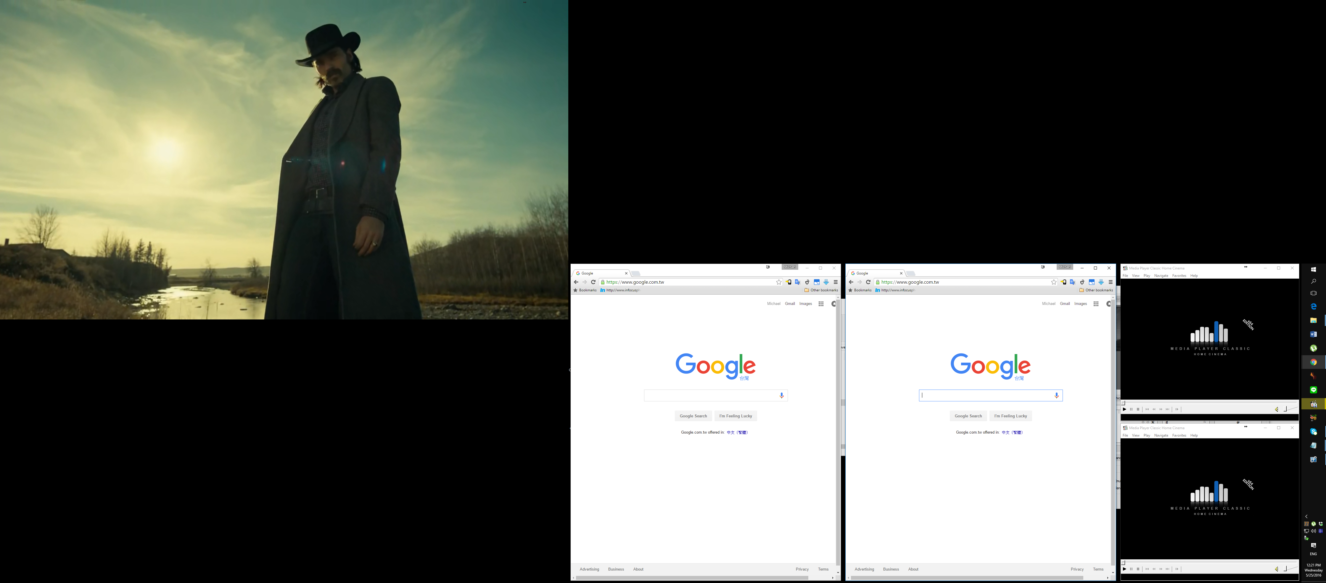

err...I put my grid as a separate topic by accident
Hi folks,
Gridmove is still useful in 2016 and win10.
I have a minipc attached to my TV (1920x1080) and an ultrawide screen (2560x1080).
I offset my tv screen to touch my monitor in the corner, so windows can be dragged across monitors at the lower right of the TV and the upper left of my monitor.
I put my taskbar on the right vertically to preserve height and not to make it difficult for me to drag windows.
Using the config below, I have two large areas for websites and two smaller video windows on my monitor for previewing what i send to the tv.
virtual preview
The grid has a few features. There is a topbar for the two web windows to combine as one big window. Same with the rightbar to combine both vid windows in case I want to edit a text document. There is a big undo bar at the bottom of the second web window to revert to original placement. The last bar maximizes the window to the TV.
Still modifying and I welcome suggestions.
Michael
« Last Edit: May 25, 2016, 04:56 AM by macst34 »

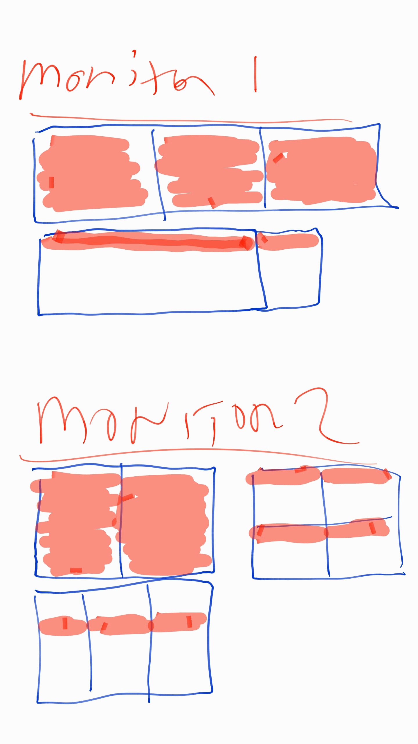

Hi all. This is a wonderful software. I work in an office that was just given 4K 34" curved monitors to work off of, and am wondering if someone may have a moment to help with a custom grid? I have tried a few things myself, and made it as close as possible, but cannot seem to get it exact:
To explain, the screen is in 1/3's vertically, but the first 1/3 zone (left side) is split in the middle horizontally to make four total zones. Any help would be greatly appreciated.  :)
Hi Sharknado,
If you look closely, my previous grid macst346.grid is just an left right invert of what you requested.
Based on your suggestion I added some more zones on my current grid. It is a superset of the grid config you want.
Play with the ratios if you want exact 1/3 horizontal windows. I found I wanted my tall windows to be a little wider than my smaller windows so I used 3/8ths monitor width instead of 1/3rd for my two tall windows and the rest(1/4) for the small windows.
Trigger explanations:
Trigger zone 1 gives a combination of the two small windows (3+4) on the left of your illustration. Zone 11 is trigger of the middle tall window (5+6) and zone 9 gives you a combination (7+8) that results in a right tall window. Trigger 2 gives a huge window of 3+4+5+6.  Trigger zone 10 is undo. Trigger zone 12 maximizes to the other monitor.
The windows are configured like this according to your diagram:
|  3  |  5    |  7  |
|  4  |    6  |  8  |
Read the grid file. It's commented and not that tough to understand. Just remember the top left corner is (0,0) [How come no one ever mentions this to newcomers?
The + or -50s are just to make a 50 pixel bar for the extra triggers according to the reference variables.
« Last Edit: May 28, 2016, 08:31 AM by macst34 »

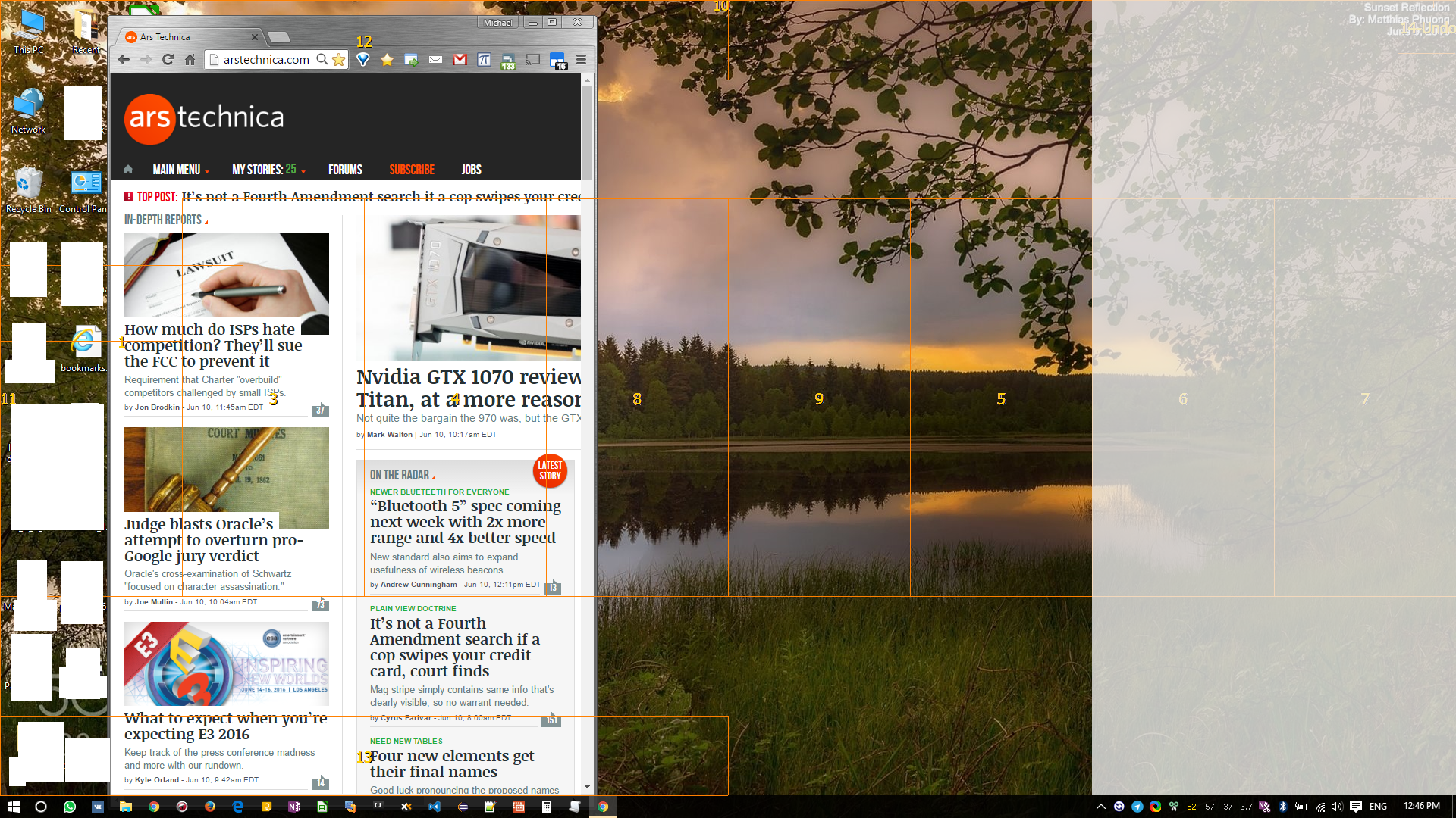

ycomp
  • Posts: 21
« Reply #113 on: June 10, 2016, 04:42 PM »
I suggest trying my grids I posted a few posts back, they are made for ultrawide and work quite well.. well, they are intended for the primary ultrawide and secondary boxed shape but you can easily edit the files and copy the primary twice and do some search and replace to make it a secondary monitor with the same grid. Although my ultrawide is only 2560, but i think it should work fine on a 34"
ycomp
  • Posts: 21
« Reply #114 on: June 10, 2016, 04:55 PM »
This post might seem a bit strange, I've been using my laptop a lot recently (fullhd screen), and use this "ultrawide.grid" I found. The thing is, I think I created it but I can't be sure..
Anyhow it is really useful to me so that's why I'm posting it.
It is hard to understand what it does from a screenshot and why it is so useful, basically the windows slinky/accordion expand when you move them around - so it makes it easy to resize two windows to many different side-by-side positions.
It should work equally well on ultrawide or regular monitors
you can also slide the window along the edges
try dragging a window in the vertical middle of the screen from left to right or right to left to see what I mean about the shrinking/expanding accordion effect
there are also full width top half and full width bottom half window zones.
as well as a "youtube" zone that positions the window in the top-left in a rectangular shape, good for watching youtube while you're doing other things
« Last Edit: June 11, 2016, 03:33 PM by ycomp »

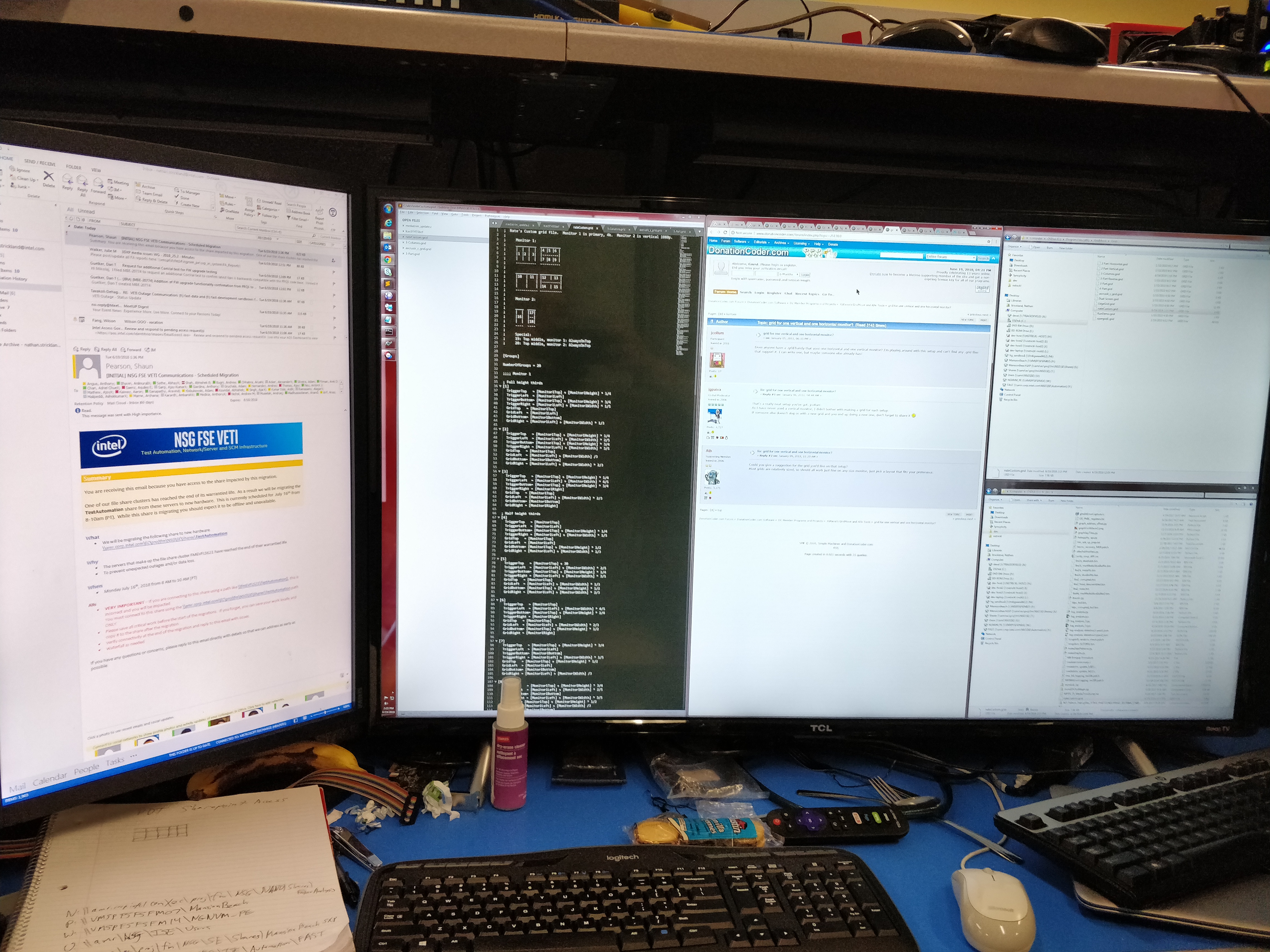

Here's the grid I'm using for a 43" 4k primary monitor + a vertical 24" 1080p secondary.
The primary is split up such that it can be used as vertical thirds, vertical halves, or half height at either of those widths.  The secondary is always full width, used as either full height or half height.

Attached is a picture of the setup in use.  In case anyone's wondering, the 43" is a TCL 43S405 and the 24" is a Samsung S24E650.

Just wanted to say thank you for sharing.  That's a nice setup you have there  :up:

jcoltonj32001
  • Joined in 2019
« Reply #120 on: January 29, 2019, 02:16 AM »
I have an ultrawide monitor and am looking for a template that has 4 up top and 4 on the bottom, in grid format
I too just got an ultrawide and needed a simple 4x2 layout. My monitor is a 49" 3840x1080 and the layout is the same thing you would get out of two native displays on windows (for one monitor obviously).
|  1  |  2  |  3  |  4  |
|  5  |  6  |  7  |  8  |
I'm not 100% sure what I'm doing, so if someone has some suggestions to make this better I'm all ears!
« Last Edit: January 29, 2019, 08:46 AM by jcoltonj32001 »

Attached is an efficient 50" desktop:
7 7 8 9 9 Top 1/4 above eye-level
4 5 5 5 6 Bottom 3/4 as one large center window with two side windows
4 1 2 3 6 Bottom 3/4 as five equal side-by-side windows
I use this on Windows 10 and there is a small gap between all windows. The gap increases with the scale setting and decreases with resolution, and is larger in the horizontal direction :o.
If someone know how to fix this for all scales and resolutions, or knows how many pixels the gap is for each scale and resolution, I'd like to fix it to have no gap.

Huge thanks to the developer of this program. It is just about perfect! Also, thanks to the various *.grid file developers, as I learned a lot from you to make my own file. Also, thanks to the person who created the thread that describes the various syntax functions.
I have an UltraWidescreen monitor "49-Inch, 3840 x 1080".
I created a *.grid file for my personal tastes. It's fairly simple to use and not too cluttered. It keeps the center primary window untouched, but adds a lot of configurable options for the sides. It is broken up into 3 sections (Left, Center, Right).
The Left and Right sections are symmetrically identical. I'm sure there's room for improvement but it is just fine for me as it is now. I also tried to set the 'trigger zones' to be intuitive for my liking. Have a go and see if you like it too.
Feel free to use this as-is, or modify and upload your own versions. I love OpenSource software! Thank you all who have been providing input to this project.
I'm attaching 3 files to this post.
3 - *.grid file UltraWidescreen.zip (707 B)
« Last Edit: November 19, 2019, 04:33 PM by shind3 »
