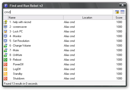

Here's my (slightly modified) version of the alias above.
I added entries for shutdown/reboot/logoff/standby, made each of the entries become an isolated item (so that you don't have to type "cmd" at the beggining), added icons for the new ones, and now "cmd" works both as a list and as a practical example of how to use each of the alias.
Try it!
[edit] changed one little thing: the "lock pc" alias wasn't working, it had to be changed to "lockpc" [/edit]
[edit2] fixed error mentioned below about standby [/edit]
[edit3] "stole" image that lanux had below. Hope lanux won't get mad at me ;) [/edit3]
[edit4]Download removed. Please see this thread for more info [/edit4]

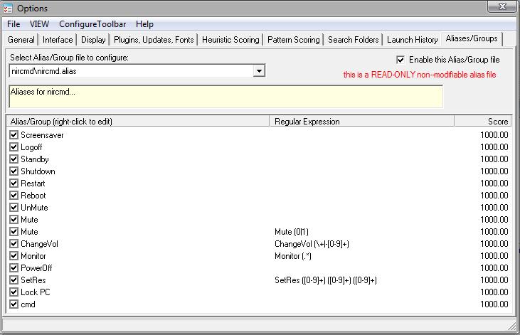

I'm having a bit of trouble trying to find where I'm supposed to put this. Right now I have the entire nircmd folder in the /Aliasgroups/Mycustom folder. The "nircmd icons" folder is in the "nircmd" folder. I'm not getting all the commands to show up and the icons don't show at all. Am I doing this correctly? Do I need to configure anything inside FARR to tell it about the new alias group?
Re: NirCmd Setup, a guide of sorts
« Reply #15 on: July 18, 2007, 01:46 AM »
thats a fine place to put it, BUT you might want to put the subdir in the Installed folder directory since its not something you are supposed to be editing.
then just go to FARR options and close options, that should get FARR to rediscover all alias files.

Well, I must be doing something wrong. I put the entire nircmd folder in /Aliasgroups/installed and this is what I get:
« Last Edit: July 18, 2007, 02:01 AM by edbro »

edbro, i think you have an existing nircmd alias under the name "cmd", if i'm not mistaken.. disable that alias then the new one will be ok.. :)
« Reply #19 on: July 18, 2007, 02:22 AM »

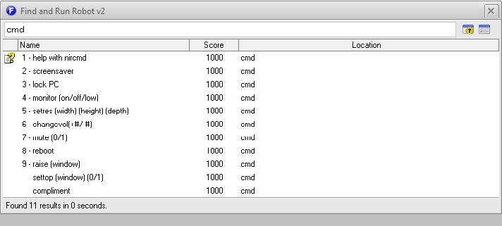

btw, the screenshots provided a clue - check the difference.. :) each of them have slightly different items..
new (jgpaiva's version)
old (non-troppo's version)

Okay, I got it now. Yes, it was competing commands causing the problem. The real problem is the way Vista handles the %programfiles% directory. It will not allow any program to write to any directory inside program files. What it does is redirect all writes to a virtualstore directory buried deep inside the Users directory. I had manually copied some plugins and alias groups into the program files directory. Some stuff was mirrored in the virtualstore directory. When DCUpdater does its stuff, all the updates get written to the virtual store directory. It was a real mess. I ended up uninstalling/reinstalling FARR and manually cleaning up the duplicated items out of program files.
« Reply #22 on: July 18, 2007, 04:48 AM »
oh that is really not cool.
i specifically named the program dcupdate launches to unpack the files in a manner that i thought should make vista ask the user to elevate the rights of the unpacker so that they are installed in the real program files directory..  i am going to have to make some changes if its not doing that.
but wait.. the updater doesnt modify the aliases.. thats only done by the full install tool.
i think you may have misdiagnosed this particulat problem (though the virtual store may be implicated in other issues with farr).
i think this is more of a case of an old version of farr having the nircmd alias and the new version didnt deleted it just added one.  new users shouldnt experience this problem.
