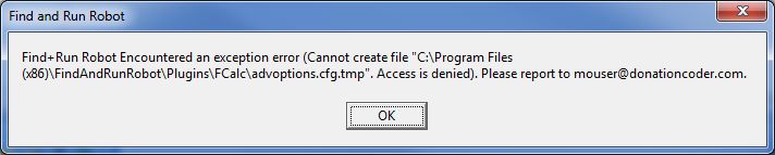

« Reply #93 on: September 23, 2011, 12:49 PM »
I'm getting an error message from this plugin when I use it.  I'll type "fc 2+2", then hit Enter, and receive the following error :
Re: New FARR Plugin: FCalc
« Reply #94 on: September 23, 2011, 02:40 PM »
Paul, I'm afraid this may be a real oversite in my code which normally is smart about where configuration files go.. it seems the plugin specific advoptions files are trying to write into the Program Files\Plugins directory.. when they shouldn't..
Let me try to put together a fix.
One temporary workaround for you would be to move the entire Find And Run Robot directory out of you Program Files\ directory and into your documents area, and edit the configdir.ini to uncomment the Portable=True line, thereby running FARR in portable mode which shouldn't suffer from this problem.
ottenm -- sorry i missed your original question. are you still searching for a solution?

« Reply #95 on: September 23, 2011, 03:39 PM »
To fix some similar issue, I gave my username Full Control permissions to C:\Program Files (x86)\Find and Run Robot (allowing to trickle down to subfolders). I used to have to do that a lot with various programs in Vista, not so much in Windows 7--I've used both Home and Premium (probably because I figured out that most programs that need to write to Program Files are packaged in a ZIP file, so those I now put in C:\Tools instead.) And btw I also use the 64 bit version of the OS.
