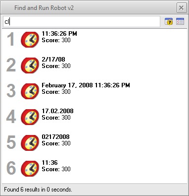

Overview:
This plugin displays the current date/time in a variety of formats.
Info:
http://gogogadgetscott.info/computers/software/farr/
List of commands:
cl : list current date/time
Download:
