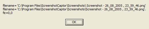

I think I have narrowed it down a bit ...
here are the gui responses with the Debugging version.

Re: Bugs 'n' suggestion
« Reply #28 on: August 27, 2005, 10:38 AM »
i believe the cause can be seen is in your screenshot.
somehow an extra space is finding its way into the filename when it saves it and its causing it to think the file is not overwriting an existing file.  see how the two file names in the debug message are different only in that the first has an extra space?
ok i think i have enought info to fix this now.
« Reply #29 on: August 27, 2005, 10:41 AM »
and i just confirmed that the reason i wasnt seeing it in mine is that i had changed my quickfield and filename template from the default values.
the default values you are using are causing the odd extra space in file names.
this also explains the intermitentness - i will bet dollars to donuts that when it seemed to be working for you is when you were working with files that had already been saved with dif name.
