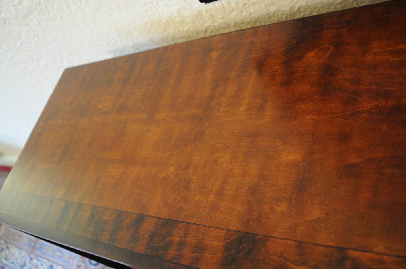

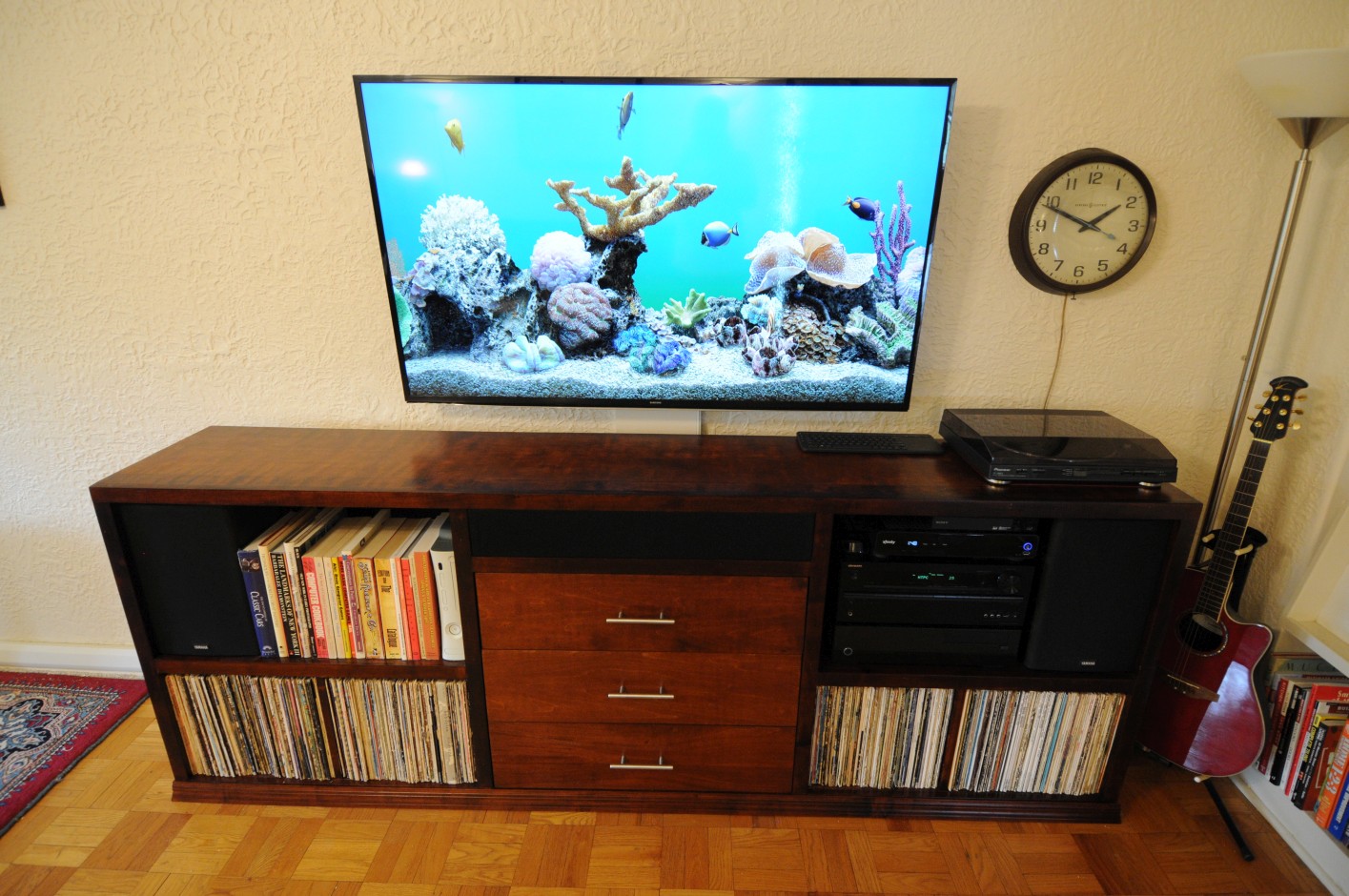

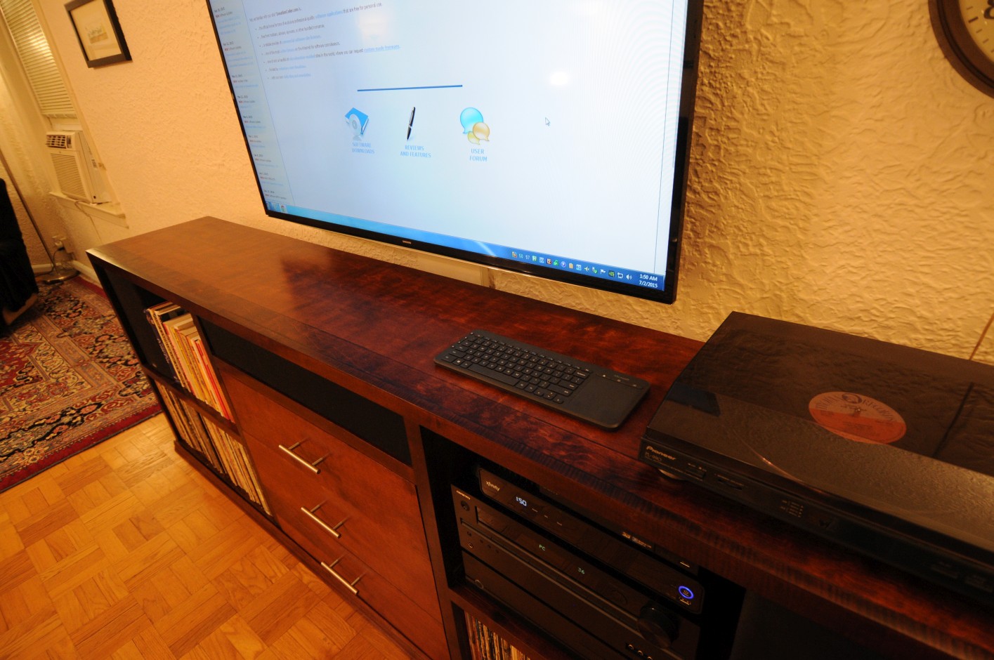

Note 1: The cabinet has not yet been "finished" -- i just wanted to see what it would look like -- i have to remove everything and put many coats of polyeurethane on to give it some sheen and protect the wood.
Pity it needs the polyeurethane - I love the matt finish.

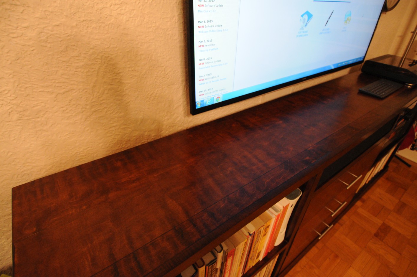

Finishing has begun.. I'm using standard brush-on polyeurethane on the insides, and a thin wipe-on poly (General Finishes Arm-R-Seal) for the top and face frame.  I decided to go with the wipe-on poly for the top and face frame because i wasn't confident in my abilities to brush on a smooth coat. Given how slowly it's going on and how expensive it is, i'm having second thoughts, but i'm committed.
Will take me a few more days to put on all the coats, and then a week to dry.  I'll take more photos when it's done.
It's even more dark looking now -- I've resigned myself to it.  It's not out of place in my living room, where i have a dark wood coffee table, it just still seems like a waste since you can barely see the wood grain..
I'm thinking to go with "satin" as the final coat.  Any finishers have preferences for gloss vs semi vs satin?
« Last Edit: June 27, 2015, 07:49 PM by mouser »

Are you using gloss for the build-up coats? I would go with the glossier of the non-gloss options for the final coat—so as not to obscure the grain further. You can always add some paste wax or another coat of satin if it's too shiny, but it's hard to go back from too matte.
yep -- i've read it's best to use gloss for all but final coat.

I'm finally finished with the finishing. Finally.
Not fun.  I would think twice about using wipe-on poly for big things in the future -- just takes too long to build up.
I went with satin as the final coat and am happy with that decision (somewhat ironic since my initial idea was to buff to a mirror gloss).
I'll post new photos soon.

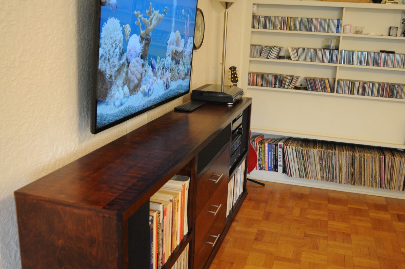

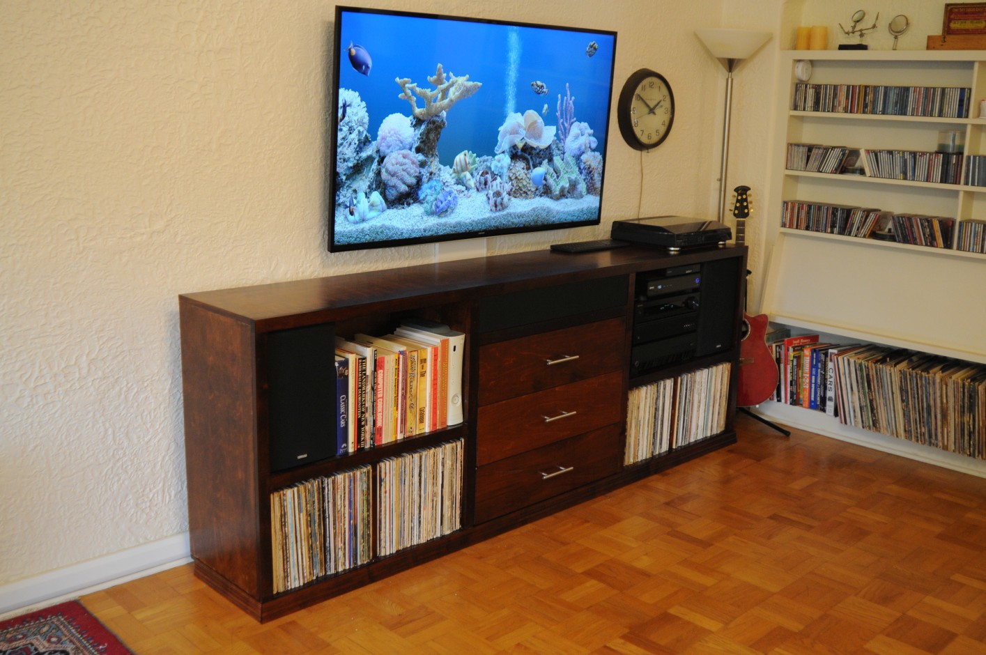

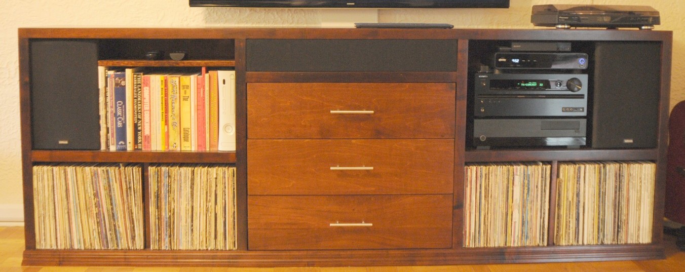

Some final photos.  It's hard to take a photo that doesn't look REALLY dark and shadowy.  In real life, although it is dark, it doesn't look quite so shadowy, and looks more like normal dark wood furniture.
I think it looks a lot better in real life than it does in the photos.
Overall I'm very happy with the new media center, though I'm not sure I would do it all over again given the time and money it took (because of my inexperience).

Re: Software for planning wood bookcases/cabinets/tables etc?
« Reply #183 on: July 02, 2015, 08:05 PM »
I love it :up:
« Reply #184 on: July 02, 2015, 09:26 PM »
That looks great! :Thmbsup:
« Reply #185 on: July 02, 2015, 10:33 PM »
Thanks for the compliments!
I did this mostly for the experience -- and i think i'd have a hard time advising someone to do the same -- in most cases you'd be better off buying something already made --  save yourself the hassle.
The one benefit of making it yourself is getting the dimensions and areas exactly how you want them..
For example in my case:
  • It's hard to see but that small area above the drawers hold the center speaker and some plugs and wireless switch, hidden behind a custom-built little inset speaker grill i made that pops out with a spring.
  • Behind the books on the left is space for a rather substantial 8"x14"x4" battery backup UPS power supply that everything plugs into (cut out in the back).
  • Where the stereo rack is, the back is cut out for access, and the cabinet is 16" deep, just deep enough for my htpc.
« Last Edit: July 02, 2015, 11:34 PM by mouser »

Summarizing some lessons learned from the recent project:
  • Hiding nail holes -- i did this completely wrong.  i did it the way i've done it when painting: sink nail holes; fill with wood putty; sand; then paint/stain.  completely wrong way for staining.  even "stainable" wood putty does NOT take stain well. proper way when staining is to just stain over the sunken nail holes.  THEN fill with COLOR-MATCHED rubberized filler pencil.
  • Drawers -- definitely doable; in future i would leave myself a bit more gap room.  good news is that this false front method is really forgiving -- even more so when you drill the pull holes slightly large, which gives you yet another way to adjust to fronts.
  • I should have bought a mini table saw.  especially for the drawer fronts, the accuracy from a hand held circular saw is not good enough, makes life much harder.
  • Don't oversand the veneer plywood -- i started to sand through some areas on the top, and it did cause some areas of blotching and some small areas of ripouts and rough areas.  i read about avoiding this but it's easy to have it sneak up on you.  i got dangerously close to a problem,
  • Wipe-on poly is a pain the ass in how long it takes; i don't know that i would use it again for such a large piece, but it definitely helped avoid runs and brush strokes.  it was a good idea to use brush on poly on the areas other than top and face.
  • I wish i could see how it would look with a much lighter color.  i think it would have resulted in a much nicer looking piece of wood furniture in terms of being able to see the grain and details; might not have fit in as well in my apt.
  • A huge amount of money and time was spent testing stains and just doing a million little details.  I do this all the time, it's not a good cost-benefit tradeoff.  Next time i think i would just rush through the project.  might not be quite as good but would take 1/4 the time and 1/4 the cost.

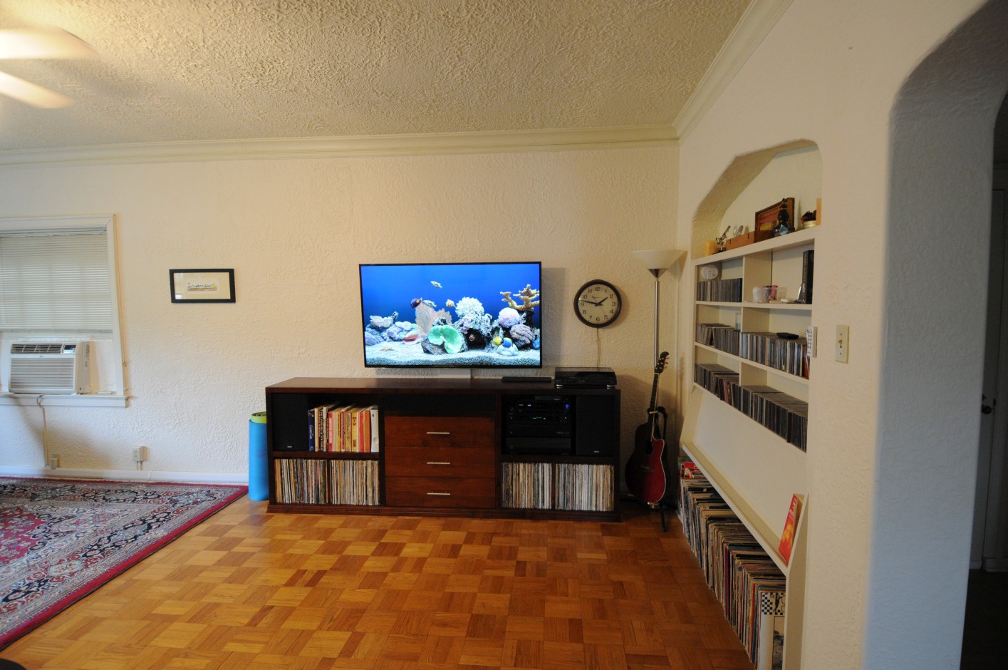

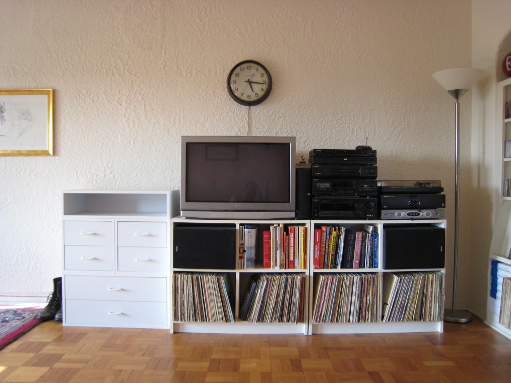

I found an old photo of what the new cabinet replaced.  So here is what used to be there:
« Reply #188 on: July 08, 2015, 09:37 PM »
The new furniture definitely looks much nicer. Nice work! :Thmbsup:

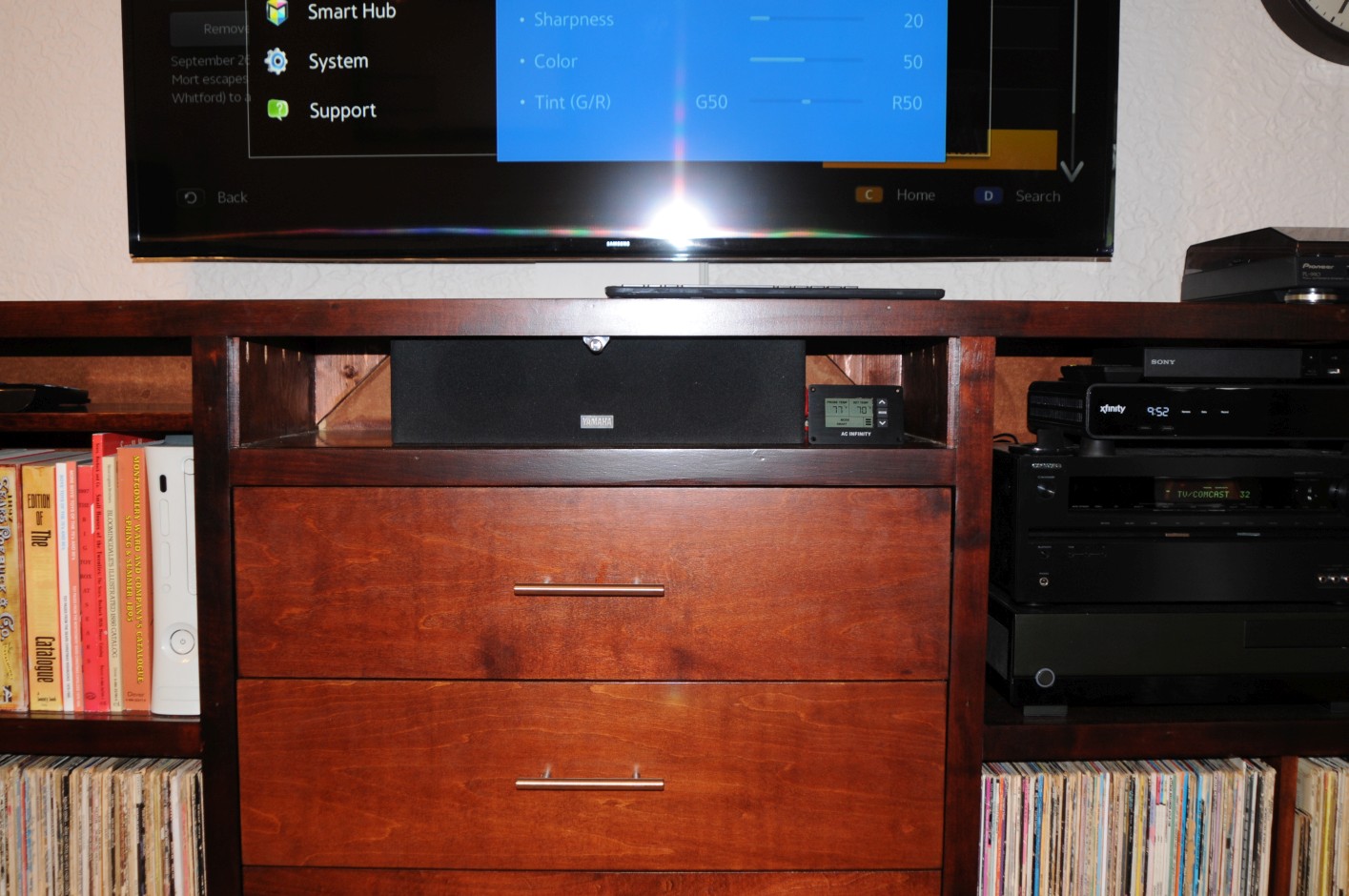

Custom made center speaker cover (spring-loaded pops off):
Behind that is the center speaker, the network switch, and the thermostat control for a cabinet fan in back of the stereo equipment, to keep things cool:

Can we get more details on the spring loaded speaker cover?
Also, does your new cabinet include a TV mount? Or is it a wall mount?
« Reply #191 on: July 13, 2015, 12:46 AM »
spring loaded speaker cover =
a $1.50 magnetic spring latch that you can get at any hardware store.
a square frame built from 1/4 inch square dowels wrapped in speaker fabric.
as for the tv -- i used a wall mount even though it places the tv almost exactly same place a tv stand would put it, just so it would leave the top of the cabinet uncluttered.  i had to employ a trick i use when wall mounting heavy objects on my plaster walls that don't have studs, which is to mount a wood plank to the wall and then attach the tv mount to it.
Thanks. I was seeing that plank going down behind the cabinet and thought maybe you had built in the plank/wallmount onto the cabinet.
« Last Edit: July 13, 2015, 03:48 AM by Deozaan »
« Reply #193 on: July 13, 2015, 01:17 AM »
I actually considered it, but it seems secure not attached to the cabinet. it does look like its attached behind it though.

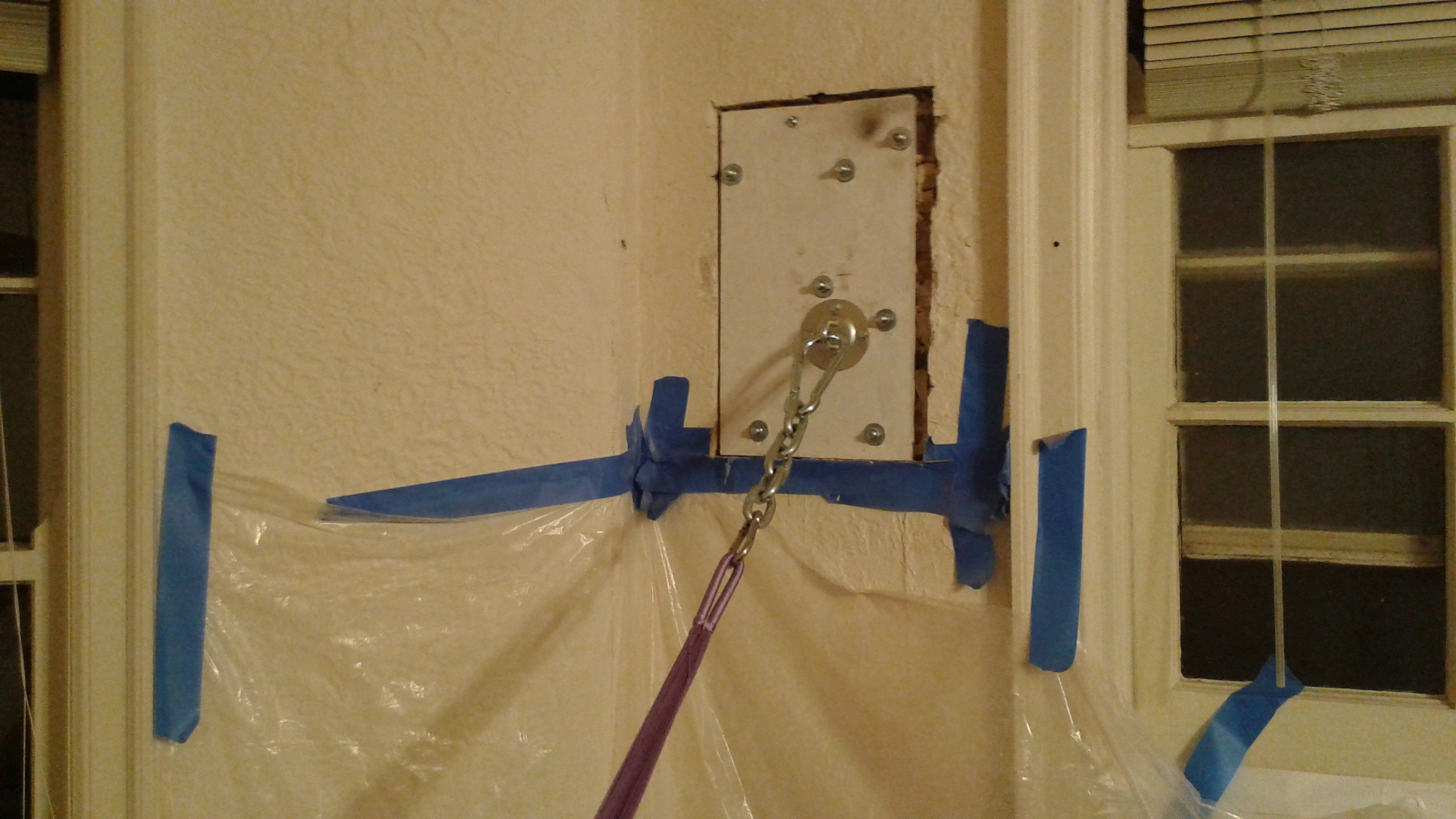

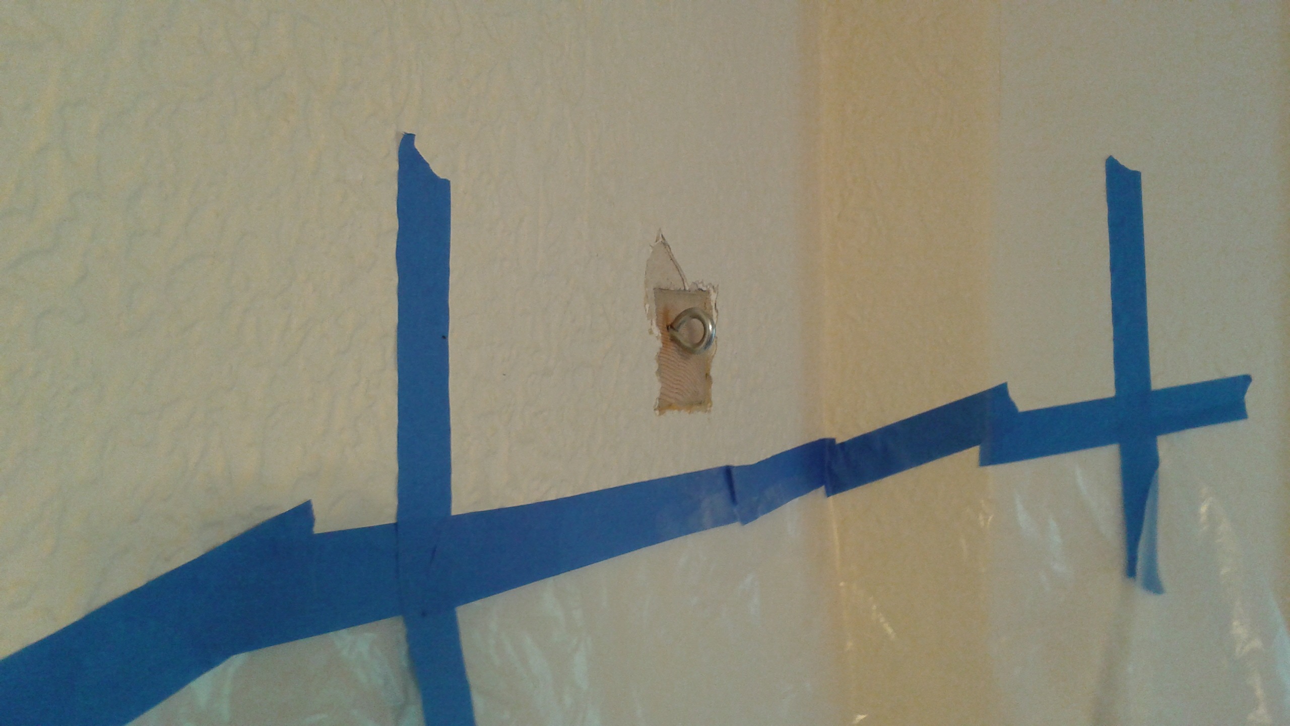

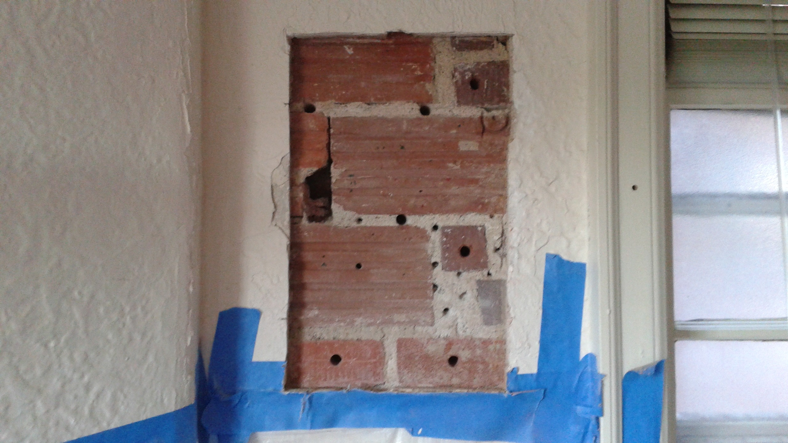

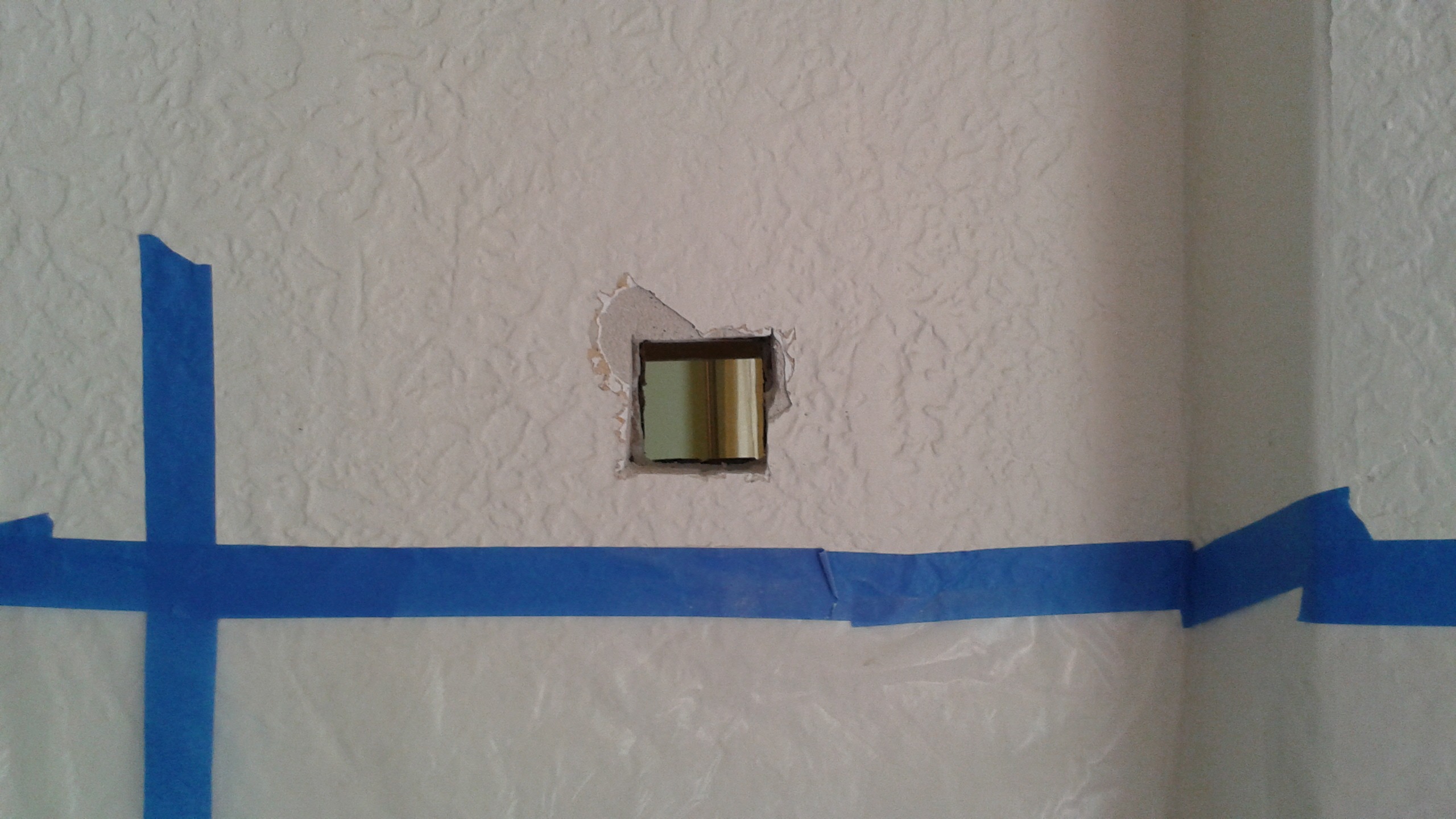

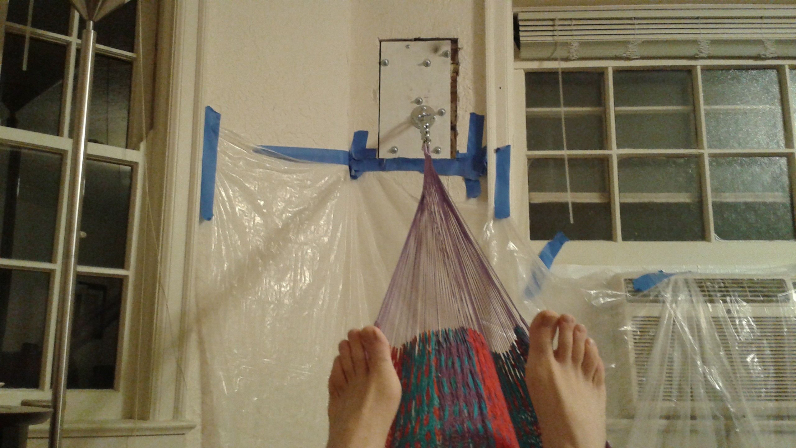

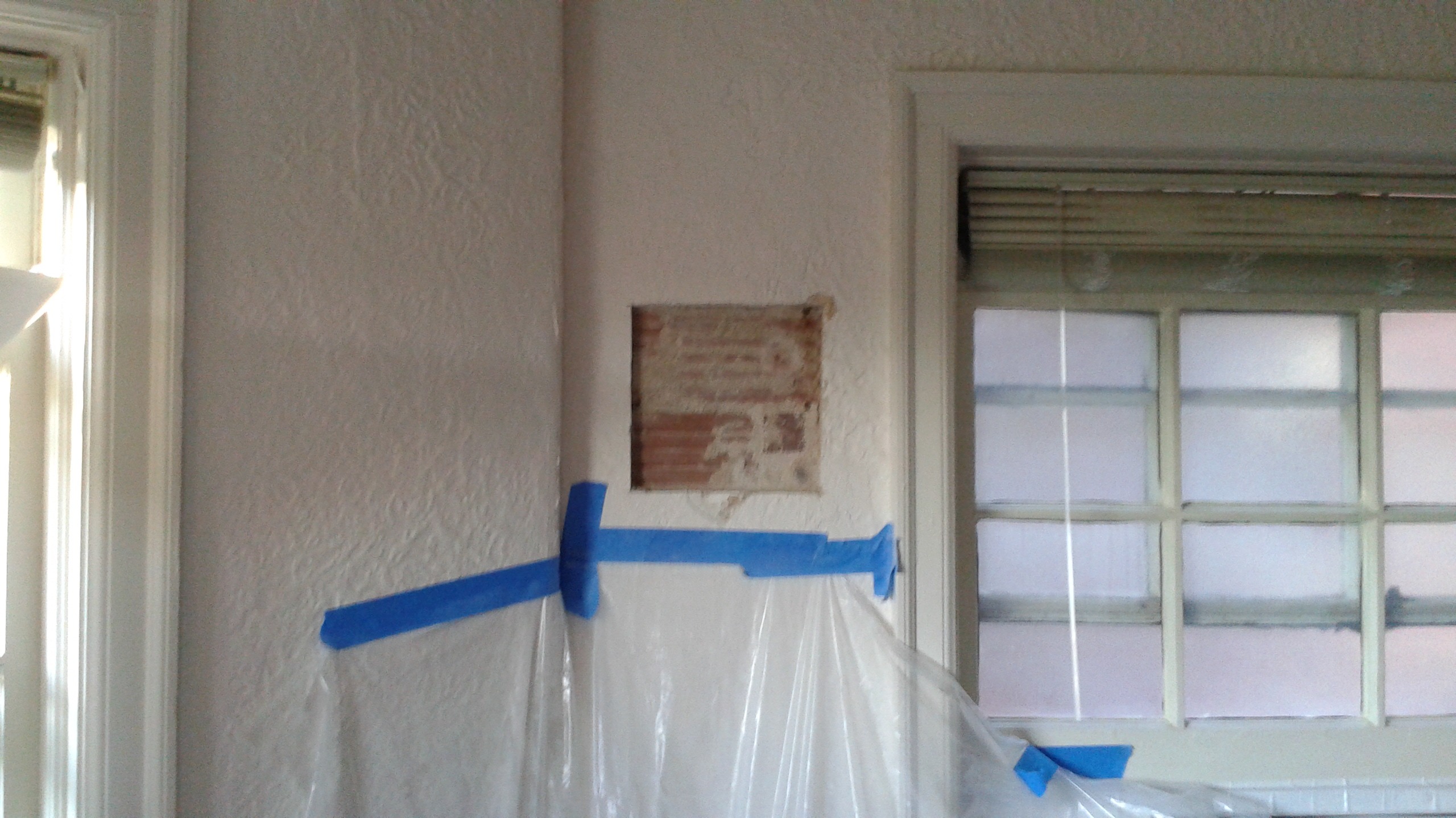

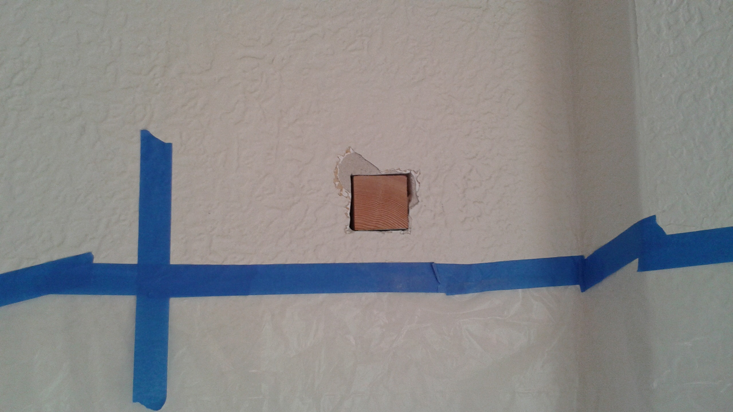

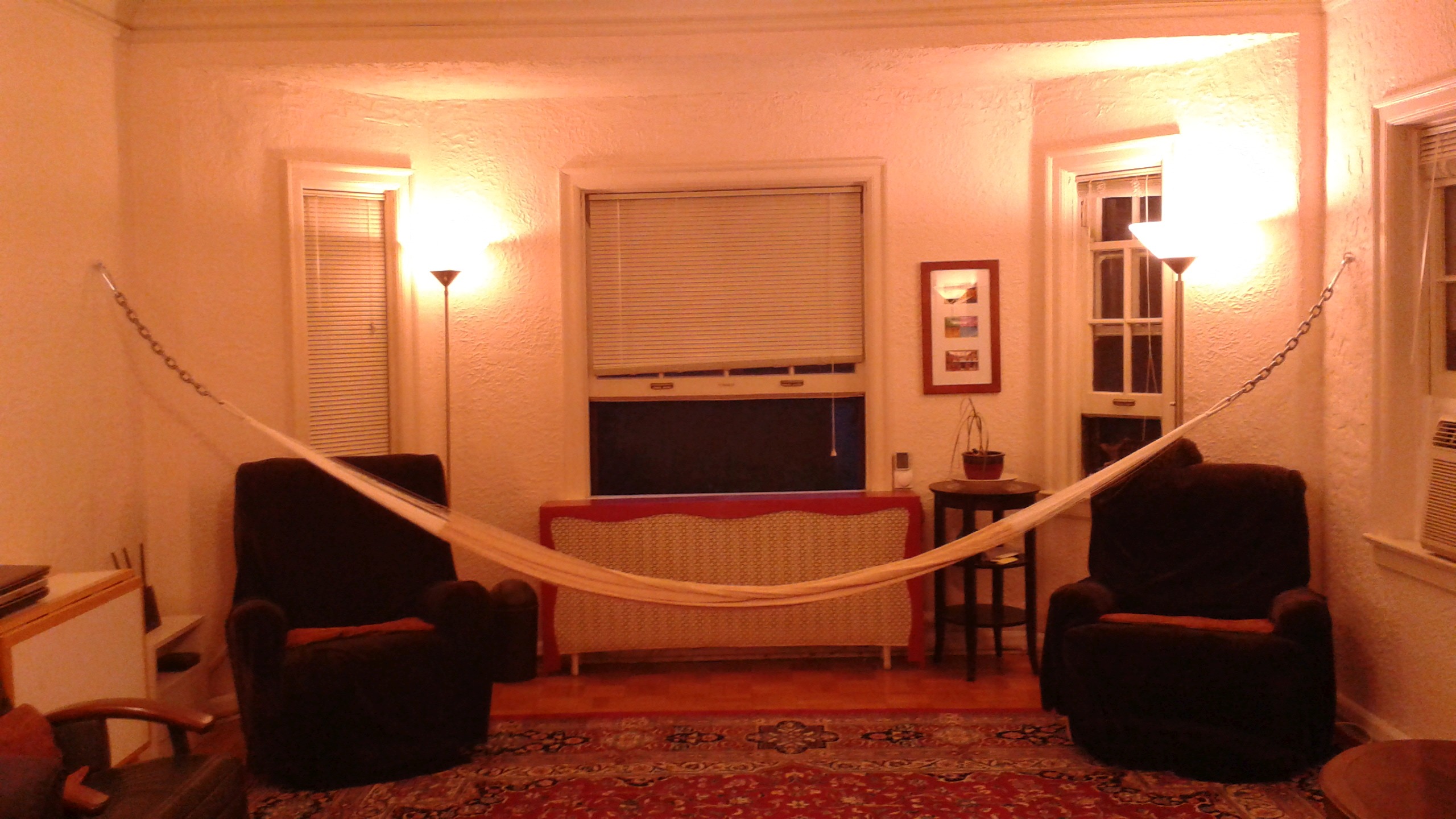

I have always loved hammocks, and for the last 4 or 5 years I have been dreaming of hanging one in my place.
The problem? The walls in my 1929 building have no studs.  It's brick on the exterior, and some studless plaster over thin metal frame in the exterior (structure provided by giant steel beams).
Two years ago I decided to go for it and cut a half dozen holes in my wall only to give up having found nothing I could possibly anchor into and hang a hammock from.  I admitted defeat.
Then earlier this year I got a cheap rusty 10ft outdoor hammock stand for free from craigslist in order to hopefully convince myself that having a hammock in the house was actually not something I would really want.  Only it had the opposite effect and I was determined once again to have a hammock in my living room.
When I explained the difficulty I was having figuring out a way to install a hammock everyone said the same thing -- just use the stand.
Never.  Even a beautiful hammock stand would be an eyesore if it had to be sitting in the living room all the time, even when i didn't want it.  And most hammock stands are serious eyesores.
So after a few weeks of planning and purchasing parts, 3 days ago I began Project Impossible Hammock.
The results after 3 solid days of work, one catastrophe that I hope I've figured a way around (unexpectedly hollow bricks 10 inches deep in exterior wall):
Note that all the crazyness you see below is all done in order to create stable surface to mount the anchors to.
In order to mount to the interior living room wall, I cut a 4x4 hole from the living room into the office, and then put a 4x4 post through the wall flush with the living room wall, and strongly screwed the post into a wall-to-wall bookcase on the other side of the wall in my office:
[attachthumb]
« Last Edit: July 11, 2016, 12:36 PM by mouser »

Hammock doing great so far. cat loves napping with me in it.

Hammock update: It's holding up great and I love it.
