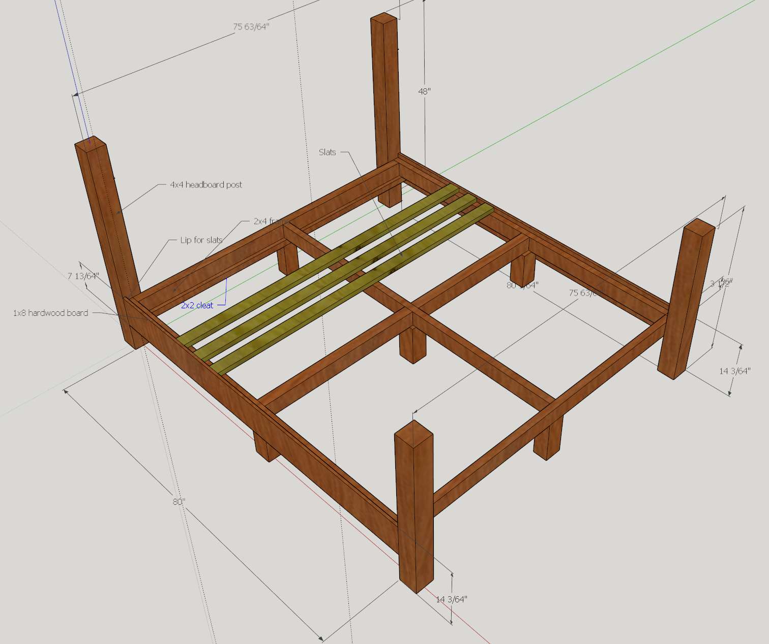

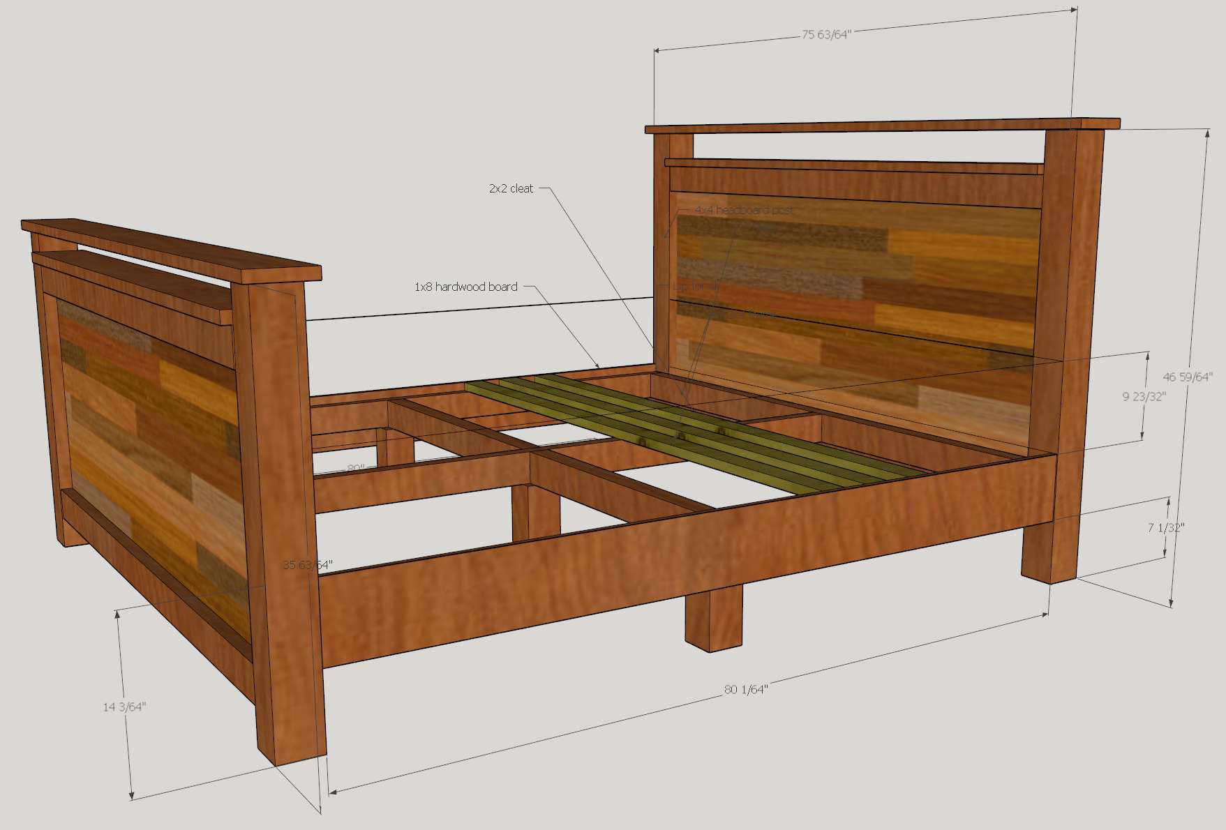

« Reply #134 on: September 26, 2014, 05:25 AM »
Ok i've got my basic structural plan worked out:
I used SketchUp, which can be pretty darn painful to use.. I wish there was something better.  The dimensions are only rough estimates since they are difficult to tweak, but the basic idea comes through.
Main issue I was trying to solve with my plan was to provide rock solid stability and support for a large king size bed (76" x 80") and have the sides look reasonably nice (in my bedroom you can really only see one side of the bed).
Notes: Headboard and footboard will not look like exactly like that, I plan to use reclaimed wood for the inset part; slats will cover entire surface; dimensions are off a little because i couldn't get them perfect.
Inspiration came from the farmhouse bed plans on the Anna White site.
My main concern with the plan is the use of the 4x4s..  I am concerned that they are going to turn out ugly when stained and finished.
« Last Edit: September 27, 2014, 03:53 PM by mouser »

« Reply #136 on: September 30, 2014, 02:46 AM »
Ok i've got my basic structural plan worked out: (see attachment in previous post) (see attachment in previous post)
Consider using glued up 1x boards.

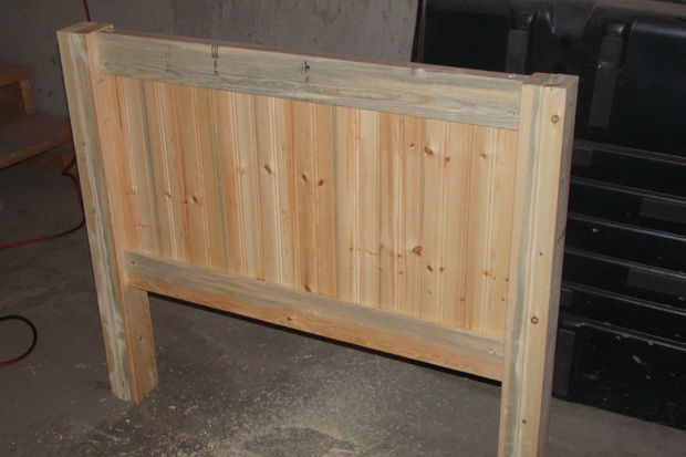

« Reply #137 on: September 30, 2014, 03:07 PM »
Or glued up 2x4's like this. It's not sanded and finished yet.

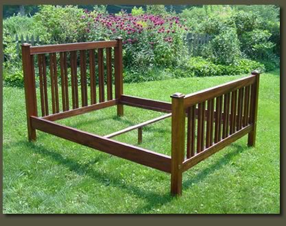

Here's a picture I found of a bed using recycled wood.
Found this site in the UK with some pictures of beds using reclaimed wood.
http://www.eatsleeplive.co.uk/products/bedroom-furniture/beds/
Click on each of the bed types and you can see more close-up details. These have more of a distressed look.
May give you some more ideas.
Re: Software for planning wood bookcases/cabinets/tables etc?
« Reply #138 on: September 30, 2014, 03:28 PM »
Yes, I'm looking at altering the plans to use glued up 1x lumber.  It takes away a little from the chunky feel of 4x4 but it would also let me use nice hardwood 1x3 and 1x4 lumber..

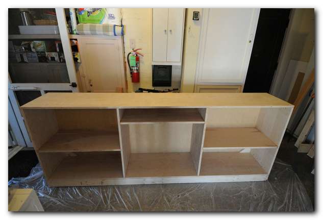

I ended up buying a bed on craigslist that was much nicer than i could have built for a fraction of the cost.  That's the rule I realize now when it comes to furniture, you have to be insane to try to make it yourself and think you're going to get something half as good for 10x the price of buying a nice used piece.

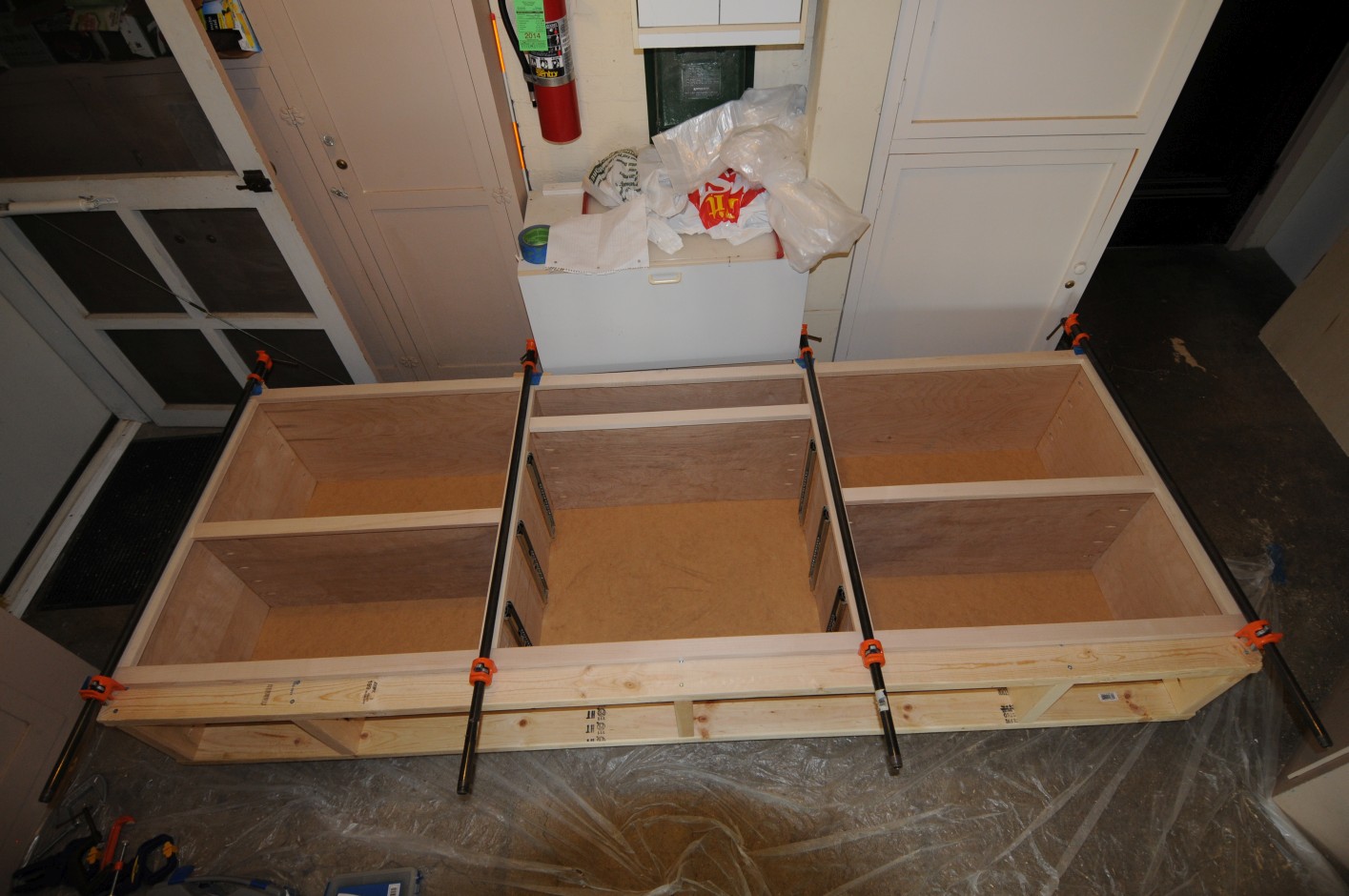

So having absorbed that lesson, a few weeks ago i set out to build an 8ft media center cabinet for my living room, in an attempt to learn how to properly stain and finish a big item  (it's 8ft long, 33 inches tall, 16 inches deep) and how to make drawers.  Please do not ask me why i didn't start on something smaller.
Half way done photo:
Still to do:
  • Add face frame.
  • Add fancy inset/flush drawers (in center area).
  • Add base trim.
  • Stain.
  • Finish and rub out (Lacquer, shellac, or polyeurethane). <-- this is the part i'm most nervous about and have been reading so much about and testing on scrap.. It's hard to do properly when you dont have a place to use a sprayer..
I already regret taking on the project, but nothing left to do now but push forward bitching and moaning the whole way..  I'll post more photos when it's done.

« Reply #148 on: June 12, 2015, 11:09 PM »
Today's progress: face frame cut (but not glued up), and drawer slides attached (very precisely):
I think this might be the hardest part of most projects (for me). Not the most annoying - that goes to all the steps between "built" and "finished" - but there's so many ways to go wrong fitting drawers, lining up the slides, getting them at the right height and projection, and if there's more than one, lining them up with each other. And I can never seem to remember how I did it last time...
Looks good; can't wait to see it finished and installed.
