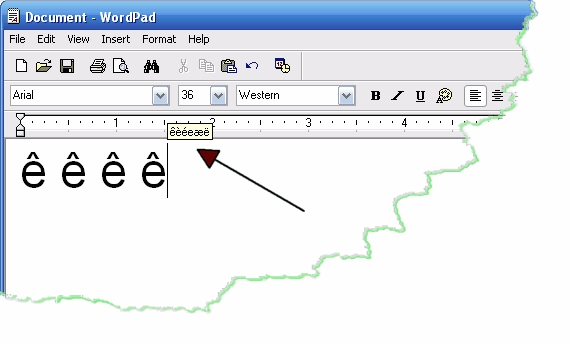

anyway, back to your question.. if Accents is running, you can press the designated key repeatedly until you get to the character that you want.. also, as a visual guide, a tooltip will pop-out showing the available accented characters.. btw i think the screenshot will make things a bit clearer.. ;)

Thanks lanux128 for your patience and efforts but it must be my fault. I use an old 98SE puter to test progs and could not find anything to the contrary on the d/l page.
I also scanned the AutoHotkey site (Changes and New Features) to double check if there is an indication that 98 excluded but found nothing there either.
Only after yr second response I tried Accents on my XP puter and now all fine.

Prep: As you must have already understood, accents uses hotstrings, which are not available in systems older than win xp ;)
