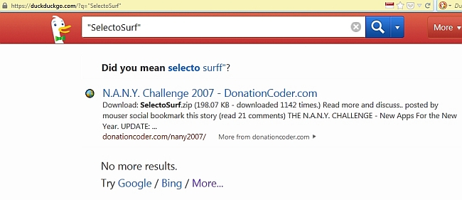

I made a change to the code because my default search engine is DuckDuckGo, so, where the code had:
Code: (autohotkey)
theurl = http://www.google.com/search?hl=en&q=`%22%theurl%`%22
- I put:
Code: (autohotkey)
;theurl = http://www.google.com/search?hl=en&q=`%22%theurl%`%22
theurl = http://duckduckgo.com/?q=`%22%theurl%`%22
(i.e., commenting out the Google search.)

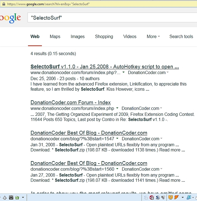

By the way, whilst I was playing about with the code, I compared using the code to search for a string with Google and then with DuckGo, there was an interesting difference (see below). The text I selected for the search was "SelectoSurf":
Google gave 4 results:

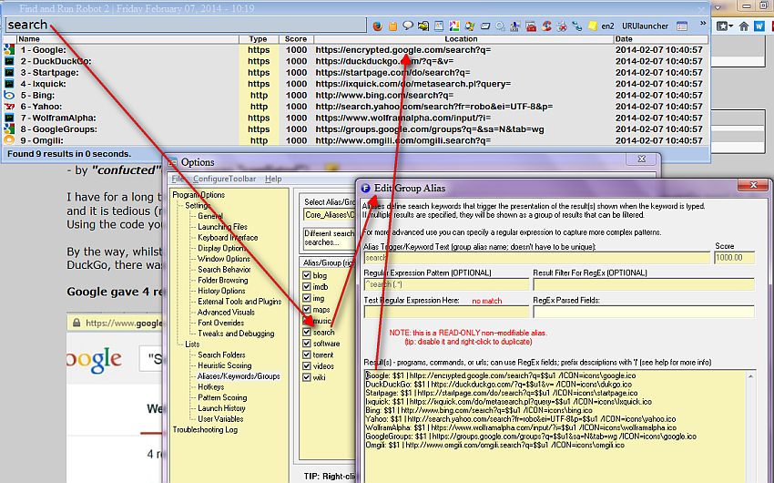

@Contro: Ah, I begin to see why you would be interested in searches.
I am not sure whether you know it, but there are also some rather good search aids in @mouser's FARR - the built-in search aliases:
