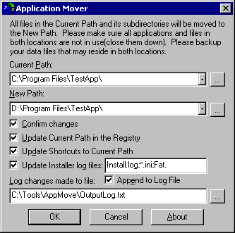

I have not used Application Mover, but I have used other programs by Funduc Software and they are all excellent programs that I recommend often.
Application Mover is a tool that relocates installed programs from one path to another on your hard disk. Application Mover takes files found in the path specified in the 'Current Path' field (see below) and moves them to the 'New Path' path. Application Mover scans the windows registry for references to files located in the 'Current' field and changes those references to the 'New' path. Application Mover also scans all windows shortcuts in the Start Menu and adjusts path references to the new program location. Finally, *.ini and Install.log files present in the original program path are checked for strings matching the old path location. If found, these strings are changed to the new location. Confirmation dialogs are available if you enable the 'Confirm changes' checkbox (see below). If a file is 'busy' and cannot be changed to the new location, a reboot prompt is offered. Pending changes are then completed after the reboot.
Application Mover is designed to move programs from one path to a different path on the same hard disk or to another hard disk on that same computer. The program works on specify paths (folders). For example, you can move: c:\prog\editor -> c:\oldstuff\edit or to a path on a different drive such d:\rare\editor. Application Mover is not intended to be a clone utility. Technical users can put the program to use in other ways but the standard functioning of Application Mover is that the physical drive arrangement & lettering should remain constant on your machine.
