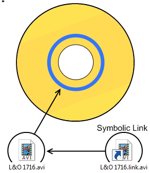

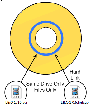

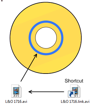

OK, here's a visual representation of what I think Shortcuts (duh), Symbolic Links, and Hard Links (AKA Junctions) are... If it's not clear, the large gold/orange filled circle represents the hard drive, the blue ring is to represent the actual file.
The circle segment around the icon is to show that the file appears to be exactly the same.
Links Visualization 1.3.rar (60.3 KB) < This is the Paint.net file (with layers) that I used to create the images in case anyone wants to show what a Soft Link is/does...
[edit]Oh I see, both traditional shortcuts and symlinks ARE soft links...[/edit]
[modified]
- Added limitations to Hard Link image, updated rar to new "version 1.1".
- Changed Hard Link image a lil', updated rar file to 1.2.
- 1.3 (didn't mean to make so many changes...), changed icon on link of H.L.
[/modified]

« Reply #24 on: May 29, 2007, 07:57 AM »
the various link flavors are useful but each comes with its own problems and limitations
  • shortcuts get in trouble if the real file is moved. Windows XP introduced the Distributed Link Tracking service that helps albeit introducing some extra overhead for all file operations
  • hard links are limited to files in the same partition. Also some programs (eg visual studio) destroy hard links when they save, so you have to watch out!
  • folder junctions can span partitions but only on the local hard disks, no networks. Be careful when you delete folder junctions, you may lose all the target folders. xplorer2 has a J attribute to identify junctions. Some people introduce a coloring rule on this attribute to make junctions stand out and prevent such accidents
  • vista's symbolic links... well i don't know much about them yet :)
xplorer2 can do most link types with its Edit | Paste special submenu. Vista symbolic links in a future version :)
