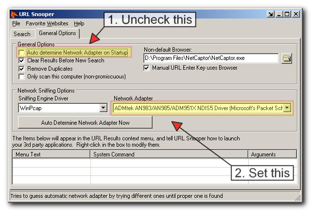

Re: IE7RC1 Problems
« Reply #3 on: September 30, 2006, 04:58 PM »
First go into "Advanced mode" from the File menu, so you can see the General Options tab.
The very first checkbox at top left of General Options tab is "Auto determine Network Adapter on Startup", so uncheck that.
then set the network adapter below.
Try that and let me know (make sure you have latest version of url snooper also of course :)

blarson
  • Posts: 16
Re: IE7RC1 Problems
« Reply #4 on: September 30, 2006, 05:18 PM »
Works fine with Auto unchecked. Thanks for quick reply.
Cheers
Re: IE7RC1 Problems
« Reply #5 on: September 30, 2006, 05:21 PM »
great, i'll try to have the fix for autodetection written soon, it shouldn't be a big problem.

Re: IE7RC1 Problems
« Reply #8 on: November 06, 2006, 03:47 PM »
The IE7 bug should now be fixed with the newest version (2.14.02):
http://www.donationcoder.com/Software/Mouser/urlsnooper/index.html
