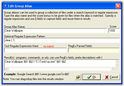

how do i make alias for a program that needs two arguments appended to it?
this is how the command line should be: sp.exe "FFFFFF" "wallpaper.bmp" (the quotes doesn't matter).
and here is how i created (attempted more likely) the alias:
any help would be much appreciated..
Re: how to pass arguments?
« Reply #1 on: September 27, 2006, 08:07 AM »
you don't really need to have the $$2 on the command line, since it'll never be used. the $$1 will contain everything you pass to the alias.
So, if you remove $$2 on the results editbox, it should work perfectly.

thanks jgpaiva, it works ok now.. :Thmbsup: where can find more info on this?
