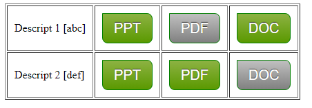

ProCompSys
  • Joined in 2023

It kinda worked.  Here is a list of things needing some work on:
1. It opened the file, but no saved download file.  Anyway for both?
What (kind of) file?
As mentioned before, it depends on the browser how to handle the file... PDFs might be opened right away within the browser as "PDF preview". If all else fails, try a zipped version of the file to download. In my case a "Save as..." dialogue-window was opened by the browser in the first place.
2. How to change background-color to lightgray for 'this.id' button?
The button design ist determined by the browser, if no special format is defined.
But you can change the appearance using CSS-code.
Though in my case, the button WAS changed to light grey (see screenshot).
Dealing with CSS (cascading style-sheets) is not really complicated, but if you're completely new to that matter it might need some work on the basics to it.
See updated source-code below.
I put some CSS-code for the buttons in the HEAD-section,
referencing the BUTTON-class via the .button-section (mind the dot at the beginning!) as such (i.e. for all buttons),
and another class called  .btn1 that only applies to the first button, as the second one has the class "btn2" (all taken from your original template).
If you're not familiar with CSS - at least with the basics - this might not be the best time to go for it, if you need fast results with your button-page... you might get lost in the middle of nowhere. ;-)

ProCompSys
  • Joined in 2023
  • Posts: 11
After a little thinking and re-reading, I now think I understand what you mean by putting filename in TR and filetype in TD/BUTTON:
The filename stays identical whithin a row, just the fileformat changes over the columns, right?
Would be possible, but... this appears a little too much 'over the top' of compressing code and avoiding redundancy.
I could try to make it work... shouldn't be much of a deal... but... really?  :-\
ProCompSys
  • Joined in 2023
  • Posts: 11
Looks like this:
I added another line with filename(s) "def".
To avoid errors when clicking, the filenames have to exist, of course. At least as dummy-files.

      <table border="1">
         <tr class="topic" title="abc">
            <td>
               Descript 1 [abc]
            </td>
            <td>
               <button id="btn1-1" class="button btn1" value="ppt" onClick="dNdB(this.id);">PPT</button>
            </td>
            <td>
               <button id="btn2-1" class="button btn2" value="pdf" onClick="dNdB(this.id);">PDF</button>
            </td>
            <td>
               <button id="btn3-1" class="button btn3" value="doc" onClick="dNdB(this.id);">DOC</button>
            </td>
         </tr>
         <tr class="topic" title="def">
            <td>
               Descript 2 [def]
            </td>
            <td>
               <button id="btn1-2" class="button btn1" value="ppt" onClick="dNdB(this.id);">PPT</button>
            </td>
            <td>
               <button id="btn2-2" class="button btn2" value="pdf" onClick="dNdB(this.id);">PDF</button>
            </td>
            <td>
               <button id="btn3-2" class="button btn3" value="doc" onClick="dNdB(this.id);">DOC</button>
            </td>
         </tr>
      </table>
</body>
</html>

1. okay, will go with files opening AND no saving.
[attachimg=1,msg452209]
[/quote]
I have several <tables> on one webpage, so your general <scripts> and <styles> don't work as stated.  My buttons colors are set as:
<style>
.btn1 {background-color: #4CAF50;} /* Green */
.btn2 {background-color: #008CBA;} /* Blue */
</style>
Which may explain why no lightgray came thru, true?
3 & 4 ... okay will go with what you gave me.
OptimalDesigns
  • (retired) Mathematical Engineer
  • Joined in 2018
  • Posts: 70
Hmm, code looks good, but still need a way to limit <styles> to just this one <table>.
Update!  Passing filename in <tr> working, I think.  Tested using 'alert' function and all look good.  But, a note pops up saying "Pop-up blocked" or something along this line, ideas?  So, no download or opening of file.
Here it is on my website; https://goal-driven.net/download/new.html .
When using different tables, you can restrict your button design to only this table by giving your table an id like
Code
<table id="table01" ... >
and then assigning your css to only that table by
Code
<STYLE TYPE="text/css">
  #table01 button.btn1 {border: 1px solid red;}
</STYLE>
In this example, red borders are only applied to button-tags, that have the class "btn1",
and only if that button in within an element, that hat the ID "table01".
So buttons within other tables are not affected by that css-definition.
<style>
</style>
True.
Try removing the background-style and the browser's standard display for buttons should be applied.

PS: the "button:disabled" feature was the last step in fixing all my problems with buttons.
         .button:disabled {
            background: #808080 linear-gradient(#C0C0C0, #808080);
« Last Edit: July 17, 2023, 12:27 PM by OptimalDesigns »
