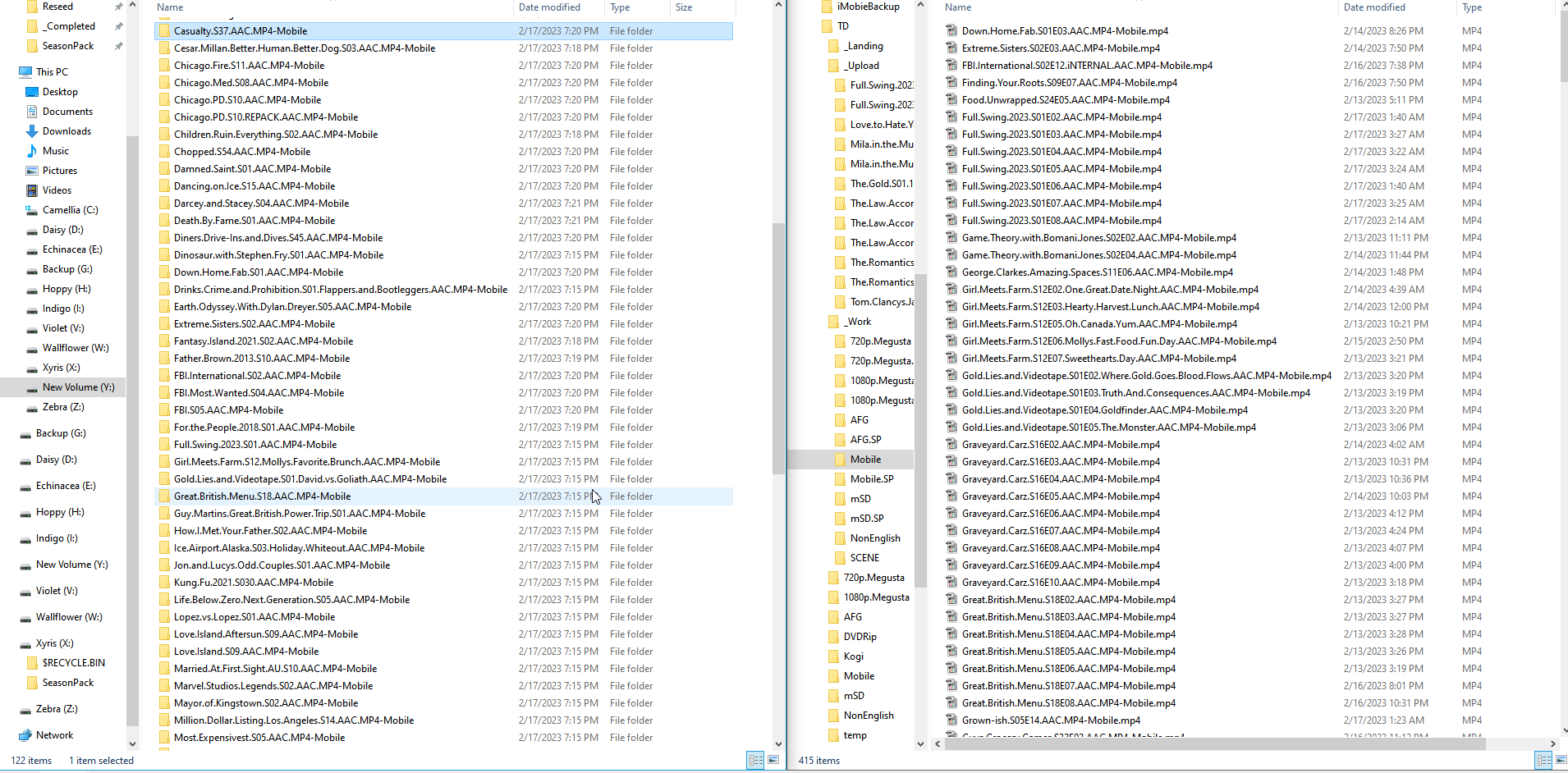

As the image shows I have many files that I would like to move to proper folders. I need these files to move to these folders. This is just a limited example as I need all files to be moved into their proper season folder.
Code
Y:\TD\_Work\Mobile\Game.Theory.with.Bomani.Jones.S02E02.AAC.MP4-Mobile.mp4
Y:\TD\_Work\Mobile\Gold.Lies.and.Videotape.S01E05.The.Monster.AAC.MP4-Mobile.mp4
Y:\TD\_Work\Mobile\Graveyard.Carz.S16E02.AAC.MP4-Mobile.mp4
Y:\TD\_Work\Mobile\Full.Swing.2023.S01E08.AAC.MP4-Mobile.mp4
Y:\TD\_Work\Mobile\Game.Theory.with.Bomani.Jones.S02.AAC.MP4-Mobile
Y:\TD\_Work\Mobile\Gold.Lies.and.Videotape.S01.The.Monster.AAC.MP4-Mobile
Y:\TD\_Work\Mobile\Graveyard.Carz.S16.AAC.MP4-Mobile
Y:\TD\_Work\Mobile\Full.Swing.2023.S01.AAC.MP4-Mobile
The script needs to be able to read the files name to the season:
Full.Swing.2023.S01
and then move it to the folder:
Full.Swing.2023.S01.AAC.MP4-Mobile.
I have looked through many websites today and many that I found just want to make a folder with the file's name instead of moving it to a season folder.
This is for Windows 10 batch file. Making folders is not necessary but if possible adding that would be even better at saving time.
Also wanted to add that I would be just running this inside only one folder. No need for paths. Just move files into designated folders.

Starting folder:
After using your program:
What is actually needed.
It is getting caught on the names of the episodes and creating unneeded folders. I am guessing it looks for E** and then removes it to get a folder name.
Maybe removing everything from E** through the common next characters. 480p/576p/720p/1080p/2160p/XviD/HEVC/Rereip/BDRip/AAC/DVDRip/PDTV.
Might be better if they fail if it is not between E** and 480p/576p/720p/1080p/2160p as these are the most common.
Since I will be using this pretty much in the same directories at all times think you can have it create an INI file that can be edited for now to see how it works on my end at catching the names?
And these files failed to be move with the program.
