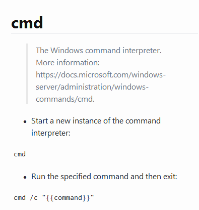

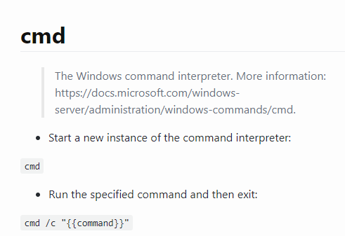

One of my CSS issues was that FARR did not show the background color of inline code blocks in the HTML I tested with.
How it looks in Firefox/Chrome/Edge
How it looks in FARR
I tracked this down to the CSS using the color function RGBA
edit: My mistake. The correct RBGA() compatibility page says IE9+ is supported, IE6-8 is not.
Adding this line to the HTML
Code
<head>
<meta http-equiv="x-ua-compatible" content="IE=edge" />makes FARR show the code element background color just like in the external browsers.I found that on https://stackoverflow.com/a/22964400 , with much more background on https://stackoverflow.com/a/6771584 .
So, workaround achieved, I suppose. But I'm unsure what other changes in how FARR renders HTML that line causes. Does it make FARR use Edge? Or adjust the IE1 version/mode used? I hope for feedback from mouser or others on this topic.
edit: Answering myself. We can check browser document mode by adding this line to the HTML document, which shows a popup when FARR renders it
Code
<script>alert(document.documentMode);</script>Findings: Before adding the "<meta ..." line my FARR used document mode IE7. After adding the line FARR uses IE11. That explains why the CSS RGBA() function, which required IE9+, only worked after adding the line. Note also that the "IE=edge" part does not mean that the browser Edge is used, it instead means that the newest available Internet Explorer document mode will be used. Which is IE11 on a fully updated Windows 10 PC today.
