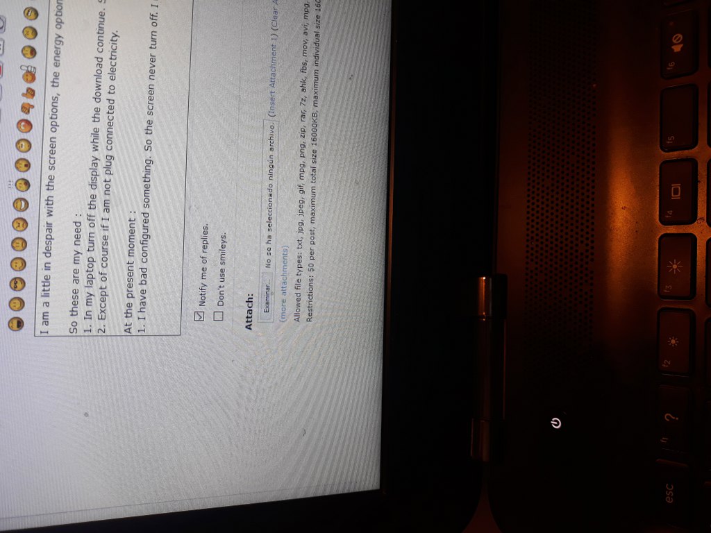

I am a little in despair with the screen options, the energy options.
So these are my need :
1. In my laptop turn off the display while the download continue. So don't enter in suspension, only turn off the display after a time.
2. Except of course if I am not plug connected to electricity.
At the present moment :
1. I have bad configured something. So the screen never turn off. I usually put in mininum of brillance with the keyboard option . F2 key .
2. I am using an app Radial menu v4 for turning off the display before I leave, but sometimes when I come back the display is on.
I will edit the post in a while after locate the display configuration, and energy configuration options.
Best Regards
attached files about my energy configuration. It express 10 and 15 minutes, but my display never autoturn off...
AsusPortatil - 17_10_2020 , 17_12_08.pngAsusPortatil - 17_10_2020 , 17_12_26.pngAsusPortatil - 17_10_2020 , 17_12_42.pngAsusPortatil - 17_10_2020 , 17_13_56.png
so i have something disconfigurated sure. In some place I put not to turn off the display ...
