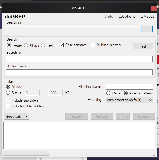

dnGrep - https://dngrep.github.io
dnGrep allows you to search across files with easy-to-read results. Search through text files, Word and Excel documents, PDFs, and archives using text, regular expression, XPath, and phonetic queries. dnGrep includes search-and-replace, whole-file preview, right-click search in File Explorer, and much more.
Features:
  • Search across text files, Word and Excel documents, and PDFs
  • Search for files in archives - zip, 7z, rar, jar, and many more
  • Search using text, regular expressions (regex), XPath, and phonetics
  • Many search filter options
  • Search-and-replace, including undo
  • Whole-file preview
  • Right-click to search in File Explorer
  • Move/copy/delete result files
  • Open line results in a custom editor, like Notepad++
  • Bookmark search patterns for later use
  • Try out complex searches in the Test window
  • Save search results
  • Light and Dark themes
  • Much more!
Just a note: The plugins for Word, Excel, and PDF are search only, no text replacement.
« Last Edit: June 18, 2020, 11:29 PM by 4wd »
Looks a lot different from when I tried it out a few years ago.  I might have to give it another look!
Update: Found out I still have the last version that I used installed- from 2009!
Definitely a lot different!
