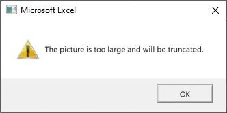

Since a few days, whenever I try to copy more than a few cells in excel, I keep on receiving the error "the picture is too large and will be truncated". After this, excel hangs. It mostly recovers but every now then I am left with no option but to force close it. The problem disappears, once I exit CHS.
Is there an option within CHS that I need to change in order not to get this error?
Thanks.  8)

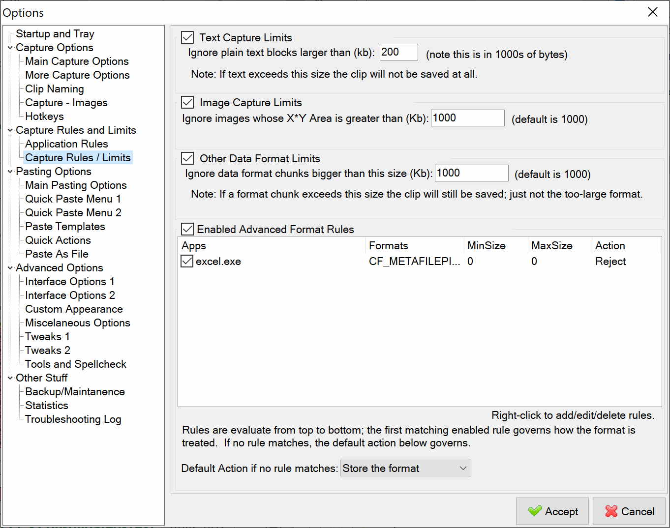

This new version will surely not solve the problem per se, but it now will skip trying to even look at formats that are excluded in the advanced rule section.
Once installed, add a rule as follows:
This should prevent CHS from trying to grab the CF_METAFILEPICT format, that causes excel to freak out.  It shouldnt have any other bad side effect since CHS can still see the alternate image file format.

Can you check the excel rule in the options, AND make sure you are running the latest CHS (2.54).
I've uploaded a new alpha (v2.55); this one should also solve the excel problem but even without a rule added, based on the fact that it knows to ignore the CF_METAFILEPICT format if it finds an earlier better format (CF_ENHMETAFILE).
The solution is still basically the same, to avoid trying to grab CF_METAFILEPICT from excel, it just avoids it automatically now rather than needing a custom rule.  So it should solve the problem out of the box for everyone.

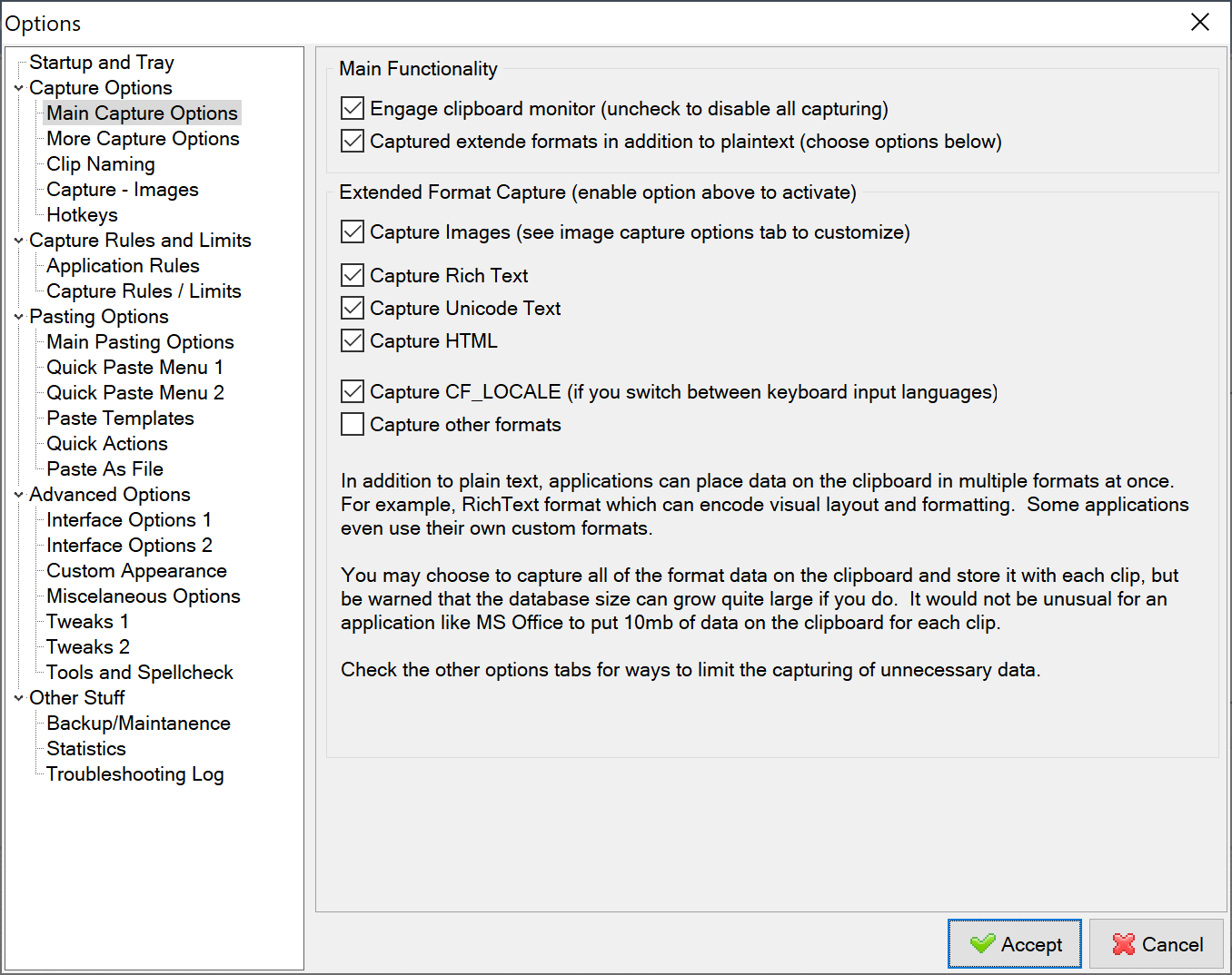

Following is the screenshot of the 2.55 rules interface:

After disabling the "Capture other formats" checkbox under "Main Capture Options" in CHS, I am not getting the error anymore. I still don't know why the error disappeared earlier, but am happy for now. :-)
Unfortunately, that's not a good solution, as that will tell CHS not to even bother trying to capture the extended clipboard formats that hold the most useful formats for excel.
