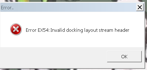

Just reporting that I was consistently getting:
"Error EX54: Invalid docking layout stream header"
- at every CHS start, and it always displayed the default layout - not the last layout it had been shut down with. So the last selected layout was not "sticking".
I then did a search and found this discussion thread and fixed the problem thus:
  1. Shut down CHS.
  2. CHS is installed as "portable", so I went to the folder: C:\UTIL\Windows utilities\FindAndRunRobot\Plugins\Clipboard Help+Spell\PresetViews
  3. There, I deleted all the files with names prefixed "Last".
  4. One of the files (I think it was Last.preset.dock) would not delete, so I used Unlocker to complete that task.
To check if the fix had worked:
  1. I then started CHS and it displayed the default layout and gave no error message.
  2. I selected one of my preferred layouts and then shut down CHs and restarted it.
  3. The last (preferred layout) was displayed, and no error message was given.
- so the fix had worked a treat - thanks.
I think the error had started occurring following a bad system crash.

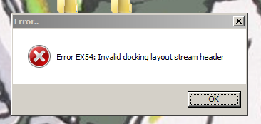

I am getting this error again today. Just started again. I guess I wrote about it several years ago and I have not had or at least not been notified of it until just now when I started up my computer.
Yesterday I suspended the noises from Automatic Screen Shotter. Now, I do not see its icon in the taskbar.
When I booted up I received this message "Error EX54: Invalid docking layout stream header"
imscottb
I'm not sure what happened that would cause that error, but I know it must mean that your docking layout files are somehow corrupt.
If the problem persists after you exit and restart CHS, you should be able to solve the problem by exiting CHS and then deleting the files:
PresetViews\Last.preset.dock
PresetViews\Last.preset.grid
Which should be subdirectories of your settings directory, which will be under like MyDocs\DonationCoder\ClipboardHelpAndSpell
