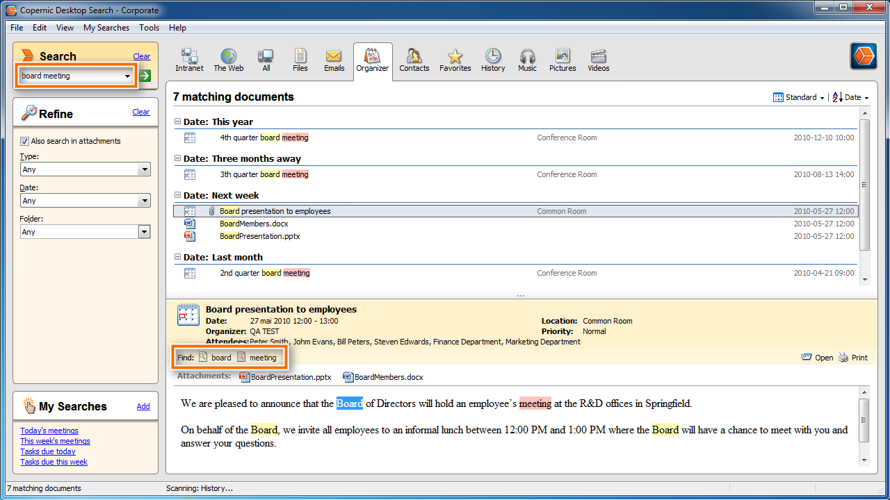

Have you guys tried Copernic Desktop Search recently?
I must say that I particularly like those "jump to search term occurrence" buttons and the multi-color highlighting:
It is a mystery to me why not every search tool has this very feature.

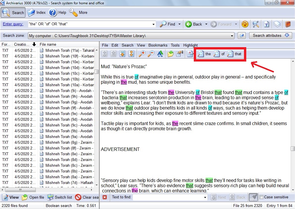

Archivarius does both of these things too.  See "Screenshot #1" attached here.Screenshot #1.jpgScreenshot #2.jpgScreenshot #1.jpg  You can even change the colors around.
The only thing it can't do which would be really helpful for me is to allow the user to distinguish the regular search hit color and the Find on Page hit color.  In other words, if you choose pink for the results / hit color, then both your normal search (in the search bar) and anything you type on the Find on Page locator will be highlighted in pink.  You can't make different colors between the two.  That's a bummer.
But there is a workaround that gets as close to this as I could find--viz., you can designate the regular search hits to be underlined, while the Find on Page locator remains non-underlined.  Then, even though the hit color is the same, you can have some distinction between what your primary search result is, and what you are seeing in the Find on Page.  See "Screenshot #2" (attached) for demonstration.

Archivarius [has "jump to search term occurrence" buttons] too.
Yeah sure. That's why I can't switch to any program that doesn't do that. Like X1 Search, Lookeen, DocFetcher or FileLocator Pro, who all don't have that feature.

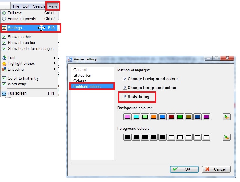

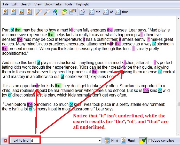

-Yatom (Today at 12:03 AM)
How did you do that? I can't find an option like this in Archivarius.
See attached screenshot.

Thanks Yatom, found it.
BTW, I also like the "Found Fragments" view setting very much, which I just discovered today.

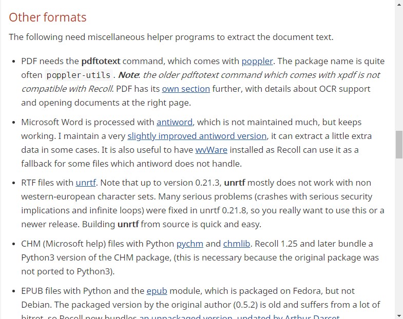

I know some people who swear by recoll.,,
Thanks, Sphere.  I've never used or heard of Recoll.  However, it says on their website that PDF, WORD, RTF, and other file types require some kind of special add-on (apparently a different one for each one of these).  Take a look at this screenshot.
Archivarius indexes all of these "natively"--actually about 200 file types (most I've never even heard of).  PDF's are indispensable to me.  They make up the majority of my primary library.  I could understand one or two special file types requiring an add-on of some kind, but such basic and ubiquitous files as PDF, WORD, and RTF should be indexable natively (for my needs).
My questions about Recoll would be the following:
1) Does it have a proximity / vicinity search, like: "President (WITHIN 10 Words) conference"  If so, can the user customize the range (10 words, 25 words, 100 words)?  Archivarius is limited to 10 words apart, but I've jerry rigged a way to get up to 20 words apart.
2) Does it have a Find on Page locator?
3) How does it handle large files (500MB+)?
4) Does it handle Hebrew and other unicode languages?
5) Does it find sticky notes in documents?
And there are other questions I'm not thinking of right now.  Certainly, it has Archivarius beat on Support, since Archivarius literally has zero.  Archivarius does all of these except for #5, although I said in a recent post that it is very oddly finding *some* of my sticky notes.
