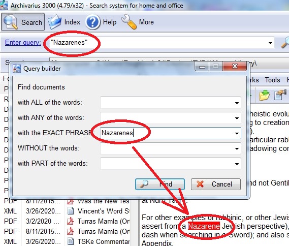

@YannickDa: Thank you for such a speedy answer, HOWEVER it is incorrect.  Even though it says "EXACT MATCH" it really isn't.  Just try it yourself.  In fact, all it does is add "" marks around the word or phrase, which you can do manually yourself in the regular search field.  But it will *not* find the exact search, even though it claims it will.
Case in point: I just searched "Nazarenes" (plural) using your suggestion, and it returned hits with just "Nazarene"  This is problematic because adding the "s" on the end gives the word a whole different connotation.  So basically, with an index of 10,000 files, I'm getting hundreds or thousands of false hits, just because the program can't tell the difference between "Nazarenes" and "Nazarene."
Correct me please, if you find another way; but friends, I've tried for a *month* to manipulate or figure out a workaround to actually do an *exact* search, and the program simply won't do it.  Yes, it *claims* to do "Exact" search, but bottom line, it does not.

Great news!!!  Archivarius *can* do a true exact search after all, despite the fact that...
1) The Archivarius website under FAQ gives an explanation for why the developer chose "morphology search" for the program, giving the impression (as I posted previously) that a (true) exact search isn't an option.
2) Nothing is said anywhere on the website, nor in the Help section of the program itself, which explains that a true exact search can be done.  Not one word anywhere to the effect of what I'm about to share.
3) The internet, including sites like this, says absolutely nothing (I've searched a dozen times).  Oddly enough to me, no one else cared about this, apparently.
4) The developer never responded to my multiple emails from multiple addresses over the course of a month (sent to Support, Sales, Contact, etc.)
So, here's the good news, finally.  The "problem" was in a deep setting located in the program (again, without any explanation).  If you open Archivarius, select an index, and then select "Settings," there is an option titled "Morphology."  The program is defaulted to create an index in "morphology" mode, which dictates in turn how the search will function.  Hence, if you don't want the program "thinking" for you, and adding "s" "es" "ing" and all other data to your search, you must build the index without this morphological setting.
Thankfully, I remembered the mention of "morphology" from the FAQ on the website (again, though it gives the impression that *there isn't any other option*, and I decided to give this thing a whirl.  And thank God (truly), it worked.
So thanks all of you for your helpful suggestions.  If you are also suffering from the lack of a true exact search, simply change this setting, and then rebuild your index.

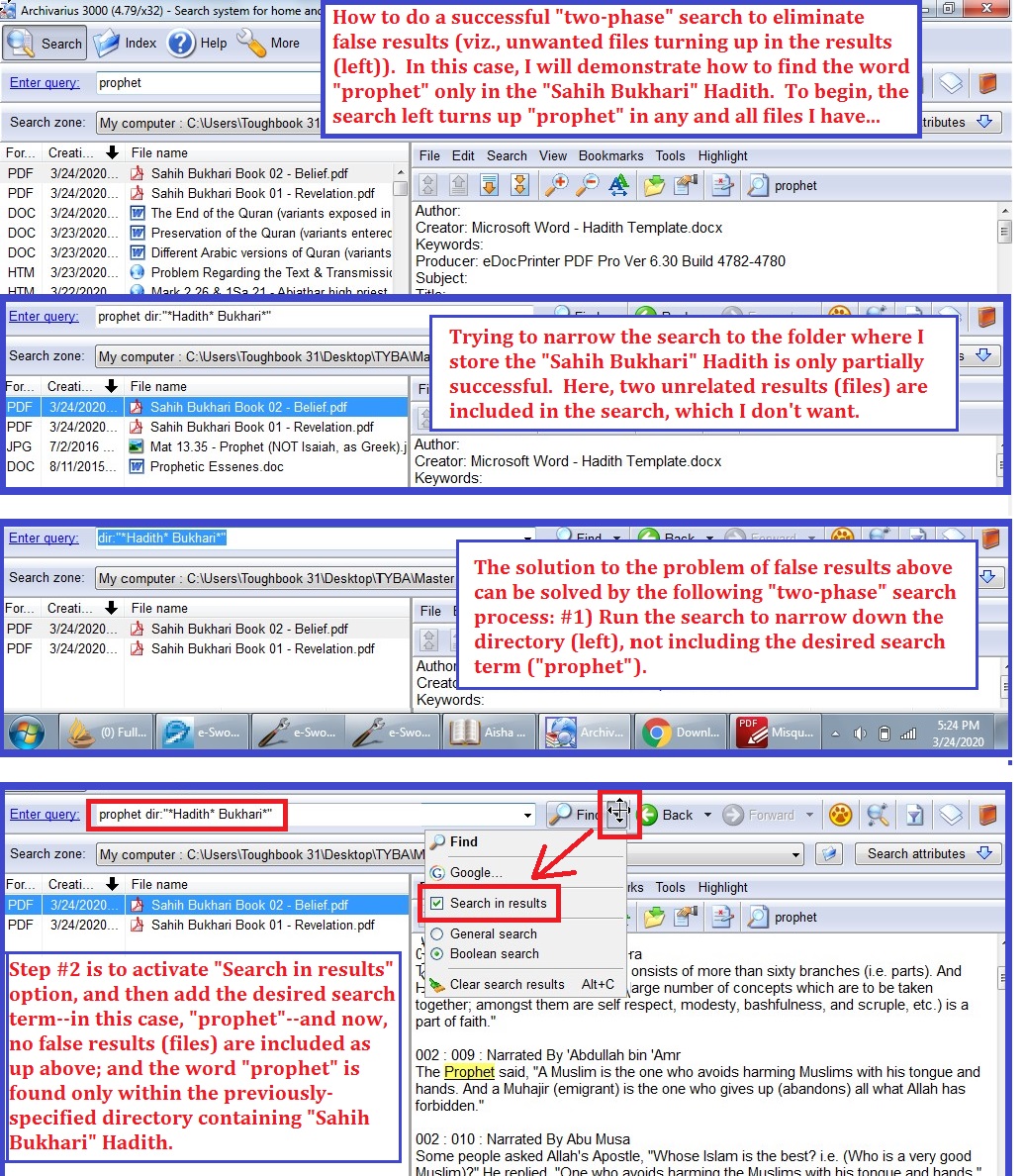

Also, after hours of testing and experimenting, another tip for any of you who, like me, are chaffed by the fact that the proximity / vicinity search is limited to only 10 words apart: you can try inserting "filler" terms between the two primary terms you are searching for, and if any of those "filler" terms exist, then it will allow you to extend the range beyond just 10 words apart.
For instance, if I search [president...issued] it will find the these words as long as they are within 10 words from each other.  But that isn't a great enough range sometimes.  So if you search [president...and...issued] or [president...if...issued], and if the middle term indeed exists between the other two terms, then the range is counted between all three terms, and it can potentially increase the range of the two primary terms to 18 words apart instead of only 10.
Note: this is hit and miss, and the worst apart about Archivarius (now that I figured the exact search thing) is that wildcards (*/?) can't be used in a proximity/vicinity search.  (What!?!)  Moreover, you can't nest an OR search within a proximity search either.  If you could, then you would be smart to do something like [president...(did, and, if, so, to, that, but, a, the)...issued], and it would increase your chances of extending the search range beyond just 10 words apart.
Thankfully, despite the grievances above, the program *does* let you use OR terms *outside* of the proximity/vicinity search, so you are able to try something like this: [president...issued] OR [president...did...issue] OR [president...will...issue] OR [president...and...issued]

Something else I never really have figured out is searching for files only under a certain path (say, like D:\Documents\Project_ABC).I'd be very thankful for ideas on how to do this, should it be possible.
The instructions under "Help" in the program state the following:
dir:"c:\folder\‫"״‬
Searching in specified path. This path may contain mask characters like and ? . For example, dir: c:\* will search all files on disk C: in all sub-folders. But dir:"c:\" will search files in root of C. without sub-folders. It is possible to specify several parameters in single query: dir:"c:\‫ "״‬dir:"d:\folder\*".  Searching by file name without full path. This name may contain mask characters like "‫ "״‬and "?". It is possible to filename:"‫״‬report‫ "״‬specify several parameters in single query.
But for what it's worth, I have always received false hits when trying to narrow a search by filename or by directory.  Given that the developer hasn't responded to any of my inquiries, I've had to stumble my way through, figuring out things as I go.  I therefore built myself my own "help" file for this program, containing numerous screenshots as reminders on limitations, bugs, and best use.

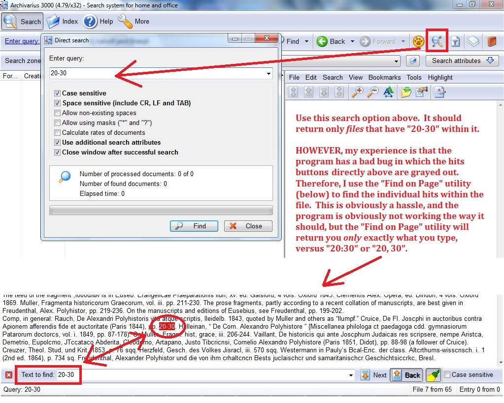

I have a helpful demonstration (screenshot) of how to do directory searches, while also eliminating false hits.  See this attachment, and hopefully this helps.

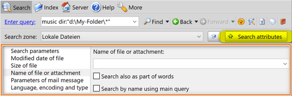

Edit: I just tried to search with this string
Code
music dir:"d:\My-Folder\*"
However, it doesnt find any files in or below the 'My-Folder' path this way. Instead, it finds all files anywhere that contain "music" in the file name.
How weird is that?
Edit 2: OK I now found that everything under "Search Attributes" (which I never understood anway) must be cleared in order for the directory search to work:
In this case it doesn't even give any "false positives" from other directories.

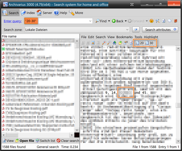

What I've been trying to figure out for a long time with no success is how to search for exact phrase matches containing hyphens like for example "20-30".
Also, when searching for any exact phrase matches, it never seems to be possible to easily locate them in the preview pane, because Archivarius wouldn't create find buttons for the phrase you looked for. Instead. it creates buttons for each single search term inside the search phrase, see screenshot:
It can be seen that although searching for "20-30" as a phrase, Archivarius found the phrase "20, 30".
Additionally, it didn't create a find button for "20-30" in the preview pane's toolbar, but instead two separate buttons for "20" and "30". These are not of much use because the separate search terms "20" and "30" occur many times throughout the document, which makes it very difficult to actually locate the occurrences of the search phrase "20-30" in the preview pane.
Thanks for any hints or ideas how to improve exact phrase search!
Sadly, from my months of experience racking my brain with this program, it doesn't seem to be able to do this *directly.*  However, for an indirect workaround see attached.
