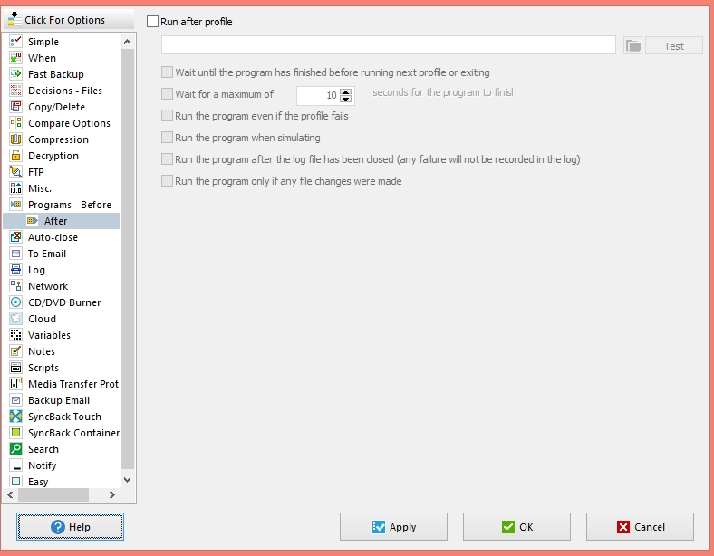

I am trying to speed up my monthly archiving manual work by doing some automatic things. I am on Win8.1 64 bits home.
[0) I am using Synckback pro V8 to periodically move files (zip, rar, pdf, jpg and png) to a folder named "folder1".
When this Synckback pro profile has run, it can run a program (see image [attachthumb=#]) after the above files has been moved ("Run after profile").
I have discovered that I can run a .bat file which itself run several bat files (https://stackoverflow.com/questions/1103994/how-to-run-multiple-bat-files-within-a-bat-file). ]

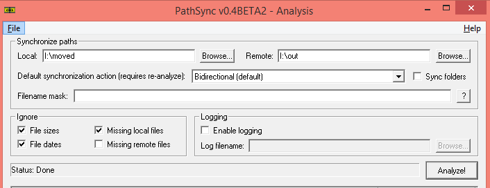

For Finereader, I am sorry I was not clear enough. There is no need to send a CLI command to it as I use its "Hot Folder" feature which allows me to run automatically every day which is fine for me. ;)
(For the little story : in Finereader I have 3 folders : folder_in (original pdf files) , folder_moved (when Finereader has OCRed the file it moves it from in to moved), folder_out (when OCR is done)
Then in pathsync I use the following settings : see [attachthumb=#]. After writing this I realize that I forget one more step as it has already appeared to me in the past ! : I need to check if Finereader deletes a few pdf files without moving them to folder_moved or simply letting them in folder_in ! )
