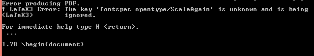

I did some Pandoc tests but I keep getting the same error :
Code example:
Code
pandoc C:\prog\pandoc\pandoc-2.7.1-windows-x86_64\t5\20170611_074645.htm -t latex --pdf-engine=xelatex -s -o C:\prog\pandoc\pandoc-2.7.1-windows-x86_64\t5\20170611_074645.pdf
Error:
I did some google searches but I am stuck!
Thanks in advance ;)

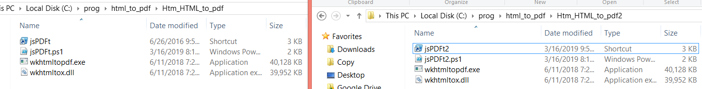

Something quick in PowerShell using wkhtmltopdf, (put the executable in the same directory as the script), and Chrome.
Recursively converts .html, .htm, and .mht to PDF files.
Btw, if it looks familiar, 90% came from here.
Run it from a PoSh console or use a shortcut with the following as the Target, (assuming shortcut in the same folder as the script):
Code: (text)
%SystemRoot%\system32\WindowsPowerShell\v1.0\powershell.exe -sta -NoProfile -ExecutionPolicy Bypass -File "CTP.ps1"
CTP.ps1

Wow 4wd! Thank you ! ;)
It is working for html and htm but not for wkhtmltopdf as it can't convert from mht to pdf.

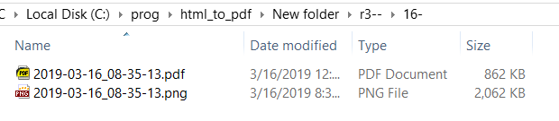

I did some tests (one old month saved with IE and one old month saved with Firefox) with your updated script and it works fine for html and htm files at the same time. ;)
As I have quite some files converting htm and html files should run for about a few months! But it seems that I can speed up the converting if I run several (copied and renamed -shortcut included ) powershell instances. ;)
I have added a few manual steps :
Modified from https://stackoverflow.com/questions/27897669/powershell-remove-files-smaller-than-500bytes-in-directory-recursively , here is the Powershell code that I use to remove the pdf files that are smaller than 3ko (created by wkhtmltopdf, they in fact contains no text in my case):
Code
Get-ChildItem $path -Filter *.pdf -recurse -file | ? {$_.length -lt 3000} | % {Remove-Item $_.fullname}
Then I use the freeware "Remove Empty Directories" http://www.jonasjohn.de/red.htm which removes..all empty directories in all the subfolders. It is very powerful IMHO. ;)
I don't know if this is possible but it would be great if the Powershell could exclude converting htm and html files that are smaller than 3ko ? Thanks in advance ;)
