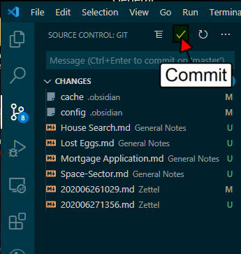

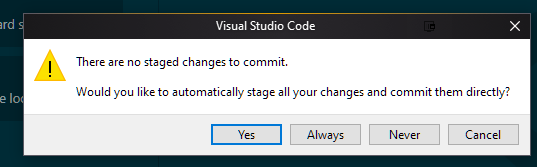

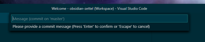

In Visual Studio Code in the sidebar there should be an icon for source control.  The shortcut is CTRL+G G.
I've enclosed an image of my sidebar with the button highlighted.  Once you click that all should become clear.
One thing that might not be clear is what you put in the source textbox when it asks you for it- if you go back to github in your repo, at the top of the repo there should be a button that says Clone.  Click it, and copy the url for https (it should be the default one selected when you click the drop down).

If you were able to proceed from that point, then in order to sync, go to that same button/tab, and click the button to commit and give it some reason that you're commiting.  It should commit to the git repo.  Step by step of me doing it today...
1. Click the highlighted button
2. Click Yes on the Dialog that appears
3. Enter a label that describes (I usually for these use the date and zettel update, i.e. 2020-06-27 Zettel Update

« Reply #549 on: June 28, 2020, 01:27 AM »
Thanks again Wraith. Very helpful. I reckon it's working now, thanks to you.
