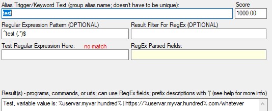

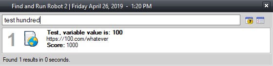

Then, said variable can be accessed via %uservar.myvar.hundred% from inside the Alias. I've created a test alias to illustrate how this would work. Here's the test configuration:
Fig1. Setup of an Alias that uses a raw variable
And here's how the test triggers the variable:
Fig2. Using the previous Alias. Please, note that the "hundred" string is actually
not necessary, it could've been any other string (or even empty)

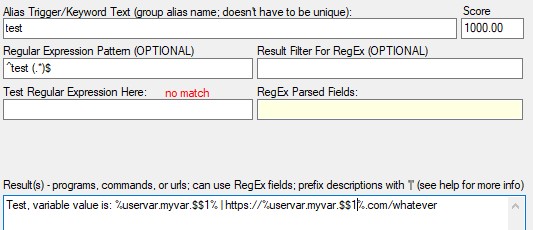

So far so good. No issues here. My problem comes when I want to use a regular expression captured group to access a variable name. Here's where things get dirty:
Fig3. Setup of an Alias that uses a regex capture group as a variable

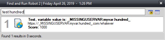

And here's where the problem that appears:the Alias does not seem to resolve the variable name (uservar.myvar.$$1) properly. When I try to use the alias from the launcher I get this error message of sorts:
Fig4. Using the regex'd Alias
My question being.... why is this not working!?!?!?!?!?
I am pretty sure that I know what the problem is in here: most likely, the Alias parser is looking for actual variable uservar.myvar.$$1, with the dollar symbols and all, which of course does not exist. But then comes the UI print function, which does indeed resolve the $$1 into "hundred" and thus spits the error message we see in Figure 4:
Code
MISSINGUSERVAR:myvar.hundred
I'm gonna guess that I'm asking too deep of a question, but I'll cross my fingers and hope for an available quick fix for this issue. Maybe using 3 dollar symbols instead of 2? Putting it upside down and shaking it?  ;D

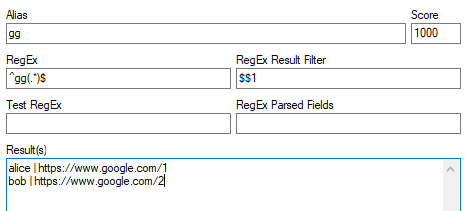

Just to add to mouser's suggestion:
You can use the list approach together with RegEx and RegEx result filter to ensure that only the list items are shown in results, and filtered as you type. Without RegEx unwanted files that contain the keyword string might also show up in the results.
Example of what I mean with RegEx result filter:
With the above you'd type "gg" to get the whole list and nothing else. Then keep typing to filter the list.
