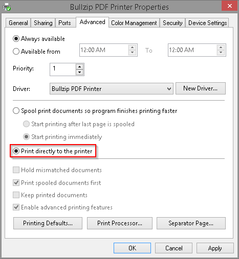

First turn off Print Spooling in the Printer Properties:
This is so a job finishes before the next is sent (was the easiest way to do it)

Also, would it be possible that the code sends only one file to be printed ?  Then it is printed by Bullzip. Then once bullzip has finished, the code sends another file to be printed ?
Disabling the Print Spooler will stop SumatraPDF from just queuing up the print jobs, it has to wait until each job is finished before it can exit and run again.
