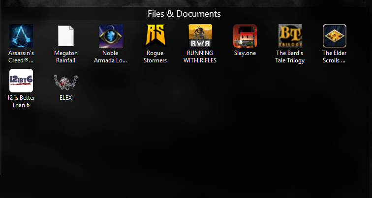

So you mean that when a folder is opened with icon chosen as display type, you want to freeze the positions of those icons?  Have you tried Stardock Fences?  I know it displays custom folders on your desktop and they retain the positions of the icons.  I don't know if you're going to close and open them individually if it will work for your purposes.
https://www.stardock.com/products/fences/
As far as the request itself, the problem is that Icon mode in Explorer (rather than the desktop) is only pseudo icon mode, i.e. it doesn't support drag and drop positioning like the desktop; it's always ordered in some fashion.
UPDATE: Looking at my installation of Fences, it uses the tile method of showing icons also, i.e. it will only allow you to sort the order, not the position.  Example follows:
Notice that in that image, they're in an arbitrary order that I dragged and dropped them into.  Not sure if that's what you want.

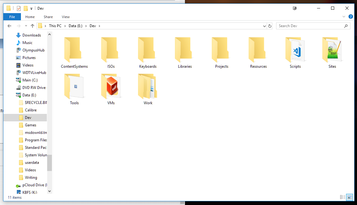

Unfortunately, desktop.ini seems to only contain a few lines, and nothing about icon placement on desktop (or folder).
The idea I'm after, to clarify, is to place icons within folder, exactly where I want them to be placed.  So that when you open that folder the icons are where they are supposed to be, because I strategically placed them there.
Please see above image.  Worth 1000 words.
