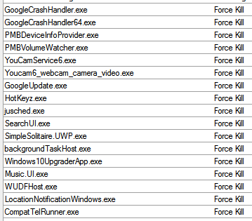

Nothing wrong in that. I use PT as a workaround to combat a problem that Google and Microsoft in particular, and others in general, have created for millions of PC users - the original "PUPs" ("Potentially Unwanted Programs") or "PAPs" ("Persistently Annoying Programs") as I describe them. The list of PAPs includes, for example (from my PT Configuration GUI list):
