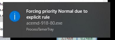

The attachment shows the Windows notification which pops up at the lower left corner after starting the progem acemed.exe - the same notification is shown when I set to "above normal", except that in this case, the Windows Task Manager shows that the process is "below normal".ProcessTamer.JPG

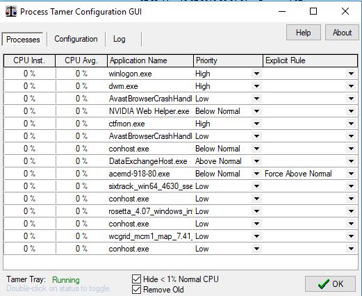

Last night, when a running acemd.exe got finished and a new one startet, the new one stayed "below normal".
The Windows Task Manager as well as the entry in the ProcessTamer GUI shows this - see screenshot attached.Process Tamer.JPG (although the Explicit Rule says "fore above normal".
So, sometime it works, sometime it doens't.  Too bad  :(

Does it seem most likely that what is happening is something else is forcing acemd.exe to low priority AFTER PT forces it above? (possibly itself).

When you set a force rule, PT should try to force that priority on the app when it sees it.. But what I can't remember is whether PT continually monitors the app to see if anything else changes it afterward, or will leave it alone after the first time it changes it.  I suspect that the latter is what's happening in this case.  PT is changing it, and it is changing itself back.

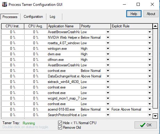

5 Minutes ago, I was lucky and could watch what was happening when acemd.exe was closed because a job got finished, and a new job (and hence acemd.exe) started:
There was the Windows Notification below on the right hand side, saying that Process Tamer is changing the priority of acemd.exe to "above normal" - but when I checked this seconds later, the priority was "below normal".  As shown in the Windows task Manager as well as in the PT GUI - see here:
so something is going wrong  :(

What's probably happening is acemd.exe is changing its own priority to below normal soon after it starts a new job.
And PT is only trying to change it once.
I can fix that -- I can make PT try multiple times.
