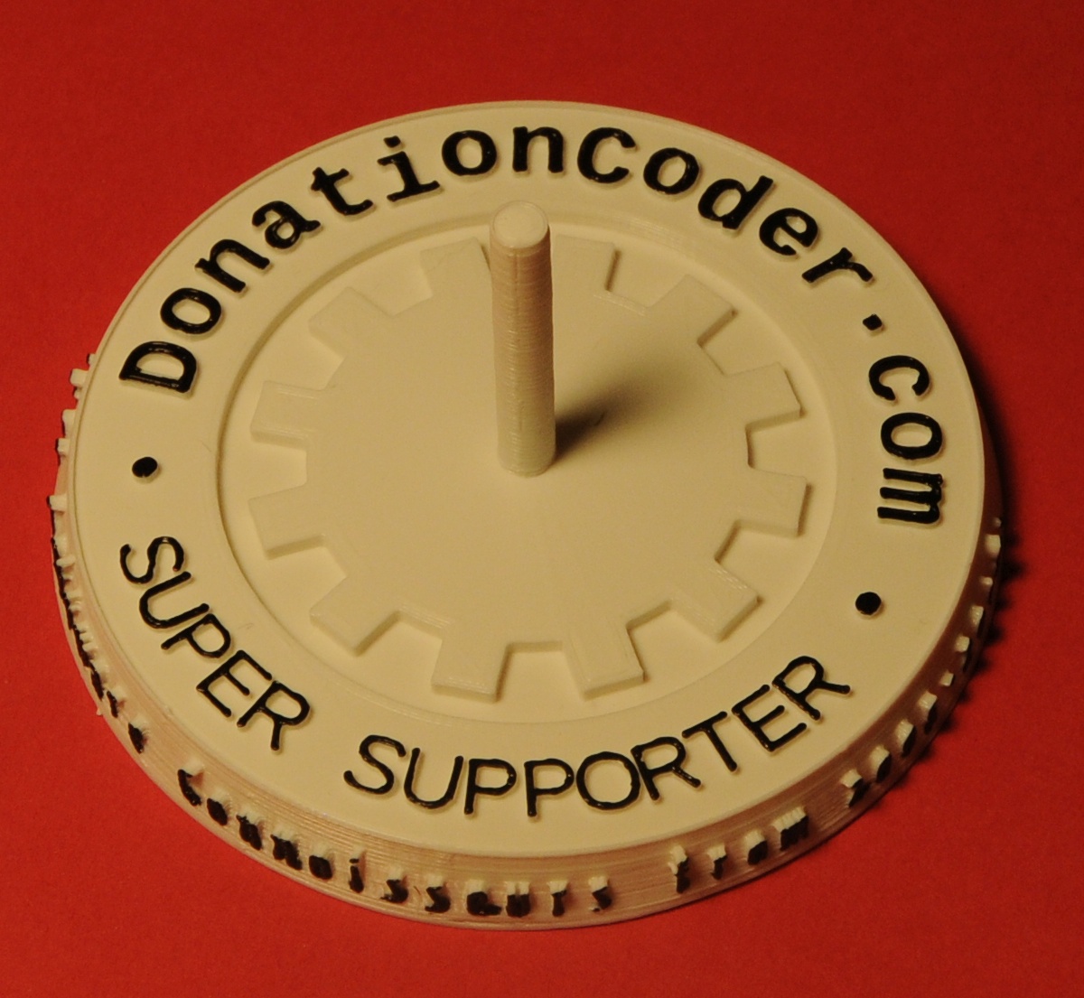

« Reply #52 on: March 30, 2018, 11:28 AM »
mouser,
The nice thing is everything you suggest (mostly) is really easy. Comment out the cody, change the height of the column, etc.
I haven't tried it but I think OpenSCAD can import an stl - you may be able to do this in one print.
I changed the font in the latest version, from Arial Black to Liberation Mono (DC.com) and Liberation Sans (other text).
I normally go through and fix indenting and comment things before I do this :) but here's the source - I included the font needed for the edge; fonts for the top will need to be on your system (OpenSCAD has a font list under the help menu to be sure).
When you're using OpenSCAD it shows a "preview" but to print it you need to do a "render" (F6 or a toolbar button) which is pretty slow with the fonts. Then you can export an STL.
Helpful tip for OpenSCAD, if you put a "#" at the beginning of a line or object then it's highlighted in red, so you can see what you're editing.

Re: Thread on 3d Printing Cody Model
« Reply #54 on: March 30, 2018, 11:51 AM »
I think I will need your help making the "rod".
You can do it! Look at the bottom of the file; I've commented out a cylinder "//simple platform for Cody".
Code
translate([0,0,2]){cylinder (r=20,h=3,center=true);}
First change r and h - note that the height expands from the middle so it sticks out the bottom.
Code
translate([0,0,2]){cylinder (r=2,h=30,center=true);}
Then change the "z" value in the translate function to slide it upward. You can move it up by half the height, plus half the thickness of the cylinder. Overlap is OK.
Code
translate([0,0,17]){cylinder (r=2,h=30,center=true);}
« Reply #56 on: March 30, 2018, 12:12 PM »
Here, use this one instead. I got rid of all the "center=true" so things grow "up" instead of "out". Should make dimensions easier to play with.

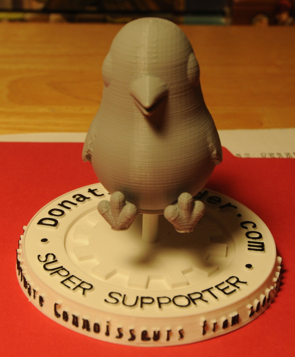

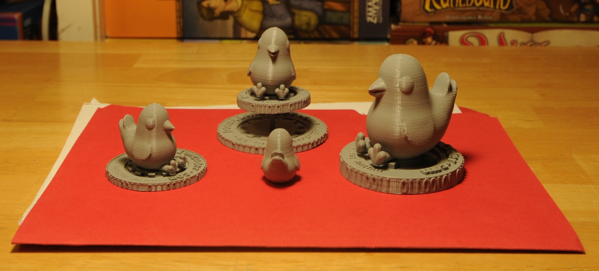

Heralding a new arrival:
I have to say that the idea of a rod and perching cody above it did not work as well as I had hoped -- he looked a little strange sitting on a pole so I had to put him on a second tier.  Probably more trouble than it's worth, as the look of him just sitting on the coin base still seems best to me.

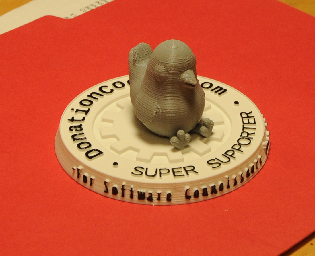

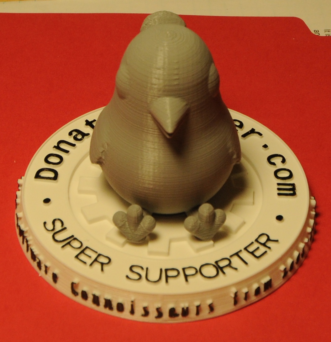

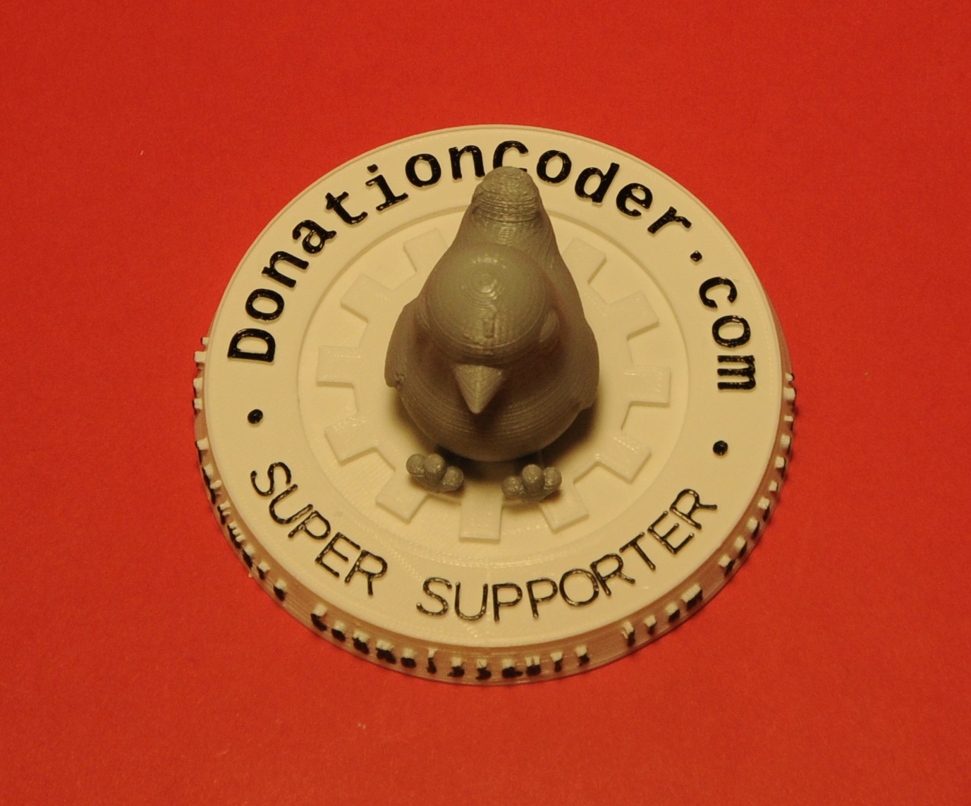

« Reply #68 on: April 01, 2018, 09:37 PM »
Big white coin/pedestal with simple painted letters:
And sitting directly on coin:
And with a smaller cody:

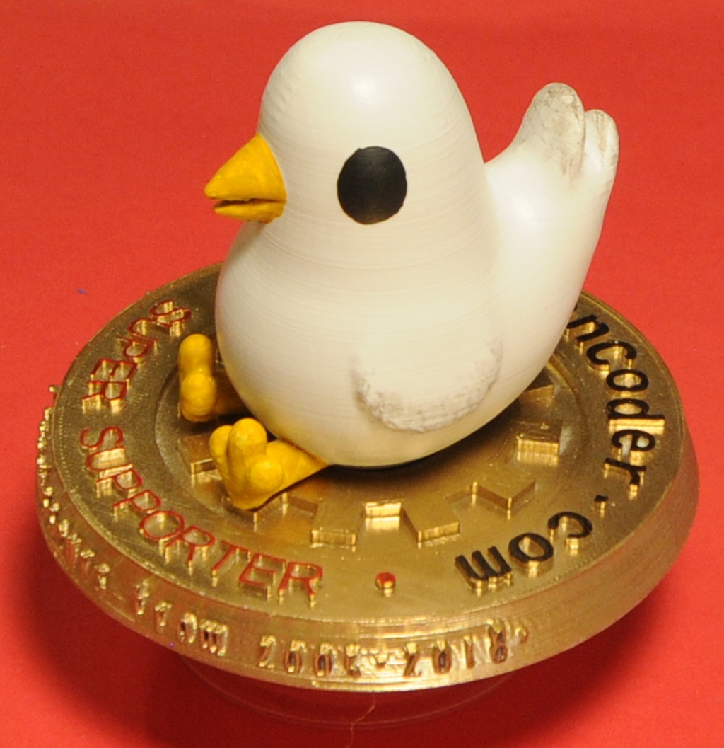

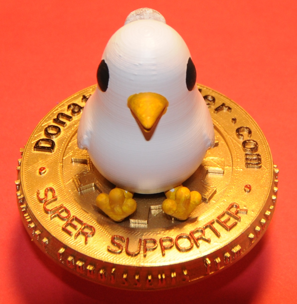

Painted up and ready to go:
[attachthumb]
« Reply #70 on: April 04, 2018, 07:16 PM »
These aren't too laborious to produce.. Some spray paint, oil marker, and hand painting the beak, feet, and eyes.
I'll try some more sizes for cody and the coin...
Text on coin face and around the rim are customizeable.
So, it seems to me I could make a couple dozen of these with custom text and send them out to special folks.
